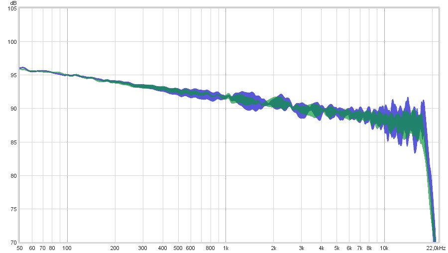

I'm constantly posting my progression in two threads, maybe I'll just post here, as nc535 is busy finding the right values for his array featuring different drivers (even in size).

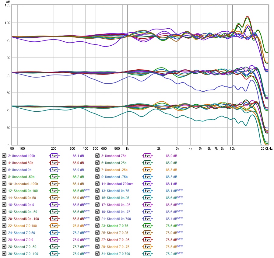

I was looking for an upgrade of standing performance, hoping I'd get it without any big compromises. I think I've managed to achieve it:
Top - Unshaded (as seen before)
Middle - Shaded 6.0 (seen previously, using shelf shading + top end compensation)
Bottom - Shaded 7.0 (new variation with the task of better standing, 1.7 meter, performance)

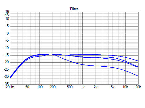

I've tried many things, in the end it was quite simple. I just had to learn about passive compensation filters like notches etc. Here's the schematic:

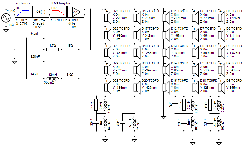

All it took was an extra cap and a slight change in component values. I may yet find ways towards further improvements. But most of it is within plus/minus 1 dB from 900 cm to 1100 cm.
The difference in the 5 KHz dip is almost 1.5 dB in favor of this last schematic. Not bad for a passively filtered frequency dependent solution I'd say.
It is getting closer and closer to an 'upgrade solution' without many drawbacks. Let's see if i can find even more subtle improvements.
I'll post the Vituixcad 6-pack, however there's almost no difference to version 6.0 unless you're pixel peeping:
(aside from the extra split in processing groups)

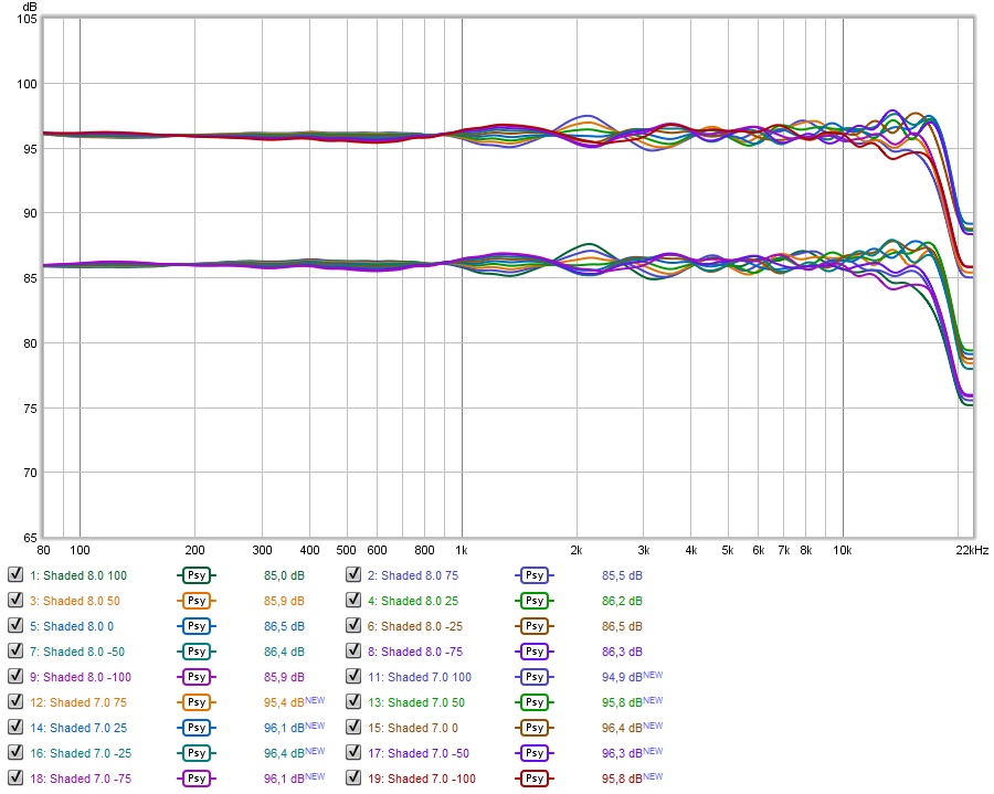

I'm still throwing out sims like crazy. How much is good enough? I'm approaching plus/minus 2 dB variation all the way up to 10 KHz (unsmoothed).
Side note: there is absorption on floor and ceiling, as those become the biggest sources of combing. Same value used for all these and previous sims.
The last improvements let go of some of the standing ideal... Less than one dB drop on the upper end though. Almost a steady decline along the whole graph.
Let's look at the 20 cm 'vertical window' results when filtered:
Looking at it like that almost makes it fit a plus/minus 1 dB window.

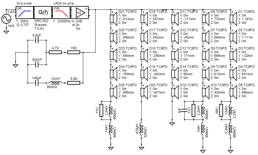

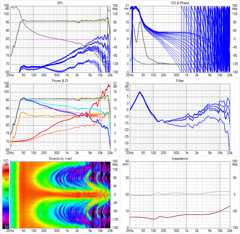

New schematic:

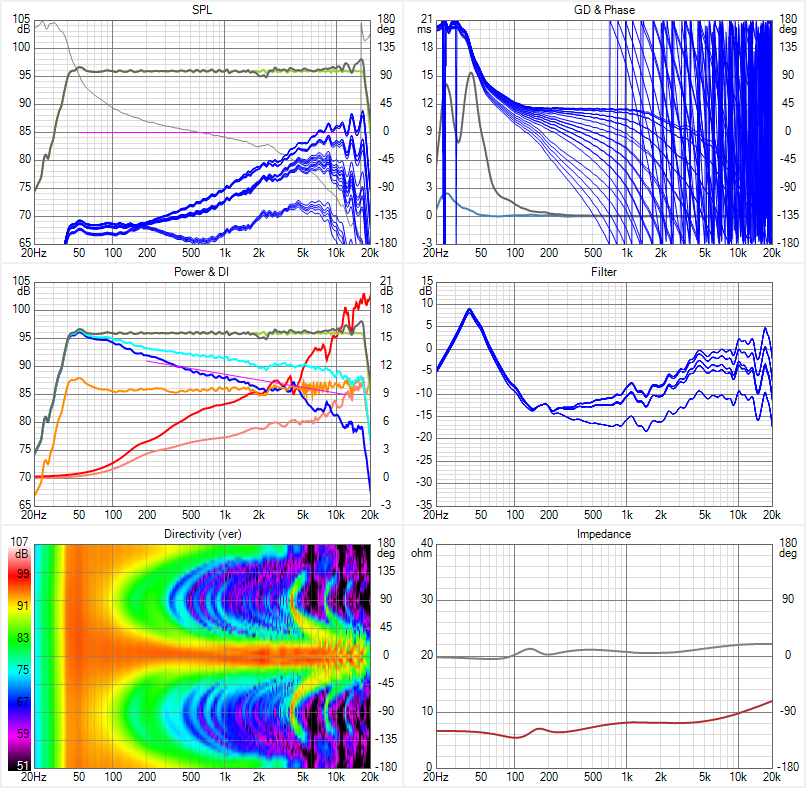

And related 6-pack:

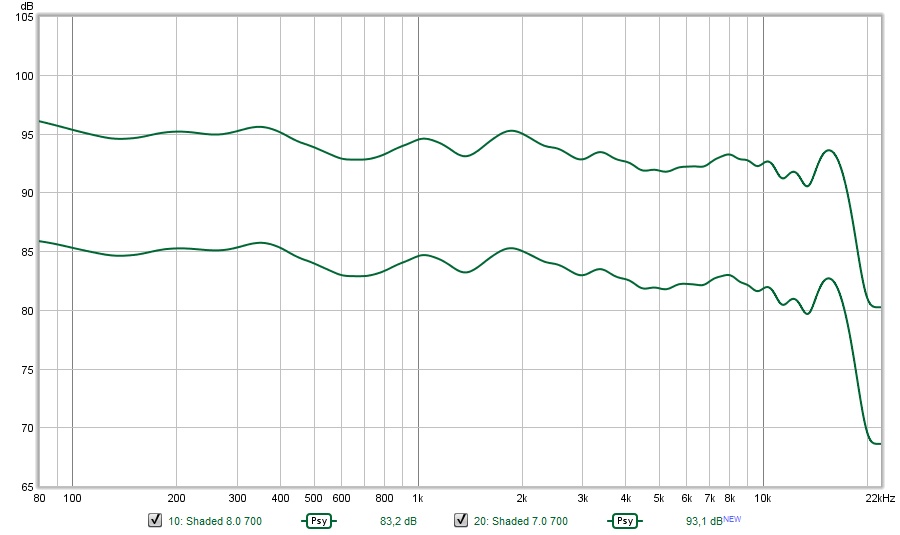

The difference in filter 7.0 vs 8.0:
Now if only I could figure out what I need to do to make the 1 Khz to 4 KHz a little more balanced. I did try a few things, but no bingo yet. The horizontal pattern shows a narrowing there so that might be related. It might even behave differently with my back mounted drivers.
It is performing better than the unshaded array though. So it's only the challenge that counts. 🙂
Anyone any ideas of things to try to achieve this?

New schematic:

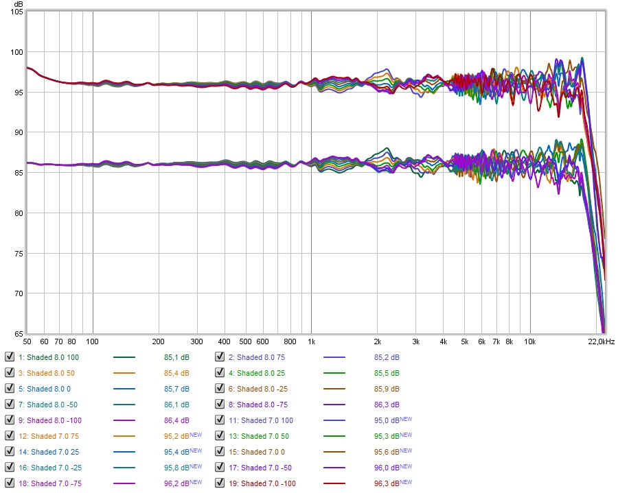

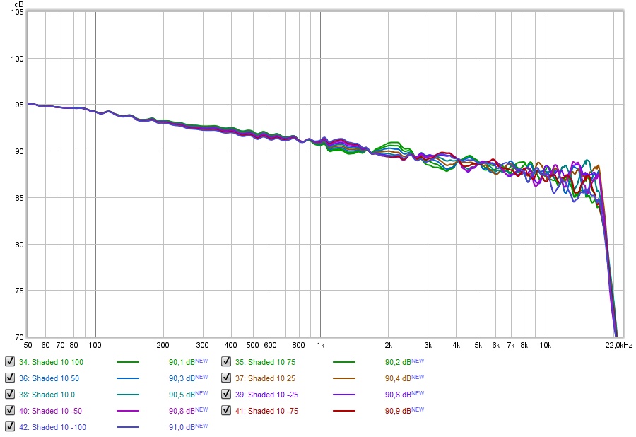

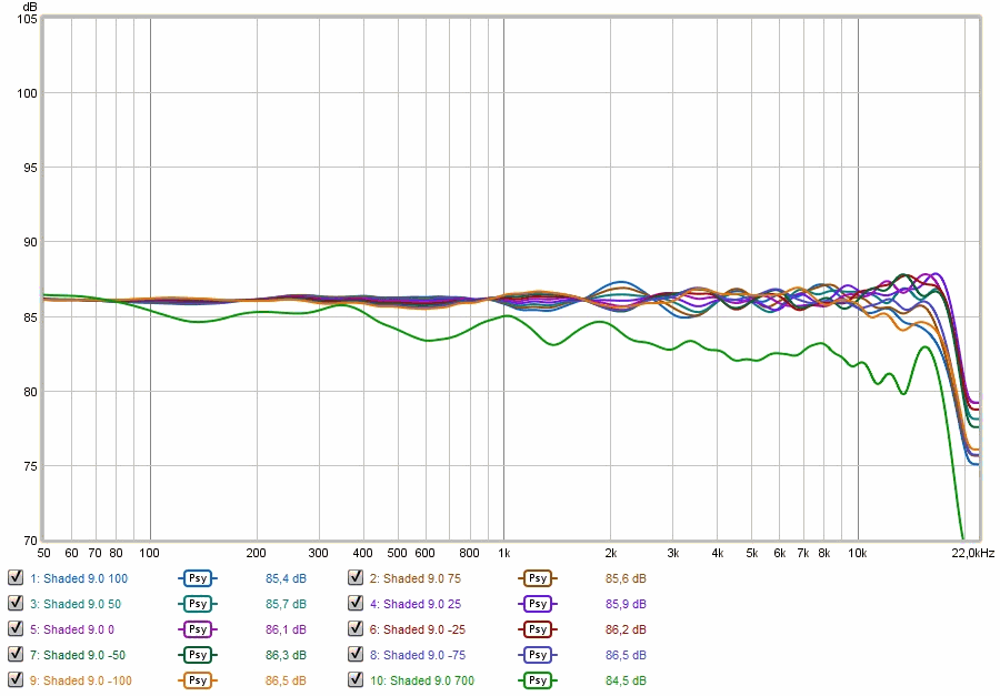

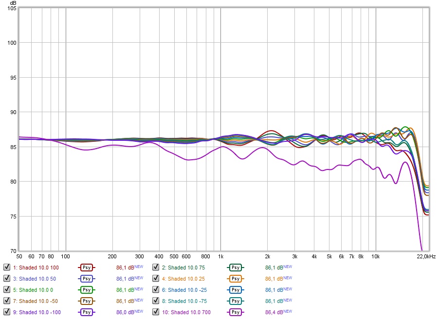

I couldn't stop simming completely, here's version 10 of the frequency shaded array:
And to look at the results before the floor and ceiling were added:
This last results is based on the raw in-room measurements, EQ-ed to make the average flat (declining 1 dB per octave)
Once I have more time, i'll see what that does for the unshaded array. Just to see if the shaded array is less sensitive to room influence. My hunch is the unshaded array needs some room to look good (after applying a psycoacoustic filter).
The above result does look promising to me...

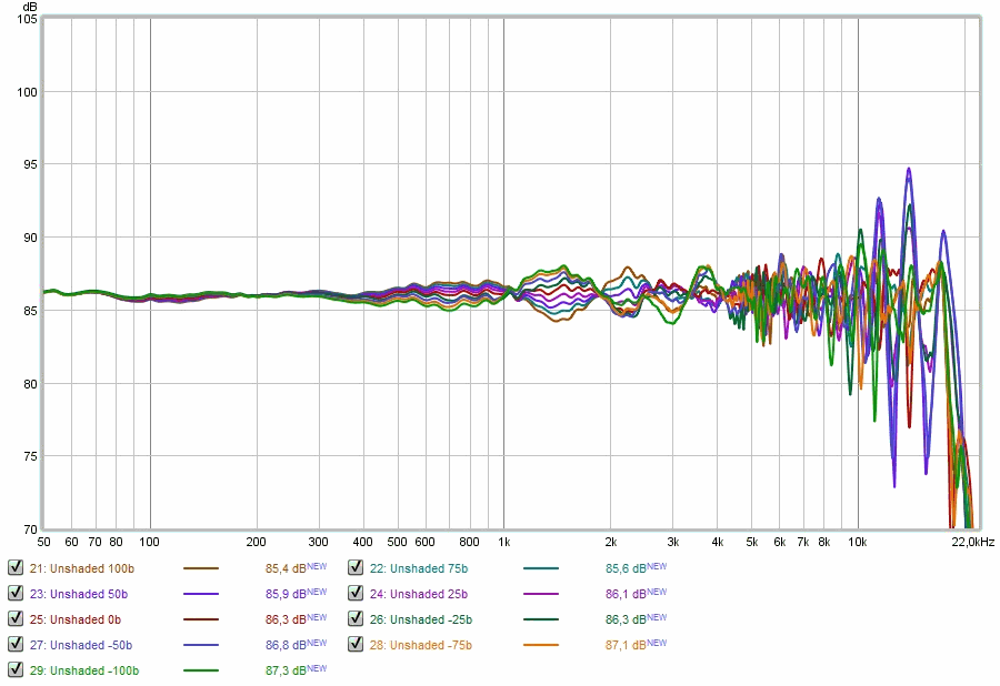

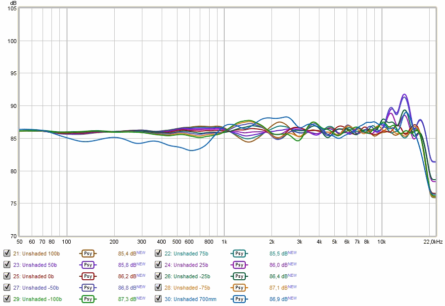

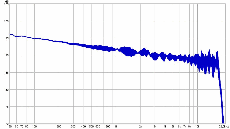

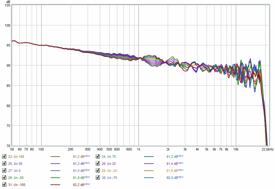

Next up, raw in-room of the unshaded array:
That looks pretty good, I have to say. That might explain why it can sound pretty good too 😉.
A new comparison between the two:
Clearly there is potential in the shading. There is improvement over the complete frequency response, the least amount of improvement between 1 and 4 K*. Top end and overall, I'd say shading wins a lot of points.
* = I already tried to win something there, it isn't that easy. It isn't bad either, but I was hoping to get it in line with the higher regions.
Is it enough to warrant the expense and troubles of an array operation? Pretty hard to answer, but i think so. Little things can go a long way...
