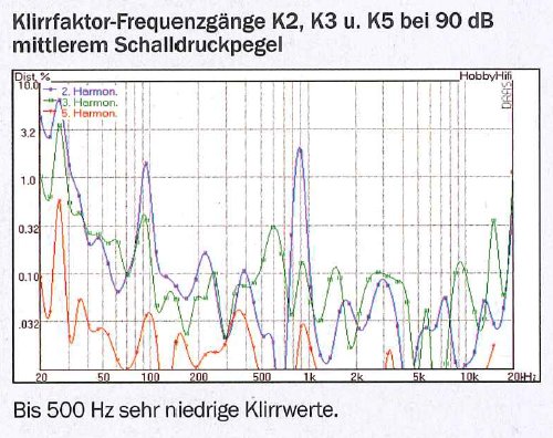

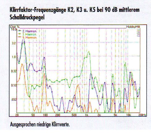

As nobody seemed to really look at the reviews i posted about the 30W and 32W, the most striking thing I saw in that review was this;
Distortion levels at 90 dB SPL of the 30W:
Distortion levels at 90 dB SPL of the 32W:
While the 3rd harmonics are cleaned up quite a bit on the 32W (that's what creates that crazy peak at 3 KHz in the FR plots of the 30W) I did not expect the 30W to be this close to it's bigger younger brother. Up til 200 Hz, and enough beyond that to properly roll it of, it looks very usable for my purpose.
P.S. I even liked the waterfall plots and STEP better on the 30W.

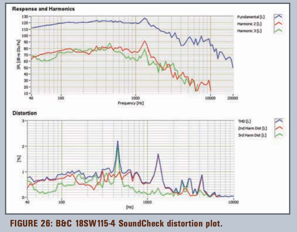

B&C also quotes the Xvar parameter which is interesting to compare across their drivers and consider that in light of other manufacturers xmax figures which can vary from conservative to ridiculous.
This is their explanation
"These limits are customarily indicated by Xmax, the maximum linear excursion. This value is typically measured according to the AES2-1984 standard, corresponding to a maximum of 10% total harmonic distortion (THD) with a sinusoidal signal (though most manufacturers, including B&C, now typically provide data for Linear Mathematical Xmax, not measured Xmax). Recent research shows that this method can yield ambiguous results, and even different numerical values for the same loudspeaker. The main limit of this measurement is that it looks at the output signal instead of the physical features of the driver itself. On the contrary, the most up-to-date instruments for distortion analysis can measure the variations in loudspeaker parameters when they are fed with high-level signals. In this way, an excursion limit can be fixed, beyond which the parameter’s variation becomes excessive.
The “X var” value reported in our data (generally after the traditional “Xmax” value) is measured this way. Beyond this excursion limit, the magnetic field seen by the voice coil, or the total suspension compliance, or both, drops to less than 50% of their small signal value, producing high distortion levels, strong variations from small signal behavior and power compression. The new technique yields different results from the standard measurement based on THD. B&C Speakers believes that this added information gives a more accurate and reliable description on loudspeakers behavior in actual operating conditions."

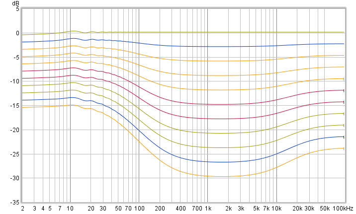

To improve enjoyment for background music levels have you ever try turn on the equal loudness curve in JRiver and calibrated it, works fantastic for lower lewels if you ask me 🙂 below is 96kHz loopback of Jriver when loudness is turned on lowering volume in steps of -3dB so that upper curve is about 86dB at listening position and lower curve is -30dB below that.

To improve enjoyment for background music levels have you ever try turn on the equal loudness curve in JRiver and calibrated it, works fantastic for lower levels if you ask me 🙂 below is 96kHz loopback of Jriver when loudness is turned on lowering volume in steps of -3dB so that upper curve is about 86dB at listening position and lower curve is -30dB below that.
Yes I have used that and it does work. However even at lower volumes the arrays attract a lot of attention to themselves, are distracting as a mere fill in, hard to explain. It's like having a band play continuously at low levels, you keep focussing on that. They pull the attention away from whatever you're doing, be it a conversation etc.
