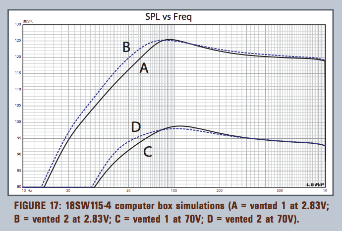

Well, it is disappointing to see them do a driver test and show 2.83 volt and 33 volt.
...in a simmulation...
I'd rather see measurements, not simulations.
Especially if one wants to make a point about driver linearity at different SPL levels, how is that possible without actual measurements.
How are we going to pick out a good driver if we can't see how it holds up under power.

Power compression, that woofer is being driven well beyond what it is capable of at 33V, xmax +15%.Anyone.... what is is that can be the root cause of that 36Hz peak at 110dB
That isn't the root cause of what you are looking at.Thx, not yet .... gonna read tomorrow and try to get through all constructive input

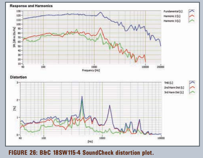

The simulation by itself tells very little but it can be useful in comparing drivers across their reviews.
What is much more useful is the klippel plots, that is what a good manufacturer uses to check the design of their speakers, and refine accordingly. The distortion plots in the article can also be quite telling as they are usually at a high level. This is the best way to look at how linear a woofer really is.
This is one of the best looking driver I have seen in terms of Klippel measurements, and you can see that there is hardly any difference between between the plots at 2.83v and 70V B&C18SW115, compare that the klippel in the previous article.

That is where it is good to look at the klippel data. Most drivers are limited by their compliance more so than their excursion. That is also what is shown in those voltage simulations before. The B&C is very linear throughout it's entire travel, most hifi drivers are not, so you can't really compare xmax as a figure without considering the rest of the driver. For volume displacement purposes it works but it tells you nothing about how linear that volume will be displaced. Linear excursion on a spec sheet is very misleading as most of it will be anything but linear as the klippel will show.The Scan Speak has 12.5 mm x-max, the B&C 14 mm, which one will move more air (or need less cone movement)?
