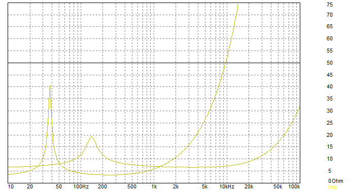

A week ago I was at my friend's place listening and measuring AE 18" IBHT subwoofer, Mms 250g IB18HT - Home Theater Infinite Baffle Woofer - Subwoofer
Nearfield response was flat 20-1500Hz! It sounded nice and clean without xo, powered by 1200W ICEpower module.
That is what the 30W can do also (break up not until ~ 3 kHz):

Think the speed problem is the relative difference in inductance data L(e) per band pass, so say woofer and tweeter band had same L(e) data the problem wasn't there or we can set XO point for woofer a tad low enough before its inductance start the climbing on the graph, low L(e) is one reason JoeRasmussen in his Helsinore build use those 7 inch SBA woofers to integrate with his tweeters because their L(e) is as low as 0,13mH.
L(e) is a distortion the higher the frq the bigger the time delay, but not shure our hearing can reconize the short time distortion listening to say one transducer at a time, but when summing two drivers with different L(e) harmonics as frq goes up can get out of timing no matter time sum is perfect in the low end so get it crossed below that point, most often transducers with advanced motors have improved L(e) numbers probably to help integrate with tweeters.
Think not wesayso should get any L(e) coursed speed problems as seen below : )

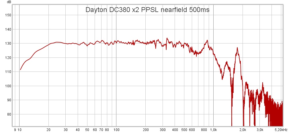

I have 2x15" Dayton DC380 drivers in a a slot loaded HT subwoofer and I remember I was amazed how they played fullrage when testing... 18" Ultimax should be ok as hifi woofer too, crossed below 500Hz. I bet they are easy to sell if you get disappointed. I think I have heard some postive comments of JBL M2 which has a single 15" woofer crossed around 1kHz to a horn, no complaints of sloppy or slow bass...

I was a bit curious, but at 665 gram mms this sure isn't a low cone weight .
None of the Dayton subs seem to fall into that category.
There certainly is an advantage of using multiple drivers like your plan. But you've got to trust in such a project to bite that bullet.
Lots of people were telling me the arrays weren't going to work. More so on another forum I posted than over here, probably because I wasn't the first here to do so. However I had faith in it and some emergency backup plans to still make it work if i were disappointed somehow.
I think you can build the sub you want. Take your time to research possible drivers. Run some sims and draw up a model (or just some paper sketches still work for that). Sim it to see where you end up with fixed boundaries like x-max limited SPL levels (if we can trust the specs). Figure out a good amp to feed them etc.
