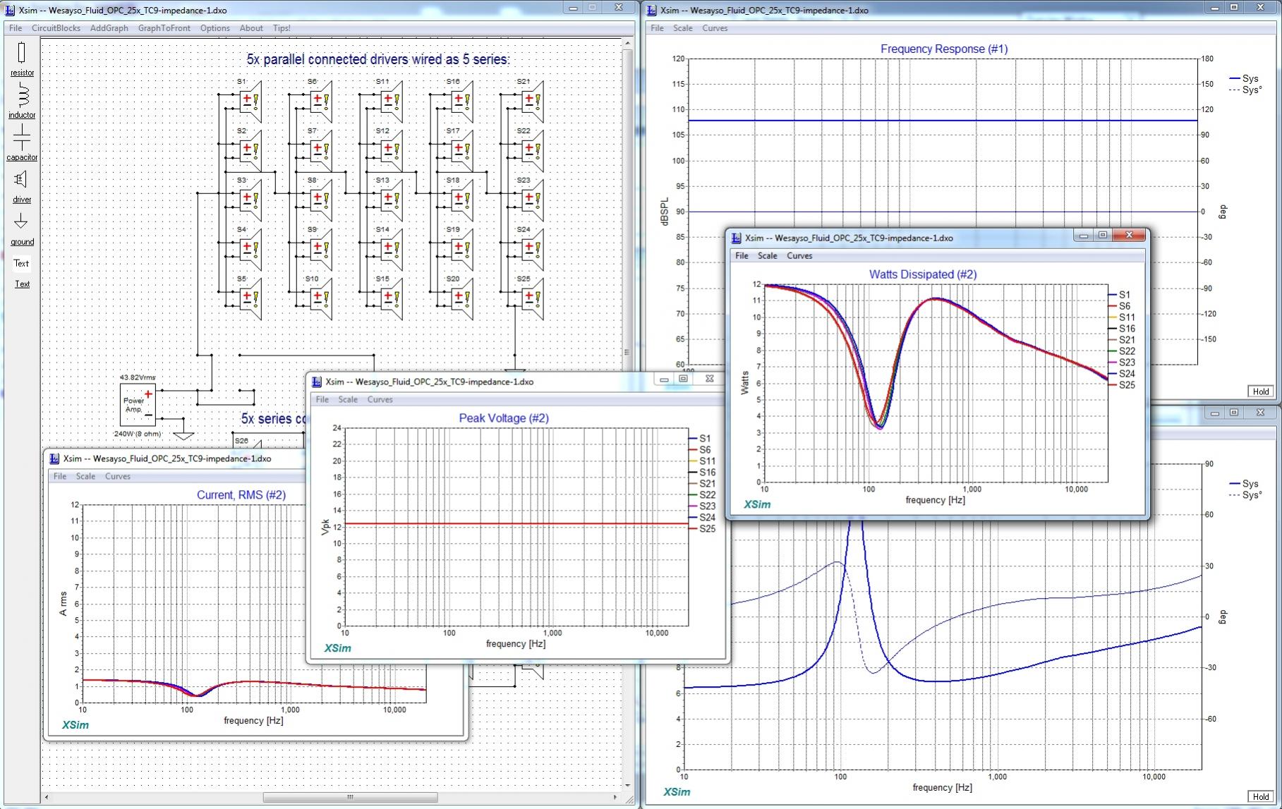

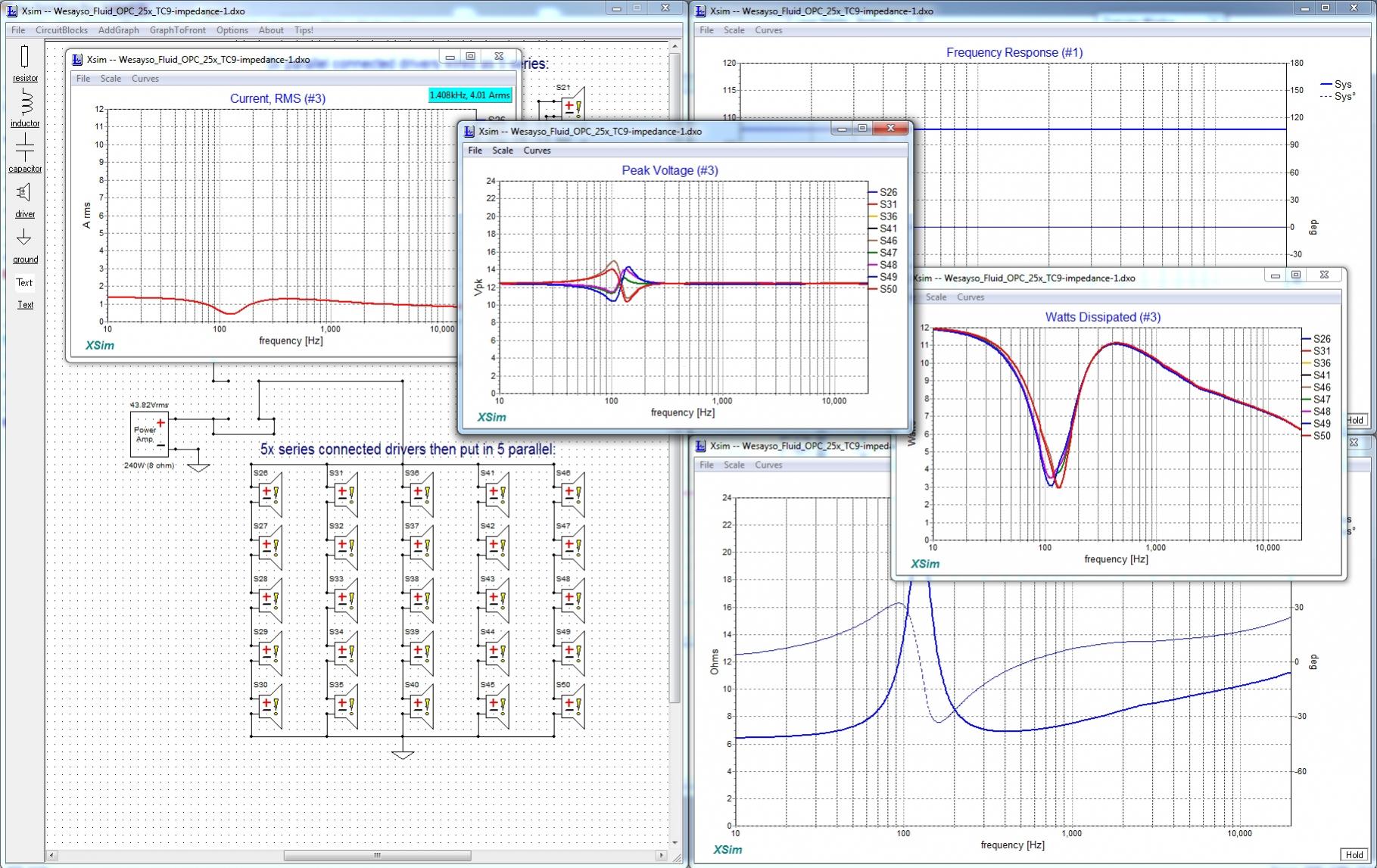

Warning, huge pics!
I've probably posted this before, I can't remember(*). But to raise my faith in our universe, and outline my reason to favor parallel-series wiring once again plots that "should" be right.
(*)= seeing these plots makes me remember I posted exactly that in Fluid's thread. So I really should have remembered and had done the sims before comparing both schemes at a 240 watt load.
First series-parallel (it's what I have):
Versus parallel series (which I still believe to have a slight advantage around the impedance peak, for those that run the arrays full range):
See the differences? This is why I'd still favor parallel series. Both these graphs are with 240 watt(!) to outline the differences.
Series parallel seems to made a difference in voltage swings while parallel series has that effect on current. These drivers (at least the 5 in the bottom of the plots) are based on actual measured impedance curves of the separate drivers to outline these differences. In an enclosure they'd be acting a little different though.
My brain fart earlier on was due to something Mark100 said. If you raise the SLP level by 6 dB, each driver gets to see that 6 dB. While I figured the load would be divided by all drivers. Of course Mark is absolutely right, but a 6 dB raise gets the driver from a next to nothing load to an almost next to nothing load, which is what I was getting at. The drivers do share the load, however throughout most of their frequency range, they hardly do anything at normal listening levels. The bottom EQ to get them to play bass does add up fast though. As I've said before, I raise those levels by about 14 to 16 dB max with EQ, the room fills in the rest. That still doesn't mean that it can sustain a 0 dB peak at 20 Hz, it simply can't. But it does play satisfying bass as found in most music. With a bit of work there's a clear absence of room modes overpowering the bass region. This stays pretty flat throughout the room, spread evenly. It took some work to balance it, and I'll have to redo everything once I add the subs.
Am I right into thinking my impedance peak compensation network does nothing to the driver loads of the above graphs? It merely changes the load at the amplifier? (burning up the added power in the added passive components?)

This is a little flip but it does make my point: I look at both sets of graphs and I see the identical frequency responses so what difference does it make?
Witness also past posted distortion curves and the fact that no drivers have burned out. Surely not worth the effort to rewire when you could instead be inventing more DSP magic.
Were it not for that, I would pose the question as to whether there would be a different answer if random (or actual) variation of driver parameters were simulated. But I 'm really just teasing. I agree with Mark - series parallel vs parallel series should give same results. If they differ if the last decimal place it really doesn't matter. Flatness of impedance isn't much of a concern with active equalization.
I think its sufficient to limit the low end EQ based on measured distortion. If (after bringing in subs) you limit low end distortion in the array on peaks to a few percent that is all you need to do - sound quality is assured and the drivers are protected. Watch out and for that teenage son though.

I'm simply not as sure as you are. Combined impedance plots can show faint dip/peaks with series/parallel that don't happen as soon with parallel/series. Often only around the impedance peak. These peaks/dips could lead to FR disturbance.This is a little flip but it does make my point: I look at both sets of graphs and I see the identical frequency responses so what difference does it make?
