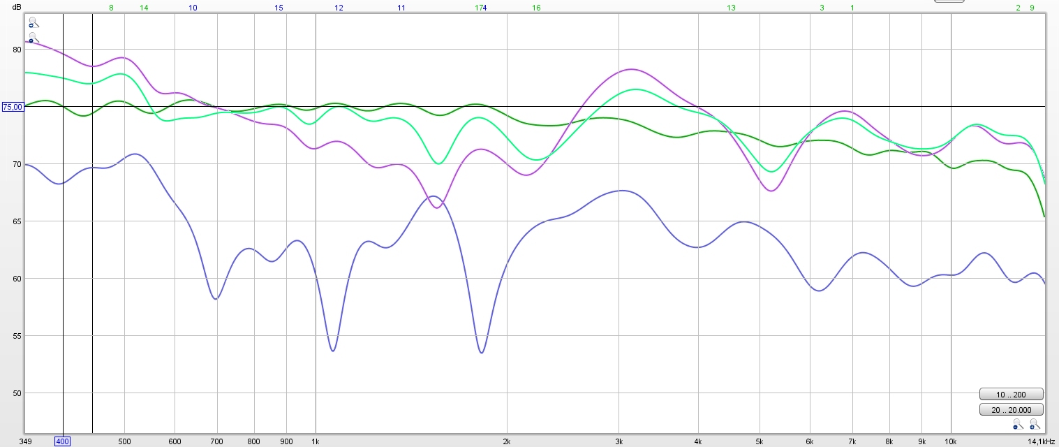

Tested the theory today, this is a path to follow for the coming time... 🙂
I replaced all mid/side EQ with an anti cross talk signal.

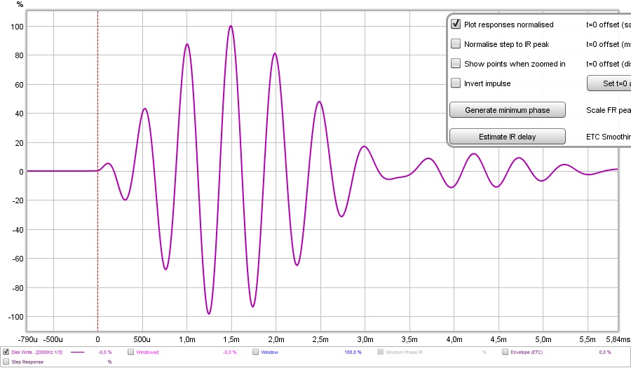

Let me explain the 'tongue in cheek' remark I made in my last post... the "race" to the finish...
In the cross talk I experience at the sweet spot in my ~30 degree stereo setup, the biggest dip is going to be somewhere around 1850 Hz. I've mentioned that a couple of times. I measured the path lengths with simple strings and also tried to find it with delayed signals. This 1850 Hz dip relates to the right ear getting the left signal about 0.272 ms after the right main wave front or pulse. And vice versa.
That was what that negative pulse I use at 0.272 ms was all about. However, if we look at the length of a signal at 1850 Hz, we notice that it takes about ~0.54 ms at that wavelength to complete a full cycle.
So the wrap around wave that travels from the left speaker into the right ear is half a wavelength behind the wave front arriving at that same ear from the right speaker. That's the cause of that dip, obviously. 😉
However, a tone that's playing at that frequency usually consists of more than one cycle. So while the left and right both are playing the tone, we get that dip consistently at both our ears when listening in the exact sweet spot.
To tune my speakers, I use about a 4 cycle length of correction in the midrange. This is because when looking at a wave shape as measured in REW, it takes about that long for the signal to reach it's maximum output. That isn't to say each tone we hear is going to take that long though...
Here's a look at the wave shape filtered at 1/3 at 2000 Hz:
Here you can see that at about the 4th cycle we reach the maximum level.
A true wave shape in a song could be either shorter or longer, however in my DRC experiments, that 4 cycle frequency dependent window is just long enough to give an effective correction, while being short enough to be "out of there" before the room takes over. Put in another way, an effective correction can be based on this length of window.
Anyway, if you have one corrective anti cross talk dip, it is only going to cure that cross talk dip partially. That negative spike is going to be heard by the other ear too!
There in lies the basics of the "Race" algorithm's used in Ambiophonics.

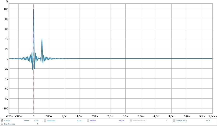

Basically, we use a dip at about 0.27 ms that tries to block the sound coming from the opposite speaker. Next we get a slightly lower in SPL positive spike at 0.54 ms, (remember the wavelength at 1850 Hz being 0.54 ms in length?) that counter act's the negative first spike, as that too, will travel to the other ear, after first blocking the sound from the opposite speaker. Repeated enough times, it will be so low in SPL, it won't be heard anymore.

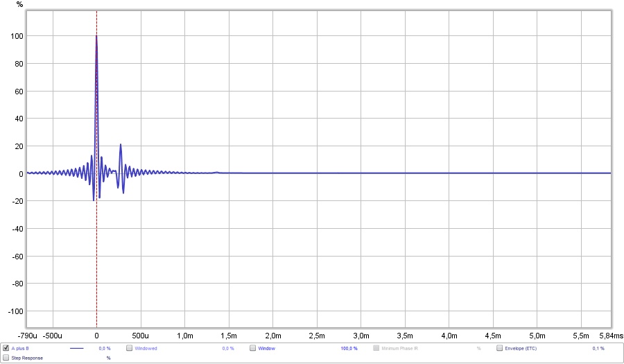

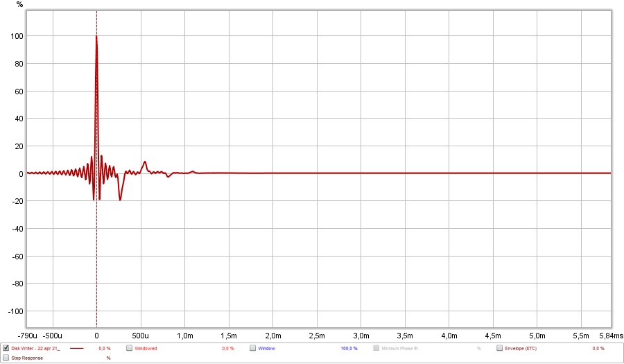

That's a mouth full, let's see it in pictures:
Here's the main pulse (this picture is made with an ideal Dirac pulse as a start signal) and the cross talk cancelation dips and peaks:
What we see here is that "race" algorithm, with 4 consecutive dips/peaks

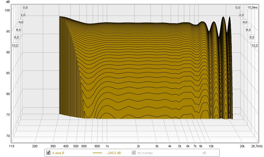

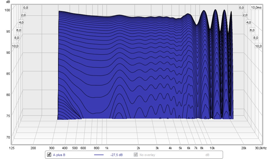

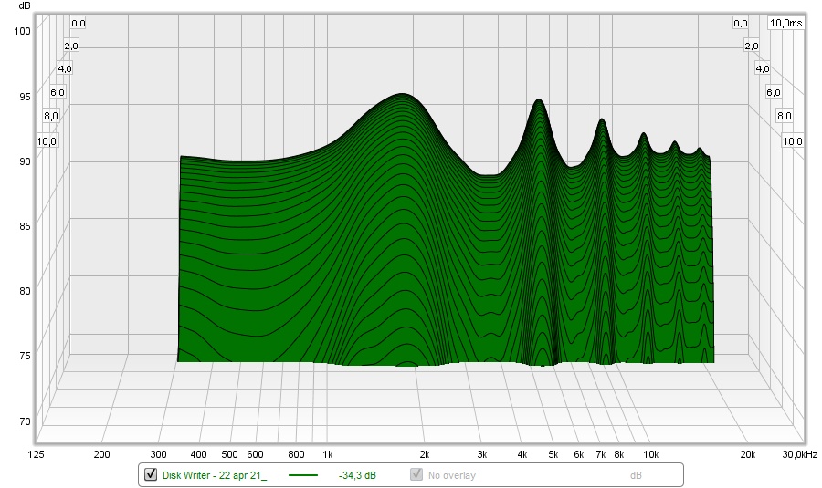

If we look at that signal in a waterfall plot, it looks like this:
See how the signal at 1850 Hz is much wider than at ~3.7 Hz? That is the result of that "Race" of dips and peaks. It also EQ's the output, making the counter wiggles that eliminate the dips we normally hear in the exact sweet spot. That shape actually looks a lot like the mid/side EQ I was applying to my speakers. This widening and narrowing in a waterfall plot I had first seen in the plots from the phase shuffler. That made me go: what's happening here? It wasn't what I was expecting to see.
Now if we look at what happens at the ear, by summing the two signals at one ear, one main signal, as coming from the speaker on that ear's side, and the other, somewhat reduced in level because of head shading and arriving 0.27 ms later, we see this:
The first peak is like always, arriving at full strength, the second peak however (which is the opposite speaker arriving at our ear ~0.27 ms later) is largely diminished by the anti cross talk dip we had in our signal. Effectively lowering the output at our ear from the opposite side speaker.
If we look at how it sums at our ear in a waterfall plot, it starts to look like this:

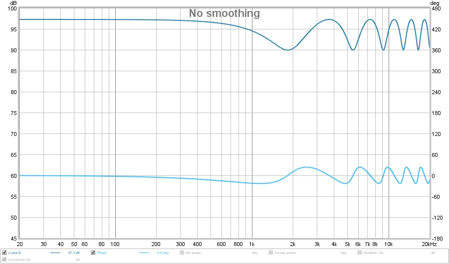

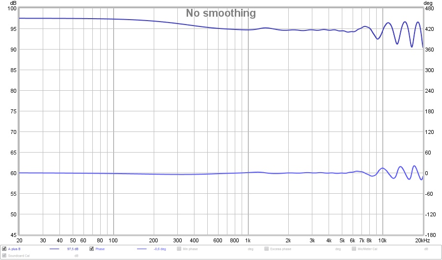

That's actually looking quite good, right? Lets look at phase and frequency:
You can see in these plots I band passed my anti cross talk, as there's still wiggles showing up above ~5-6 KHz. As we go up in frequency, wave lengths become smaller and smaller, so small, even a slight movement of the head would mean we get totally different summing at those frequencies. Couple that with the fact that our head will shade way more of those higher frequencies anyway.
But it's looking quite different from the usual cross talk signal we get at our ear(s). For a reminder, let's look at how those plots look, if we account for about an 8 dB drop(*) in SPL due to head shading...

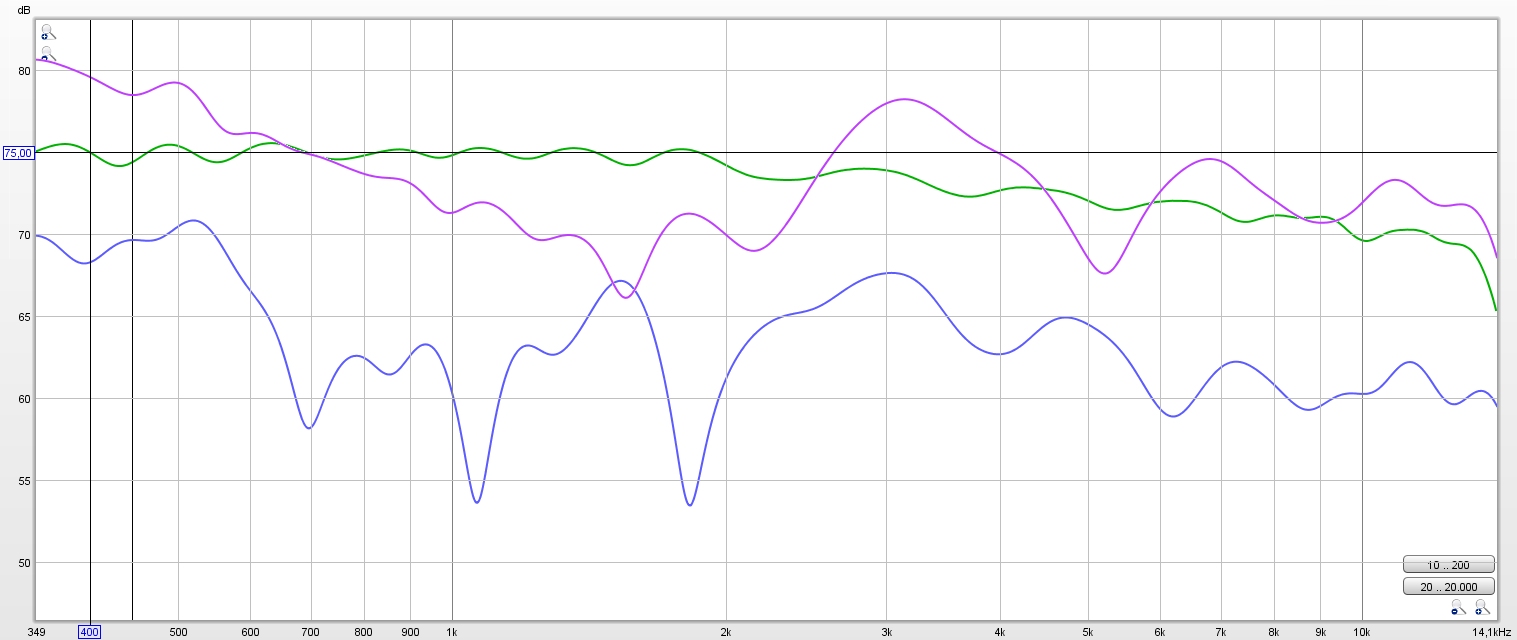

First the IR:
See how the second peak is about 20% higher than in our "anti cross talk" plot?

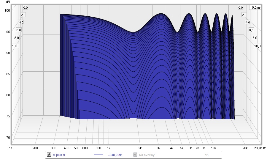

The waterfall plot, remember that both ears would get to hear this for all phantom sounds:
And the frequency/phase plot:
See how both phase and frequency are all messed up compared to the earlier graph?

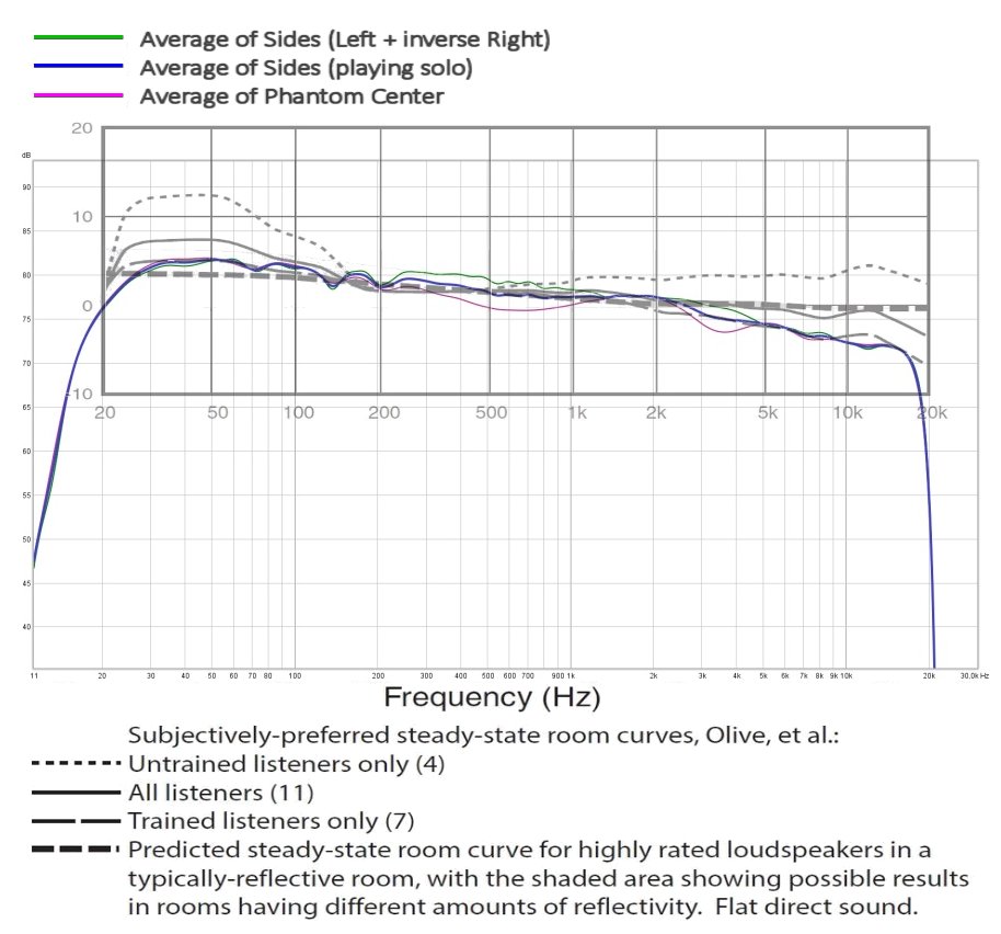

The hardest part is finding out what "our" head shading does. It is clear it is more effective at higher frequencies. At ultra low frequencies the wave will be so large, our head will hardly block anything at all. So that's the next hurdle to take, adjusting the band passed signal to best suit the situation.
(*) This 8 dB of shading I used in the above example was arrived at by looking at the picture as presented by Toole of the dips caused by cross talk in a normal room. The graphs, posted on this thread by jim1961 showed a similar drop in level. He measured at (or near) ear position, both speakers playing and wrapped something fluffy to fake a head to provide some shading.
So the success of this "anti cross talk" lies in finding the right numbers needed to effectively combat the cross talk itself. The good news is that even though the first plots, those showing those peaks, look horrendous. But they don't sound bad, not even off axis. The head shading will vary with frequency, the trick will be to learn how much shading takes place.

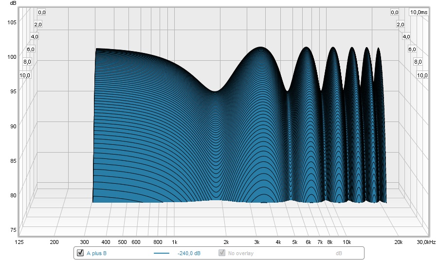

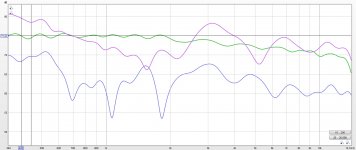

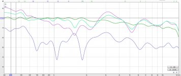

Way too soon to draw any serious conclusions, but I managed to get some measurements of the head shading effect. I'll need way more time to set things up a bit better to get a true view of it.
Time has been in short supply so this will have to do for now:
Traces were somewhat normalized (to main signal) to be able to see the differences and filtered with a 6 cycle frequency dependent window.
I use a foam ball about the size of my head with the mic flush to the outside.
I timed the IR peaks so the opposite speaker peak was about 0.27ms behind.
The green trace is the main sound at the microphone. The blue trace is the opposite speaker playing by itself, measured at the head/ball shaded mic.
The purple trace is both speakers playing as measured at the mic.
The same or at least very similar effects would happen at the other ear.
I'll include the cross talk I was using in this graph to show what it does:
We can see it clearly does something positive, but wasn't strong enough to solve everything. What I did was change the level which seemed most pleasant to me, making my x-talk compensation about 14 dB below main level. Clearly this wasn't enough to get a flat correction, but having it louder did emphasize other frequency anomalies in real life.
What I'm thinking is that I'd need another target too, if the cross talk compensation is used to it's full extend.
I'm going to think this over, trying to determine the next steps. The cross talk compensation does work, but it's also very positional dependent.
You need to get it just right in order for it to shine.
It's quite difficult to determine the exact delay of the cross talk happening at my ears, but it seems to agree with the mid/side EQ I was using.
Due to adding sound, the total balance is different though, from my set room target. I would need to aim for the cross talk compensation balance at the ear, which means many measurements with the foam ball for both ears and a new FIR/EQ to fit. Only then I'd be able to really judge it.
The mid/side tweaks were a lot simpler but did not solve the wide dip at ~1850 Hz. I think it would make sense to go for compensation of that dip and do the rest in mid/side EQ to keep it simpler. The dip just past 5000 Hz isn't wide and would be influenced a lot by little head movements.
I have lived without much draw back with the mid/side EQ. I only noticed more sense of depth, getting some vocals more up front/free when I did try to cure that biggest dip. That has been the reason for another go at this.

I did some further research in REW and RePhase, using an ideal case of Dirac pulses with a head shading of 11 dB on average.
Summing these results in the wavy shape we've seen before. I took that shape and EQ-ed it back to a straight line, using minimum phase EQ. After creating a pulse of that in RePhase, I summed these with again an 11 dB of head shading.
End result: a clear straight line with straight phase.
I stopped EQ-ing just over 10 KHz, as is evident here.
This leads me to the conclusion that I don't need to include a cross talk signal, instead I can just EQ the phantom sum at the ear back to straight (or any desired target, really) and the end result will be very flat in that position.
It would be a lot less intrusive this way, even making it possible to EQ for each ear, though with the note that these measurements were made with a dummy, not my actual head 😉.
Until now I've always used linear phase EQ in my mid/side processing. This little exercise shows that was a mistake.
It also makes me wonder about the true target being used. The B&K curve comes to mind, as well as the Preferred curve from trained listeners at Harmon. I think the curve, without having cross talk in mind, should show a gentle bend. However in listening I always made it bend up at about ~1500 Hz a bit more as I preferred that in listening.
Slowly but surely things fall into place 🙂. Which still means nothing 😀.
