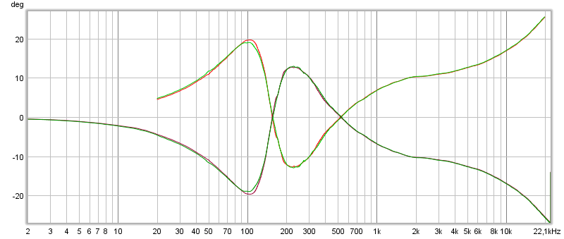

I just checked within REW, a delayed signal (positive on one side, negative on the other) would create a 2 dB max difference between the left and right (on phantom steered sounds) if it's 20 dB down. It creates an alternating wiggle where the left and right channel don't play exactly the same. But also not deviate too much from each other to loose focus. You'd have to factor in the applied mid/side EQ (which actually is about that 2 dB variation in it's current shape. The biggest difference it creates is how the cross talk sums at the ear. It won't be the same signal at both ears anymore as in an idealised Stereo setup. And that, to me, is a good thing.
So it seems to fit, even though it's not much. It is working from about 700 Hz up to 7.5 KHz.

I still run that cross talk, a small positive spike at 0.27 ms in one channel, a negative one in the opposite channel. Applied to the phantom part only, with the left/right part of that signal subtracted again. This to prevent any change to the side balance.
This has been my favorite balance to listen to for a while now. I've had many listening sessions this way, sometimes making small adjustments. This seems to work quite well for everything I throw at it.
That small x-talk compensation combined with the mid/side EQ brightens the perceived phantom balance to be inline with the sides. Nothing much, we're talking nuances here.
The strange thing is that I even like the effect it has way off axis. It remains balanced and sounds real good even from a distance.
I've mentioned the cross talk being fatiguing in an earlier try, quite a while ago. Not this time. So I have to blame the EQ I was running at that time.
This time around I have been optimizing the left/right EQ as much as I can, using the waterfall plots and getting a nice clear ridge. After that I've opened up the correction by itself and dialed down the narrow peak corrections visible on the top end. (the 'over' compensation for the combing of the array)
Even though this was a correction based on a 3 measurement point average, they were taken at such similar distances that it didn't average out the comb effects. It would take a few more measurements at varying distances to achieve that.
When I started out with single point correction, I've always dialed down these narrow peaks. The 'over-correction' as I used to call it. It is easy to forget about it when trying to get the best looking waterfall graphs at that single point. However I do believe that was the part that created listeners fatigue when I ran my previous x-talk compensation. Well, that and I probably was using too aggressive cross talk feedback at about 0.27ms.
I varied the level of the cross-talk signal over the last couple of weeks. It definitely has it's influence on listening pleasure. It may sound captivating at first but when it's too much, it even sounds loud in an unpleasant way.
While I keep seeing the same levels on my dB meter, the current correction sounds balanced, pleasant but never loud. (at ~88 dB average it isn't exactly quiet)

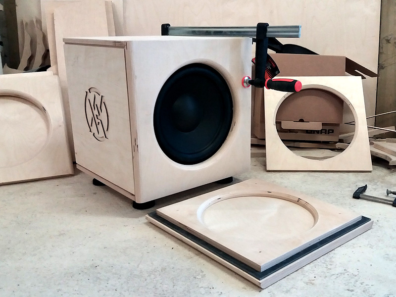

On another subject, I've been in my garage more often over the last couple of weeks. Each time I see those sub enclosures that seem to call out to me.
I still need to order a few parts, to be able to mount the amps to the back of the enclosure. Or rather, build them in. I really need to revisit my shopping lists and get off my butt to finish them.
I can't wait to start playing with them, trying to get an even better balance left/right down low into the double digits.
If all goes well (there's always the chance that it won't work out) it should help by limiting the excursion on the array drivers and may even improve the top end in the process. As said, I'd love to change out the wiring in the arrays as well, but no matter how much I think about it, I know that's a time consuming job to do right. Time is the one thing that isn't as freely available as I'd like. This isn't a job I want to spread out over an hour here or there.
