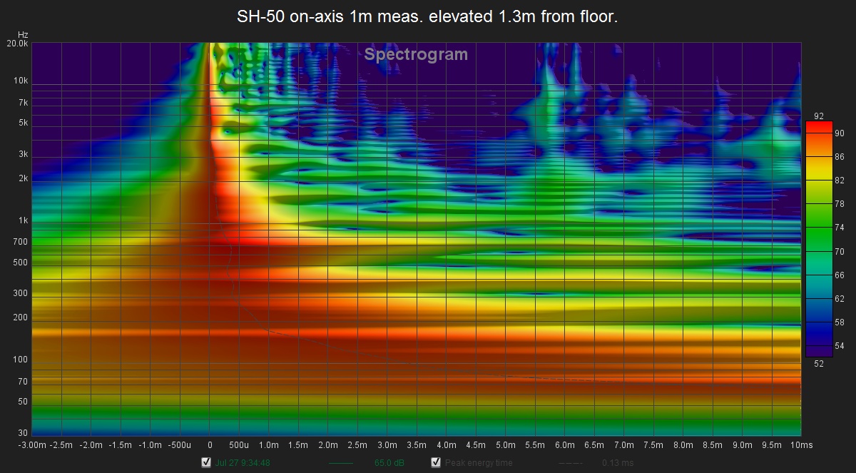

Just today a Spectogram of the Danley SH50 showed up:
(source thread: Monster Massive)
So I went back into my own files and tried to mimic the specific settings as close as possible with a plot of my own arrays...
In contrast to the SH50 graph, this one is taken at the listening spot (at about 2.7 m) and with both speakers playing. But it's not that bad, is it? The horns will avoid more room, as can be seen, but that SH50 plot was taken at a closer distance anyway.
My bass output goes higher than the plot limit I've set, that's why it's a big red mess at the bottom, but I didn't want to use the "normalize to peak" feature.
It's fun to see this comparison to what I would call a reference speaker, even if it isn't telling us that much. If you look closely, you'll even see some pré ringing in my (FIR corrected) result(!).
This is just for fun, don't take it too seriously . Though it might explain just a little bit why I can relate to those posts when reading them?

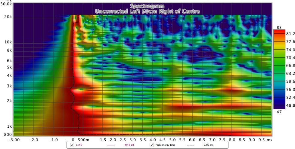

Hi Wesayso,
Your spectrogram of course looks exemplary!
It looks unusually outstanding even for one speaker taken close up; the fact it is for a stereo pair taken at listening spot shows incredible tuning and work with room acoustics.
May I ask how much FIR your are using...#taps at what sample rate?
How low in frequency do you correct?
Would you show the applied mag and phase correction curves? That would give me a good picture of what to expect from a similar line-array I'm considering.
Any chance you have spectrograms away from the listening spot....say 1m off listening spot, horizontal and vertical?

Quite a few questions there, Mark .
Let me see if I can answer a few of them.
FIR filter is running at 44100 sampling frequency, 32 bits. The number of tabs is 65536. Why? Because I can. I don't mind the delay for audio replay and audio/video sync for Home Theater is handled from within JRiver.

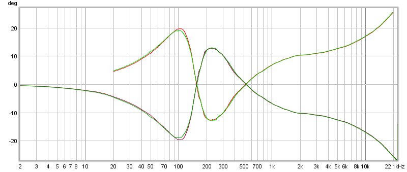

I correct from 20 to 20000 Hz with DRC FIR. Compensation is set to minimum phase but with a phase correction (excess phase) running below 500 Hz at about half the (sliding window) frequency dependent window length that is used for the frequency correction. I've even shared the correction templates and settings from DRC of one of my earlier correction schemes. It is linked somewhere in this thread. Things haven't changed that much ever since, aside from correcting based on an average of 9 measurements at 3 different measurement spots per speaker these days.

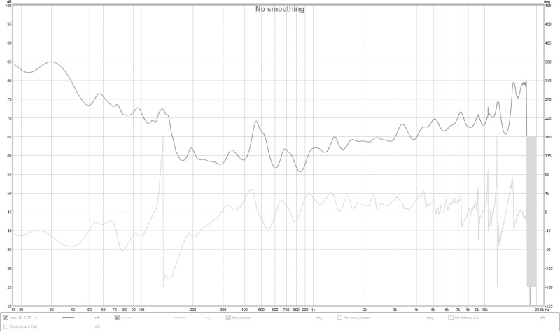

I've probably shown an example of the correction somewhere before too, as I found it uploaded to my web space...
This correction has quite a huge phase swing, right about where the speaker is playing trough it's impedance peak. I first looked at all spots along the listening area to make sure it was happening at all seats before accepting this correction. I never found the exact reason for this, I've seen in in almost all array measurements from different builds, save for one, the corner array from ra7. So I guess it is room position but it holds up under all seats covering the listening area. It's frequency also corresponds somewhat with baffle length though . This is a spot where I expect to be able to do better with adding my subs.
This correction (which includes the pré EQ I use) above gets it's share of EQ on top of it though, do you see the small and narrow boost peaks at higher frequencies? That's basically the FIR correction battling comb filtering and it is softened by me with EQ.

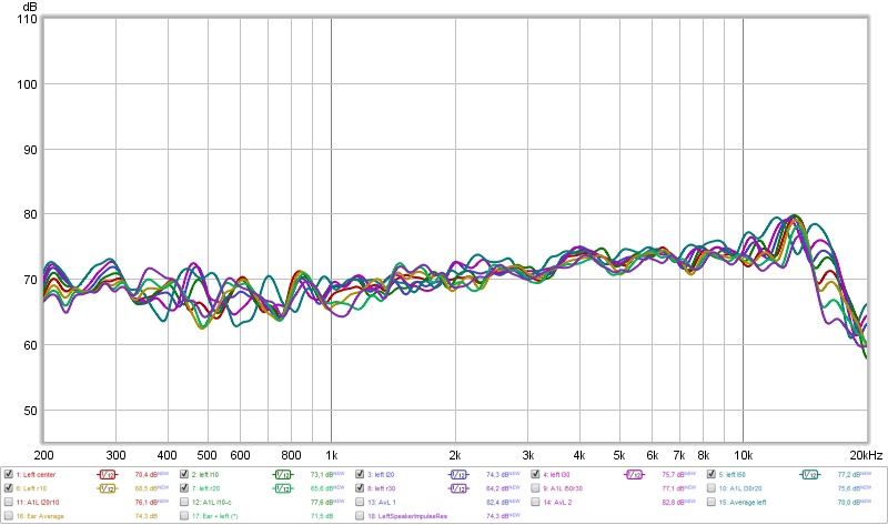

The 3 measurement spot average I currently use already filters out the biggest peaks and dips that are very location bound, this was an older correction example.
I don't have any far off axis plots taken with correction in place, but I'll show it to you in another way:
Above is a set of raw measurements of the left channel, taken with IIR pré EQ to combat the line effect on frequency output, getting it ready for FIR correction.
I've smoothed these with 1/12, usually I would show a 6 cycle frequency dependent window (as seeing that is way more important to me). This is a set of measurements spanning a meter from left to right of the left channel. The magnitude stays within plus/minus 2.5 dB overall except for the far right measurements of the left channel that fall beyond the reach of my damping panels. (damping panels are optimized to battle first reflections as seen from a sweet spot perspective)
So, yes, I can do square waves off axis as well. In all honestly, I think I've shown way more measurements (that matter) than the CBT crowd up to now. I think I've seen just one IR from one of those CBT's after nagging about it for a long long time. In that same period I've seen IR's from at least 6 different straight floor/ceiling line arrays as I've lend a hand here and there helping others get their feet wet with processing. (and quite a few other speakers as well)

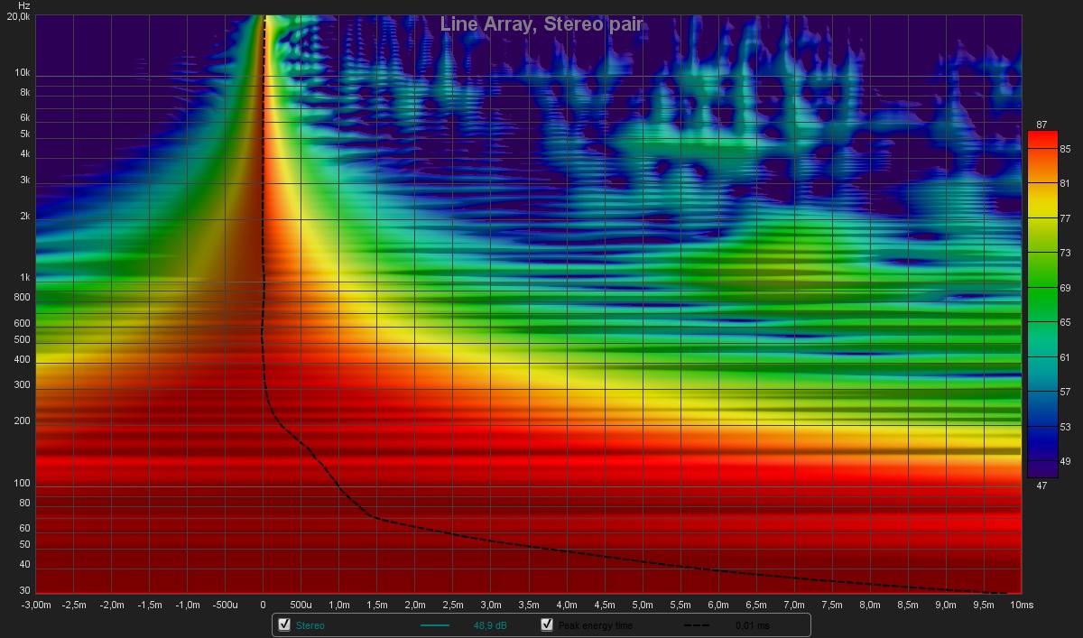

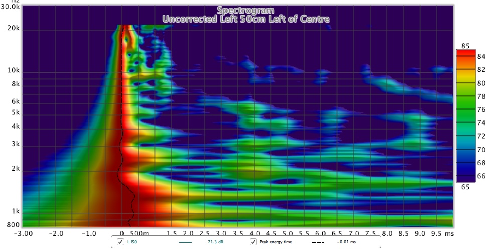

I hope wesayso doesn't mind, here are two spectrograms of my arrays, unprocessed at listening distance taken in a totally untreated room spanning the distance of approximately 1m across the couch with the left speaker above 800 Hz as below that the room takes over and destroys it! Most of the processing used to correct this is frequency based as the speaker is better than most from a time perspective.
There is very little difference vertically due to the array behaviour and lack of crossovers, not worth putting the effort into measuring. In my first round of measurements I used a lot of different positions, I didn't bother with nearly so many on the second time round as this sort of speaker is really very consistent within a realistic domestic listening space.

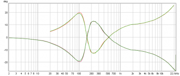

Hey, just spit-balling on your phase swing at impedance peak.....
I've found phase can wrap like that when too much magnitude change occurs quickly, and then mag continues to change in the same direction.
The rate of boost between approx 150 and 180Hz is pretty steep, and then boost continues overall the rest of the way lower in freq.
In contrast, the sharp mag change at around 470Hz is just a spike that doesn't continue a mag trend, so there's no time for a phase wrap to generate.
I think the overall degrees of phase wrap comes from the natural LF rolloff of the driver...but the wrap will concentrate the phase change in the range where the steepest mag correction is applied (150-180Hz).
Make sense? Again just speculating, but I've seen that kind of phase jump when I try to boost low end. It might me worth a try to see if smoothing the applied mag correction there helps...
I always find it enlightening to see how the mag curve often looks like and inverse mirror of the phase curve.
Yes it does make sense and that's why I suspect improvement once the subwoofer will enter the picture, making me need less boost. I'll still run the lines full range, but I'll try and balance the left and right speakers with the left and right subwoofer.
Right now the left array is helping the right one (where the right one does not do the bottom end around 30 Hz as easy) and the right array helps to overcome the left 'nul', where there's a corner issue around 60 Hz. Together they sum real well and coherent in time (as a bandpass system).
I actually lower the amount of energy at the dip, and boost the opposite side accordingly. Only doable below 80 Hz and preferably even lower than that or not needed at all. Here's to hoping the subs can help with that (and help create a healthy dose of headroom).
