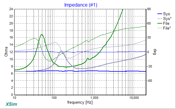

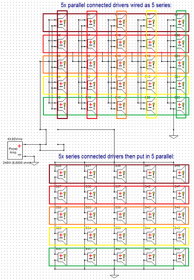

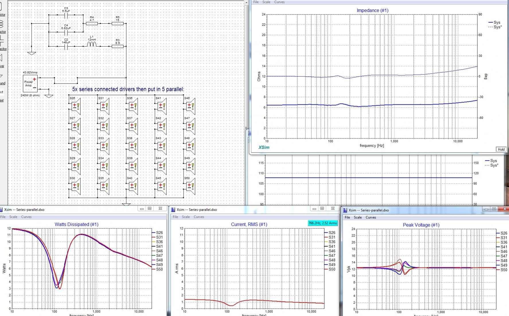

Although this might not be of interest to anyone but me, I just figured to sim "what I have" or close enough to it. I had to adjust to this sim's specific impedance curve, which was based on actual measured drivers in free air.
Here's a series-parallel sim with the impedance peak compensation, or at least as close as I could get it in a couple of minutes:
As I would expect, no change in driver voltage/current and/or watts dissipated.
So only the amp load would be different. For a comparison, this is my measured impedance curve with compensation:
Yes, I've put more time in that one, while I got a head start from BYRTT.

...So only the amp load would be different...
Yes looking in that direction graphs can show that new smooth Z curve amp look into, in below graph from May year 2015 your 25x TC9 is grey curves and after resonance and induction linearization networks is shown as the blue curves for the 25x TC9 array.
Now i would also argue there is another direction that with linearization networks included will short out backwave current that a nervous transducer (spring) develope, so a part of that backwave is hindered (shorted out local) reach back to power amps sensitive feedback network, but probably we could argue about worth of use linearization networks forever but for some it gets a subjective preference. Now it is so that TC9 is one of the most well behaved transducers when it come to relative swing in impedance curve, it have very low resonance and induction variation compared to most transducers out there and for that reason using linearization networks for TC9 is probably less noticeable or worth it. For comparison added the green curves in above graph which is a 10 inch woofer sitting in a sealed Q=1 box and when impedance swing is linearized for that woofer a sound change is very noticeable plus playing a few old recordings that have noticeable LF rumble noice then one can visual see cone is considerly stiffer (none oscillating) with a linearization network than without.
As said, with compensation did have my preference. I've only heard it on my arrays though. So it remains hard to say if it had a true advantage.

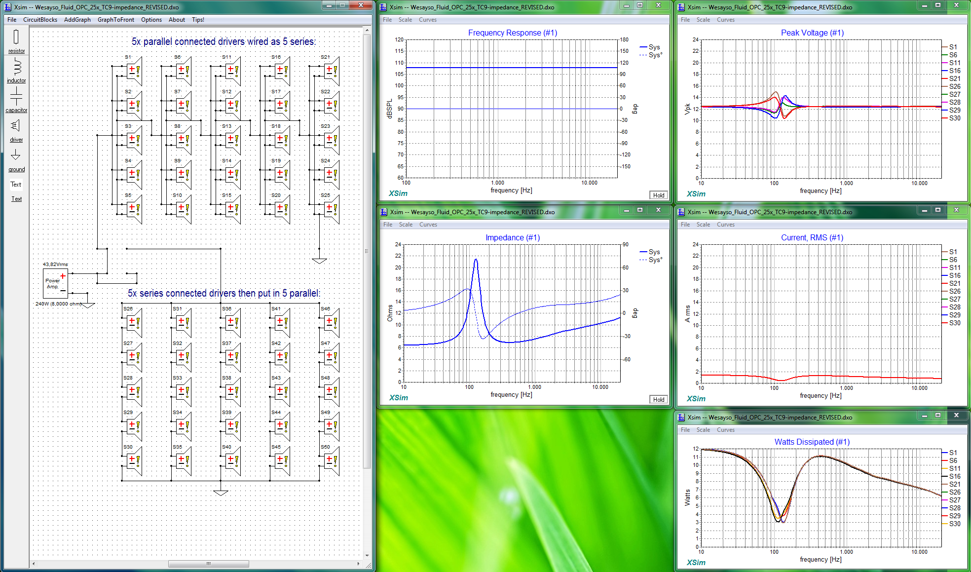

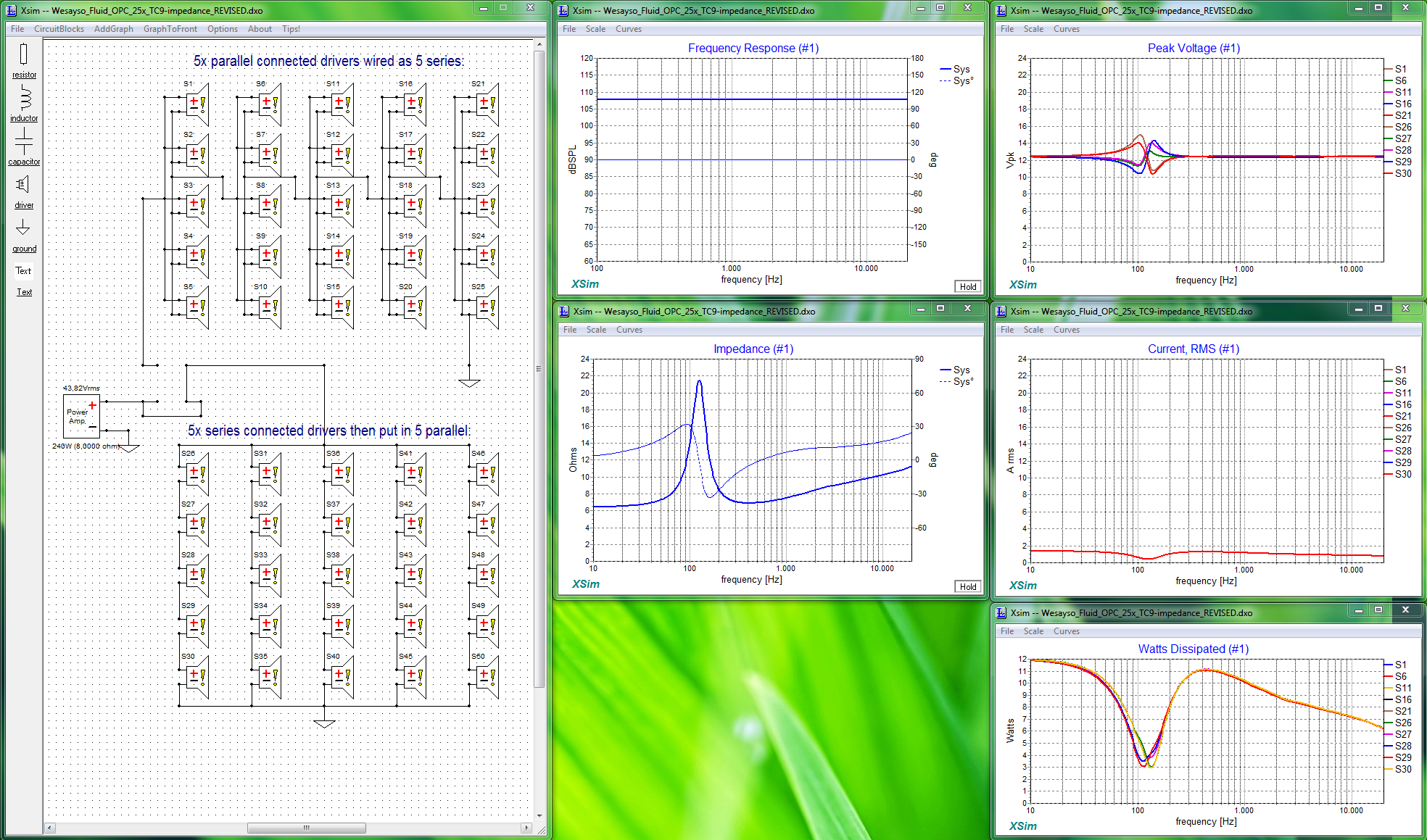

Had a closer look at original Xsim dxo file you build the closer study with those two flexible schematics to simulate series verse parallel wiring, if i remember correct it was over at Fluid's thread we started it out because opc had some thoughts and real world experience about some woofers that had physical destroyed themselves sitting in series within same cavity and that didn't happen when they were in parallel. Like the unfortunate ground connection back at around post 4921 it really looks we have some human user error that you will hate, so to keep head and mood up lets start quote koldby
...Wesayso was not wrong in the first place! The sims are wrong
My old XSim dxo file get exactly same variances as in post 4928 so pretty shure below will hold water and then in the end there is no real need to change wiring scheme.
Error is simulation was build upon 5 times different free air impedance curves made by Fluid and those same 5 differences go again from string to string as shown below for the 5 times squared horizontal colors. That means we have variances in series distribution for the lower shematic but for the upper schematic the five series sectors is now a exactly same per sector sum and therefor it show relative perfection about distribution. After changing the upper schematic so that the 5 times different free air measured drivers are sitting as the 5 times squared vertical colors then simulation graphs is exactly the same as shown in the two huge visuals hanged on below, well at a first look then graph "Watts Dissipated" looks a little different but its simply because one can't steer what color belong to what number of drivers for that graph window so look a bit closer and see they actual are exactly the same.
XSim dxo file is also hanged on below in a zip folder.
You're not kidding are you? So the final end conclusion would be: it doesn't matter after all. So Fluid's solution to group drivers to limit this behavior is an adequate solution.
No rewiring plans anymore for me...
Even though I feel kind of stupid about this all, I'm glad we seem to be getting to the bottom of it. One big motivator for me is to break some myths down from time to time, not for everyone, just for my own sense of understanding, does this qualify? It may have qualified if we got to the bottom a little sooner, BYRTT. However it's never to late to learn. So I'll say it has had its purpose. At least I did not promote anything bad or ill working.

So, no difference in parallel-series to series parallel?
I've done my arrays from the beginning using parallel-series, using the premise that it is the closest approximation to full parallel, which is most closest to individually amplified drivers.
In the end tho, gotta respect the science...
