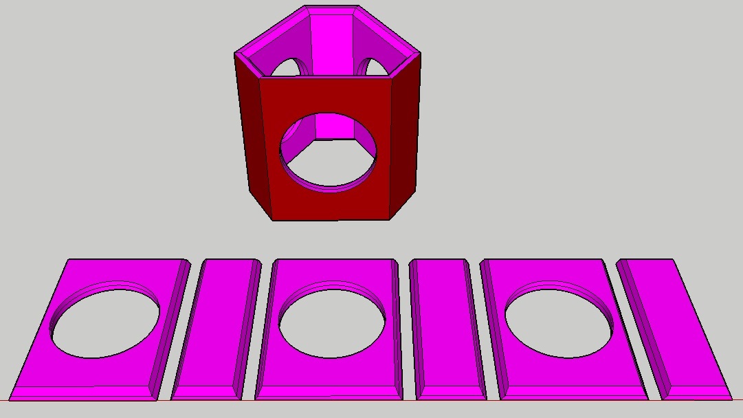

Looking to make a six sided sub, so it just makes sense to use slices.

but I've cut bevels on a CNC. You can get large enough Vbits for standard angles and cut them quickly, and, if you aren't paying by the hour for machine time, you can do arbitrary angles with repeated passes of a small ball nose bit and spread sheet math to figure out the toolpaths. but that is OK. Do what you want, its your design. If I owned a CNC, I'd probably be doing something with glue lam technique.

I don't deny it could be done the traditional way on the CNC with relative ease. But I guess like the OP I am just looking to do something a little different.
What I am concerned about is... Is my desire to push boundaries and doing things different going to be at the determent of the box? I have seen this method used plenty of times before but none have reported issues, that doesn't mean they didn't have them, but they probably didn't document the build like the OP for it to show up.
I think the box will be fine without anything fighting normal expansion and contraction in the orthogonal to the plane of the slices direction. Then it should expand/contract as a unit w/o stress. You have full freedom to thicken it where needed to support the drivers and resist vibration and can incorporate braces in the layers. Too bad a lot of wood will be wasted but it is in a good cause. Wesayso just had extra challenges due to the height.
Think of the great looking wooden horns you could make this way if CNC time is unlimited!
I hate to admit it but doing it the conventional way with a 60 degree V bit does make more sense on this particular project. I would lose my rolled over corners, but since I am not doing the wave inside (make no difference at very low frequencies) I can leave this technique for the rear speakers where I was planning to use the inside wave and more shapely cabinet.

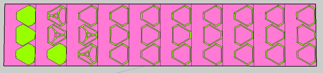

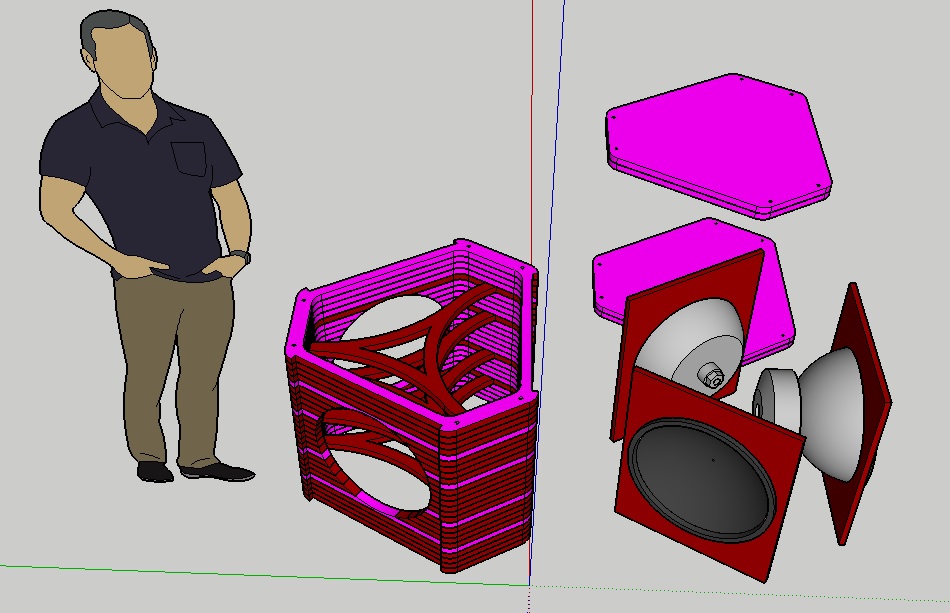

I did a bit of a search and like you say it isn't an isolated incident. Glad I spotted this thread before I spent $1000 on wood.
Would need to give it some serious thought how to interlock the corners.
I did a lay out and I can do it, but will need to lose 50mm off the width no real biggy as I can just add 50mm to the height to roughly compensate.
I also have a big table saw I bought about 7 years ago but never put together. That is an option for the angled cuts.
If I did two 25mm layers I could screw all the internal bracing in with long screws, and use the second layer to cover all the screw heads.
