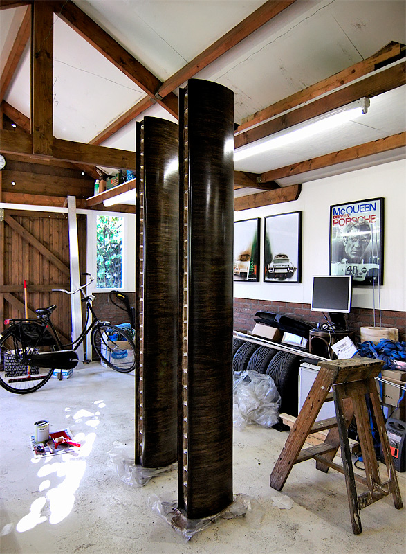

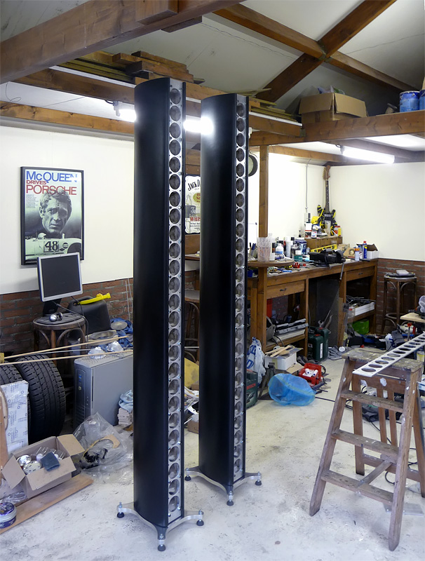

Working your *** off making all the needed parts gives you a lot of time to think and rethink parts of the design. That isn't always positive though.
As is reading a lot on this forum. One always gets new ideas and insights but I tried to lock into my plans and try to avoid side tracking.
One of the things that had me wonder is if I should use threaded rods in the glue stage or just use wooden dowels for guidance of the separate layers.
I decided upon the first idea, and have the threaded rod fastened with rubber rings on the bottom and top of the stack to be able to let the wood expand/contract somewhat. In between the layers I have open spaces where I countersunk the wood to attach the template for routing. That space is filled with a rubbery glue that stays elastic.
Here's the setup for the glue stage:
The aluminum foot is glued to the floor while keeping everything level and the baffle is fixed to the roof of my garage.
A couple of straps would hold the braces firmly to the baffle. I used some spacers to have the baffle a couple of mm outside the line to be able to strap it down.
Another time consuming job, the glue stage. Here's what I did,
Glue 2 layers together and make them fit the baffle:
(here you see the countersunk hole, the layers are glued together at the non-countersunk side)
(the thread cutting tool is used from time to time to rid the bolts from residue glue)
After preparing 2 of these I glue them to the stack:
Glue the bottom one first, slide down the middle one, again glue and clamp:
(check level while fastening)

The holes are all 8 mm and drilled with the help of the template. The bigger hole you see on the picture is actually the countersunk hole.
The 2 pieces of ply are glued together with the 8mm holes towards each other, leaving the countersink bore on the outer sides. That countersink is filled with a flexible glue as seen on the pictures.
I used countersink holes on one side of each slice of ply to have the bolts, that keep the template fixed, flush on the bottom side (the side that slides over the table).
So it really is a snug fit.

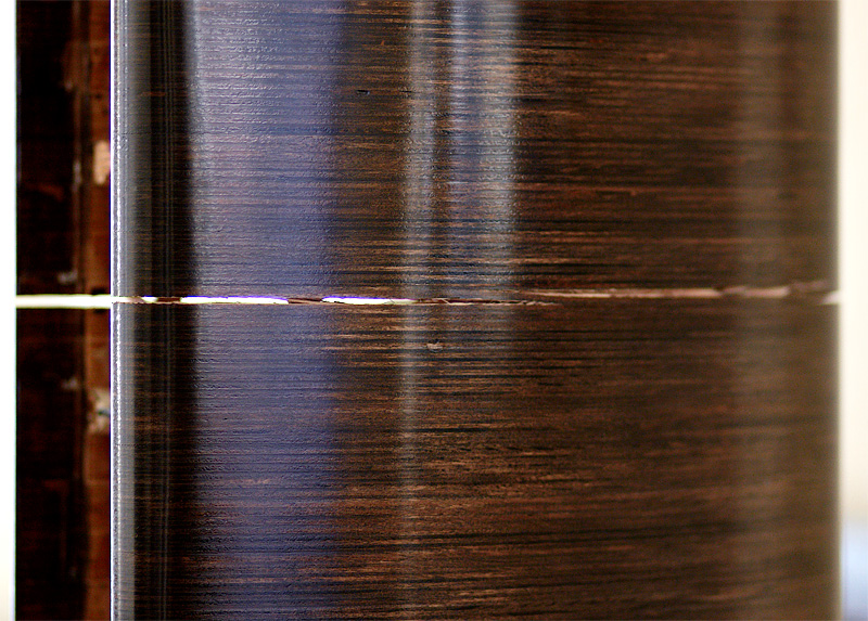

The idea behind the flexible glue was two-fold
One - To prevent ringing and vibrations in the threaded rods
Two - To damp the expansion/contraction of the wood
If you have read this thread, you know that second part did not work out. Parking the enclosures indoors after finishing them lead to (several) cracks upon sudden humidity changes throughout the season. The enclosures were covered in PU-lacquer on both in- and outside to prevent soaking up moisture.

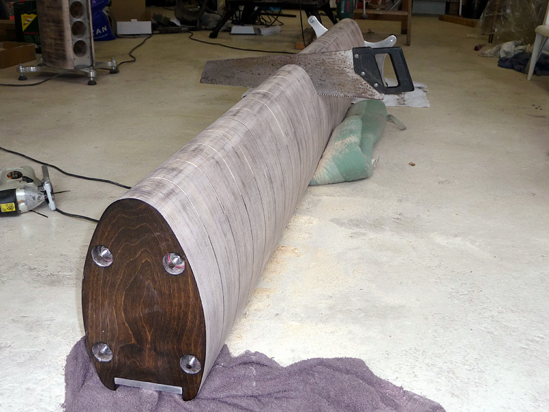

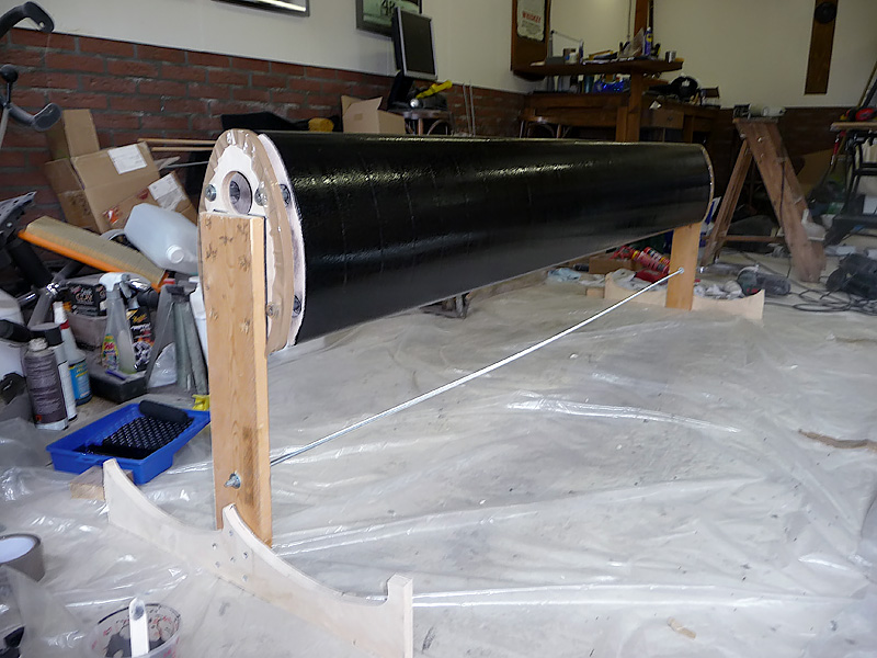

Final solution from me was to hack up the enclosure into smaller parts with flexible layers in between layers and cover it with fiberglass matt + epoxy on the outside.
The general consensus was to remove the rods as they were partly responsible for the cracks. My reasoning to let them stay was that they were the only thing holding the enclosure in shape. Removing them would mean a pile of partial enclosures.

The cracks I had were not on glued parts of the enclosure, it was in the middle of a ply layer. Slightly uneven expanding of the MDF could still lead to cracks.

The Rods were pré-tensioned (with rubber washers on both ends) to help keep the stack of wood under control. In the end it just wasn't enough to stop the wood from moving. I thought it was worth the gamble to have the wood layers visible, my original plan was what I ended up doing anyway (epoxy + matt outer shell). However due to this experience at least I got to make the room needed for the wood to be able to expand/contract.
The current situation is a bit different, the fiberglass/epoxy is quite a stable/strong 'hull' around the wood parts, with similar expansion/contraction to both the rods and the double aluminium baffle. The wood can move more freely inside, these 3 parts are what holds the shape.
I've handled them by myself most every time except when carrying them inside. There my spouse helped me to transport them both times. Completely finished they weigh about 70 Kg and I could move them around on my own. They have been stable in horizontal position and getting them back up again, but with a stack this high I wouldn't want to have tried that without the rods and aluminium baffle.
The force that broke them (contracting wood) was quite the experience. It was a loud crack one evening and I didn't even realise what had happened until the following morning when the crack showed up visibly. It happened during a large sudden swing in humidity which usually happens in the fall and early spring in our climate.
I can see the same thing happening to my oak wood floor each fall and spring. It doesn't crack the wood but it does have it's seasonal swings in expanding/contracting behaviour as it has just enough room to be able to move freely.
We've had several of those swings in humidity since then and the current construction has proven to be stable over time.
