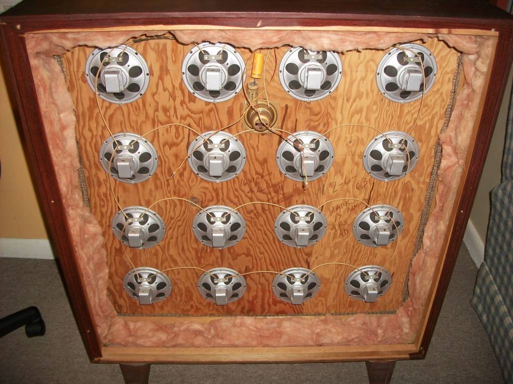

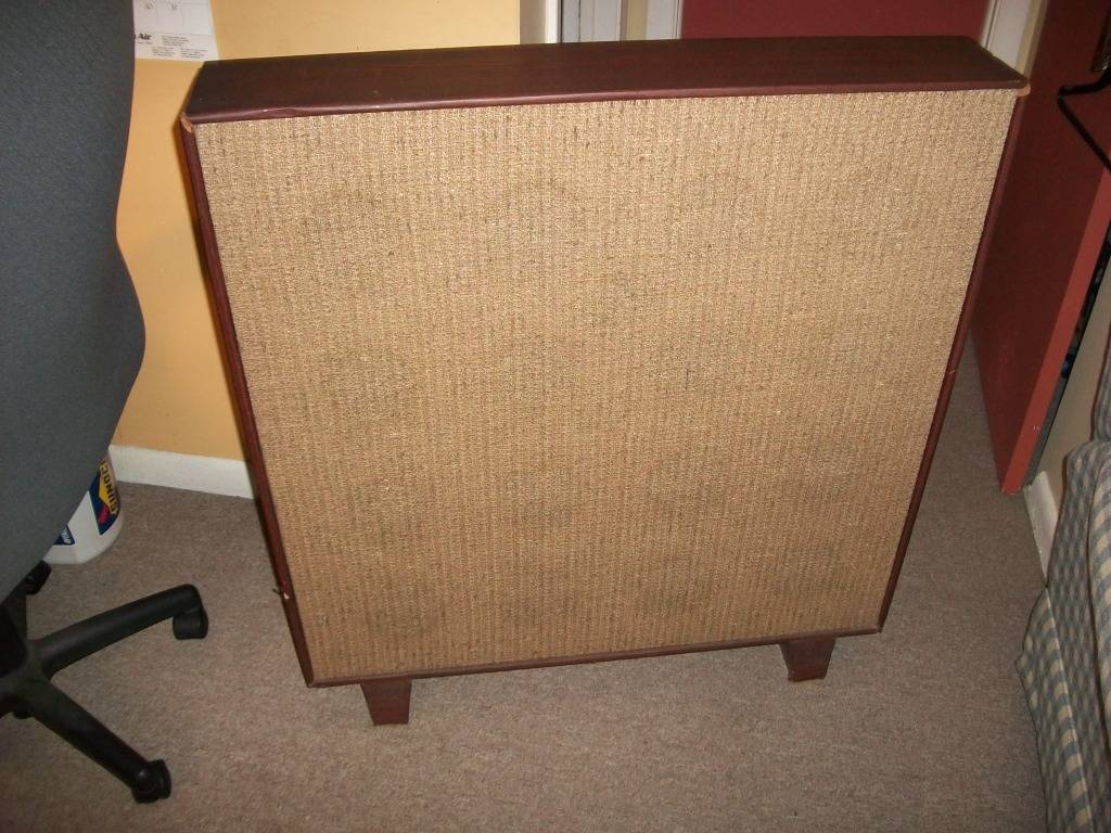

Long ago (before my time) there used to be a speaker called Sweet 16, consisting of a square of 16 full range drivers.
attachment.php
Prettier from the front:
attachment.php
The speaker linked in the video reminds me of that, but then put on steroids.

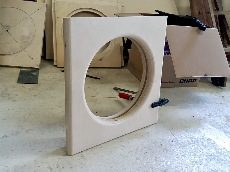

Just done stating I won't do pictures and here I go 🙂
attachment.php
After all, this thread is worthless without pictures, right? Wouldn't want to make you guys think I bought a couple of subs around the corner. 😉
Front baffle with a liberate round-over. Consisting of 2 layers of 15mm ply and an outer part of 18mm ply with 15 mm round-overs on the woofer cut-out and both sides. The open space you see there is where the woofer is going to sit. So it's similar to the double baffle I have on the arrays. The woofer will be bolt onto the back baffle, The front baffle will go over that and be tied to the back of the sub with threaded rods.
Before anyone asks, no I don't think that round-over does anything worthwhile at these frequencies, it's just there to tie the design of the subs to the arrays.
I'm still pondering if I'll do the logo engraved or embossed on the sides. It's obvious this would take more time...
but I think it could look cool and it adds a personal touch... Heck of a lot of work though.

Hey thanks for the photo of the Sweet Sixteen. I have heard some old timers talk about it, but never seen it. Looks like fun. 🙂
I've only read about them, never heard one...
