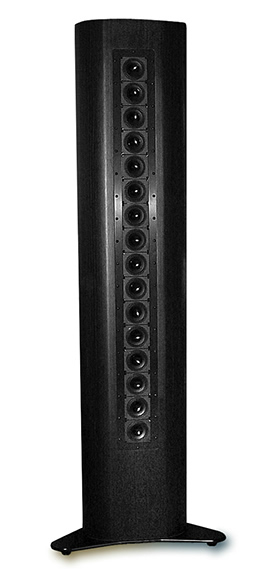

The shape I would choose for a free standing enclosure would probably be much more like the Genesis full size arrays:
attachment.php
My only tweak would be to round off the corners with a liberal radius, sort of like a wide oval shape. Even then, as a free standing array it would probably struggle more to make real bass as it would have less support from the rear wall or corner.

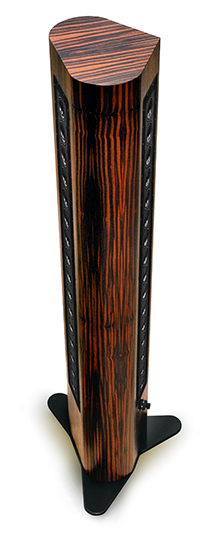

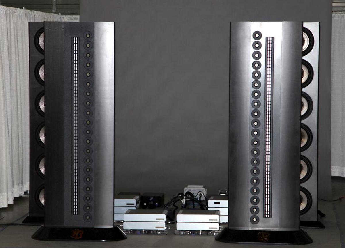

The ClairAudient line array is another interesting example:
attachment.php
(Though this picture doesn't show the ones they have in the back sides)
attachment.php

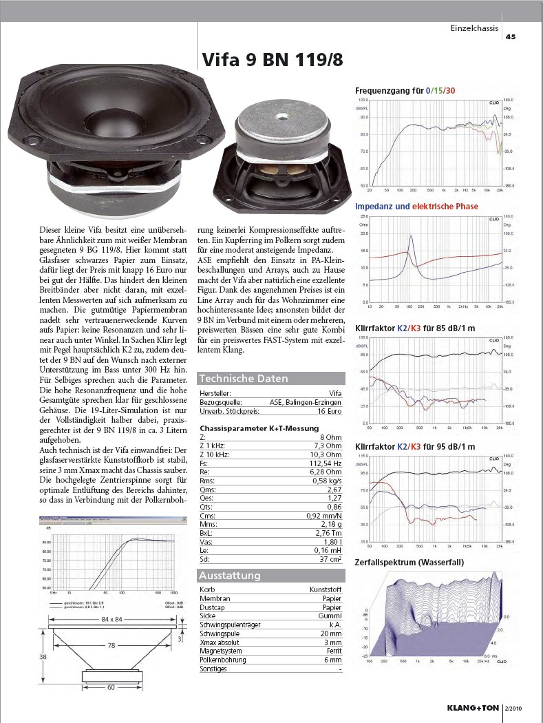

Marvellous, but really expensive drivers (Audience A3, not for sale anymore, but when they were they were really expensive, like € 170.00 a piece) with lots of x-max. Not quite as flat in response as the TC9 (but close enough) and in my opinion they should have used even more drivers in that array (to make it span floor to ceiling).
X-max (absolute) 12 mm(!) 😱. In comparison here's the TC9 under the same test circumstances:
attachment.php
Not bad for such a cheap driver, is it? However I wouldn't say no to a box full of ClairAudient Audience A3 drivers 😀.

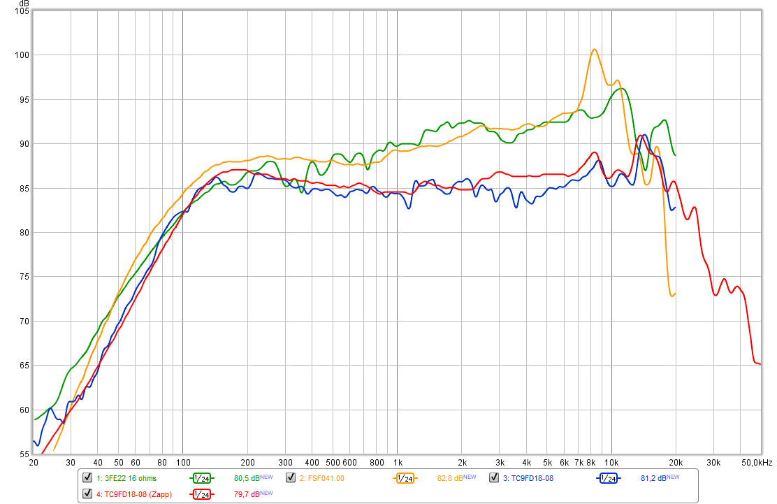

...I realize this is run on manufacturer's data alone but we have to have a starting point for comparison, don't we?...
Yes pure manufacture T/S data to base high pass funchtion but some of them are quite good and can start our dreaming adventures, below same datasheets response curves traced into same overlay and a third party measurement for TC9 from Zapp that confirms Vifa data is repeateable at other physical location. Doing this graph comparison makes it clear that raw out of box TC9 is king here and that 3FE22 miss its lows to keep up in sensitivity below 1kHz point.
Thanks again, BYRTT! That's quite the rising response from 7k-10k for the FSF041. I imagine that would have a rather forward sound. More evidence in favor of the TC9.
A rising response in an array driver is a good thing as long as it is smooth because it needs less boost to offset the HF loss that comes along with the interaction of all the drivers.
The big peak at 8K is more of a worry though.

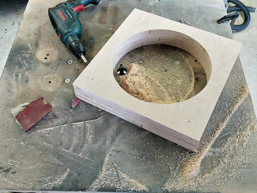

Finally started making sawdust again...
attachment.php
Slowly working towards this goal:
I'm keeping this simple, well... sort off. No metal frame inside. I'm making a double baffle and it may incorporate threaded rods to fix the baffle trough the enclosure at the back. Keeps it clean on the front, and easy to open up if needed. Yet it's still relatively simple to create. Only one brace to keep the body of the enclosure in its shape, and front and back fixed to each other to tighten it up.
