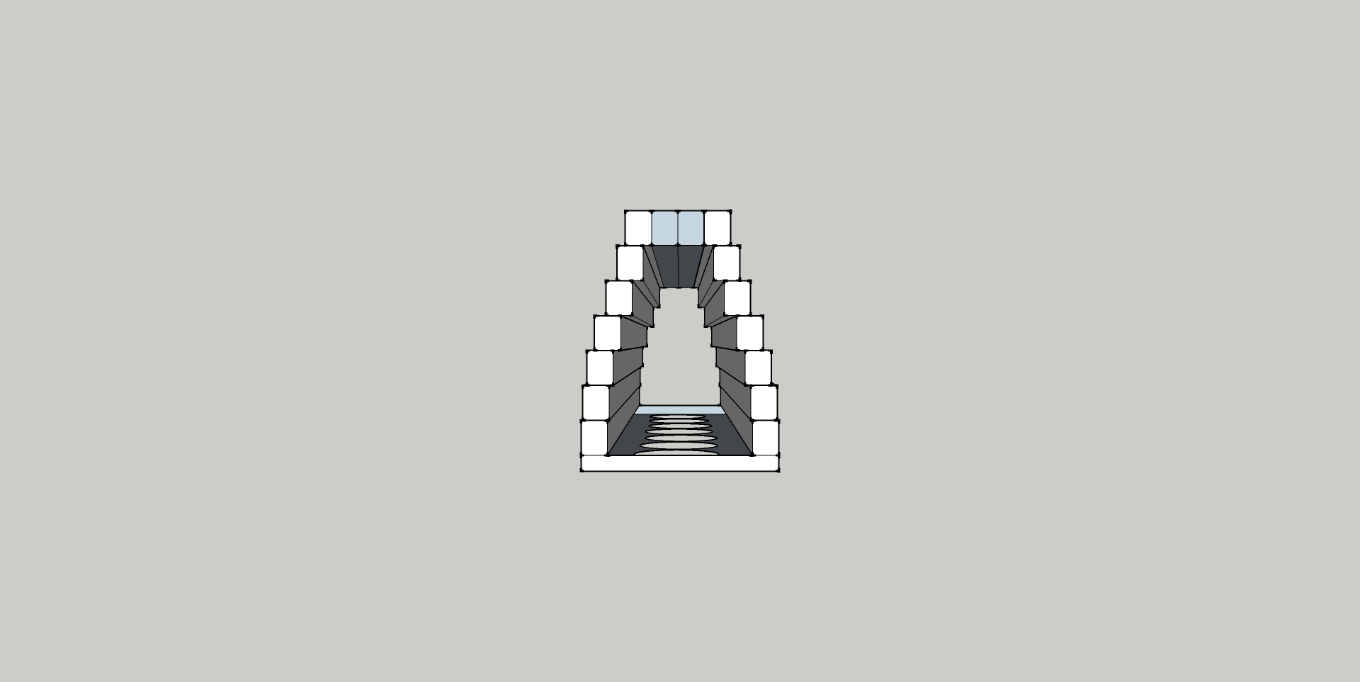

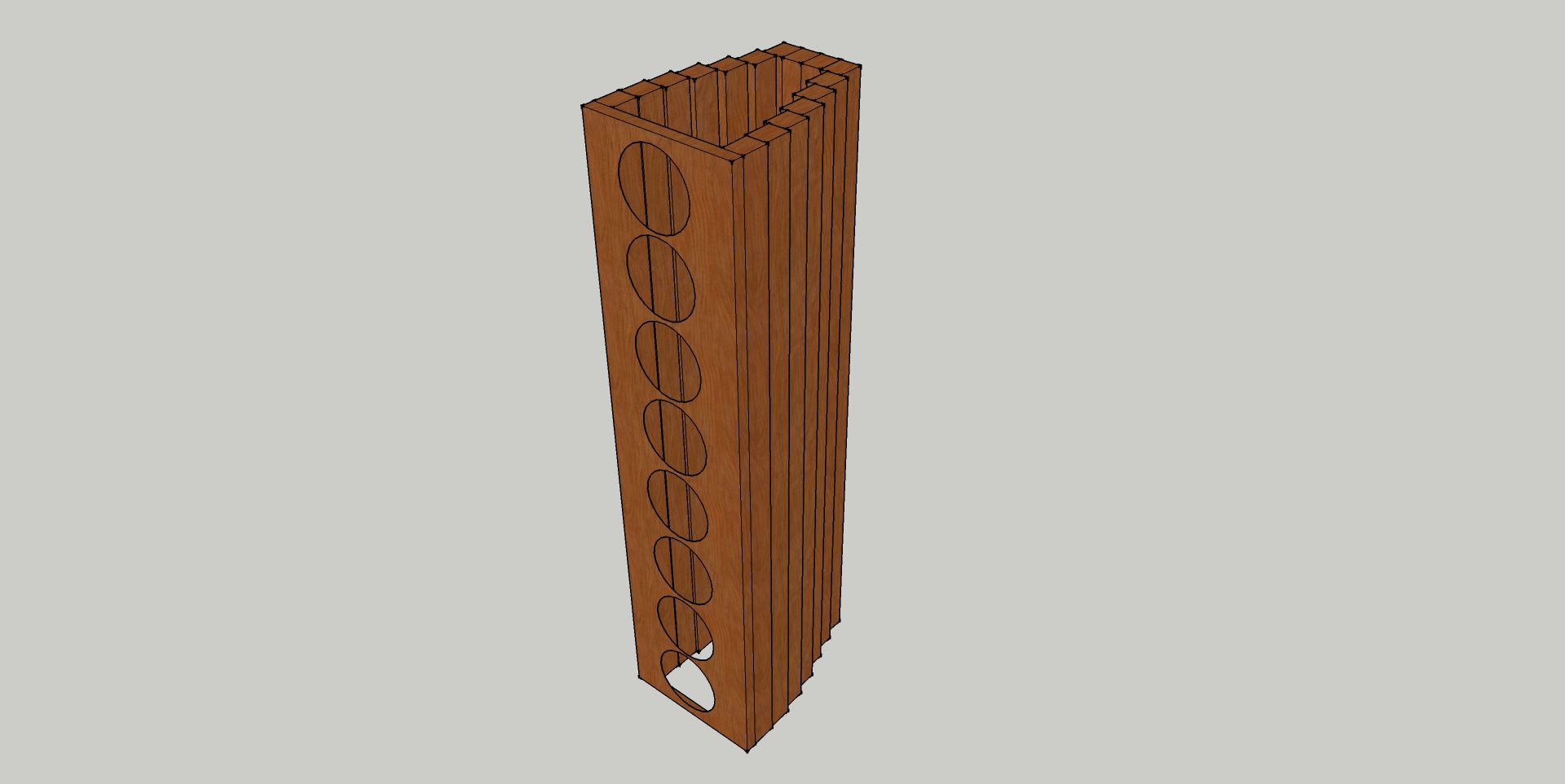

You stacked pieces from bottom to top, but I'm wondering about stacking them from front to back.
Once assembled, I could sand the exterior and make a smooth curve, while keeping the interior irregular.

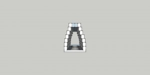

Here's a crude, not to scale and not with the right amount of drivers, of my idea.
I would imagine gluing them up and keeping them straight for a 2 metre tall enclosure would be quite a troublesome task. But fabricating the individual pieces is a lot easier, and for shorter line arrays it would be easier.
Or maybe you have something in mind that the sketch doesn't show?
There would be internal bracing that is not shown in the drawings.
I know that keeping the whole thing straight and not warping would be the biggest challenge.
Maybe doing it in stages, just like a rocket. Depending on the number of drivers I go with again (between 16 and 25) I could do 4 or 5 sections that would be stacked and glued up in the end.
