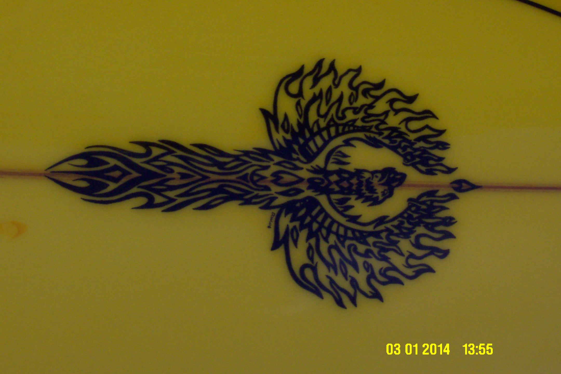

2 coats of Polyester Resin, 1st coat 'un-waxed' so it remains tacky the coat 2 has 'wax' added - wax in styrene being a leveling agent and makes the resin 'cook' it's self).
This 2nd coat is known to surfers as a 'Hot Coat'...... you can sand it real nice then do whatever you want to it, usually a 'Gloss' finish.
You can tint it ANY colour you want as well 🙂
Then gloss / polish over that.
This boards finish is very thin (about 2.5mm), with 2x layers of 100g 'S' glass tint laminated / hotcoat / 'Taupo Gloss' resin.
Looks liquid in the flesh.
You can also 'Glass Polish'....... thats Really tricky / hard work.

Quite true, but then you get what you pay for, money, time or both.
That board is 8ft long, resin (Silmar lam / Taupo gloss), cat and wax, paper and polish compound = 60 euro's
And about 5 times that to pay me to do it - didnt charge him for the hours I spent staring at it, squinting hard from every angle for hours on end under the lights...... countless test tints on scrap to get the colour 'Just so' OR the resin pin stripes.
The customer said 'Really go for it D...... blow us away.'
That was my first attempt at 'Tint 'n' Gloss' and took me about 3 weeks.
I would say that wesayso has ample skill to do a similar (less the glass fibre) to get some where close to the Fenix board's finish - also has the advantage of the shape being 'strait'.
