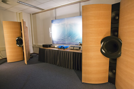

Did you also consider any sort of horn design? It's not obvious that you would have with your stand alone towers, but given your crazy brain waves, perhaps not a stretch?
Actually, I've given a Synergy design a lot of thought. Especially one that has multiple woofers below and above it for the parts below the horn cut-off 🙂.
I couldn't sell that idea to my girlfriend.... she dislikes the big horn speakers. I love them though. Especially the Synergy type.
(or the big old Altec stuff)
I remember you mentioned those at some point. I was more curious if you considered a "mini" horn for your towers. Perhaps integrated into the cabinet design itself. Or perhaps as "wings" to your cabinet.
Yes, not too long ago I posted that BD-design array picture, right? Talking of substituting the woofers for an array of smaller TC9 drivers and losing the horn...

Ah, I missed that photo. What you describe is exactly what I was thinking! Are there rules of thumb behind size and shape for the profile?

It would be interesting enough as a concept. But the things I'd look for is to make any wave guide shape an extension of the actual cone (for the benefit of higher frequencies).
Plus if the sides are actual walls I'd make sure to make that transition as smooth as possible and make the guide part extend down to the lowest frequency possible (means huge wings). The OS profile from Geddes might be a good start, or maybe JMLC could be even better.
