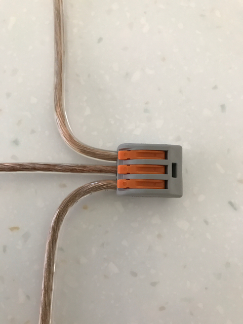

I ran 2 (bigger) wires trough the enclosure and branched from that every 5 drivers. It's following the same schematic you show.
How did you branch it out? Just solder?

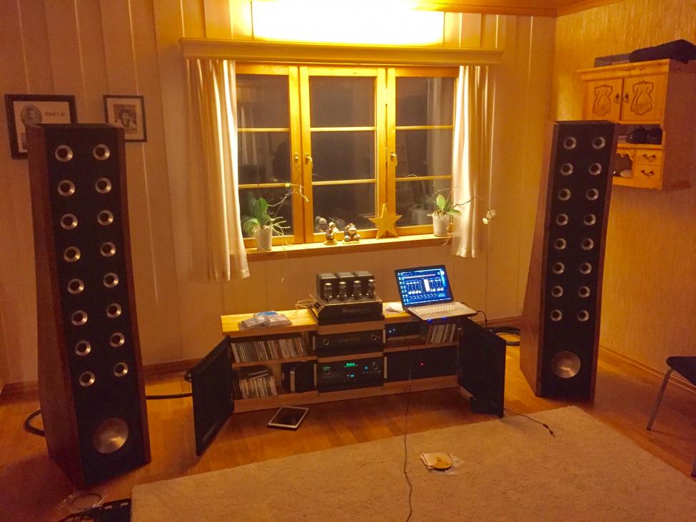

I do consider it an honour to be mentioned in the article (now you know why I posted that new room picture ).

I have made a lot of those joints in the past but recently I have been using these lever clamps for joining mains AC and transformer windings.
This is what I planned to do. They clamp down very tight and it would take a significant amount of force to pull them out. The wire in the middle is the branch that will go to the driver the others go up and down the cabinet. The plastic part is then stuck to the cabinet with hot glue or strong double sided tape.

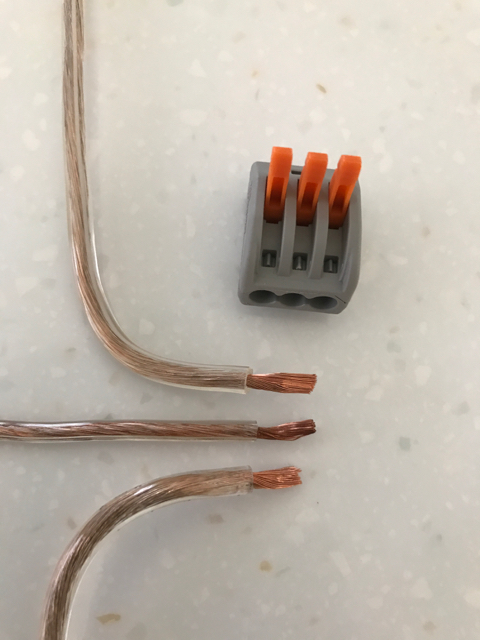

This is what the components look like
By doing it this way I can still access the wiring through the driver holes if there is an issue. If need be all the wiring could be replaced from outside the cabinet as I won't have any removable panels.
