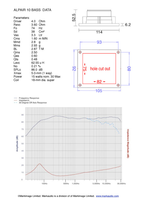

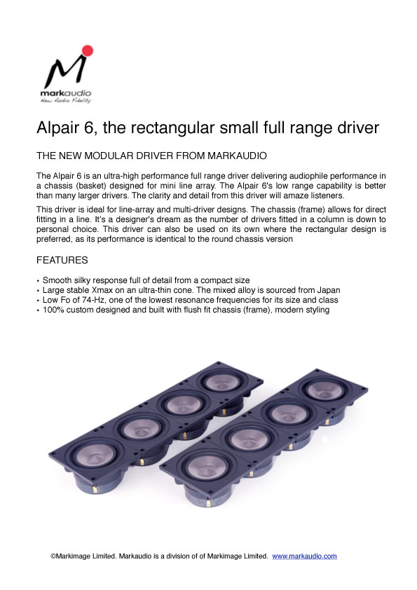

Would these have been suitable drivers? Price was between Scan Speak and Vifa. The still available round version is about US $56.
Not sure why second image has Alpair 10 Bass Data on it, as it is definitely the Alpair 6 rectangular data set.

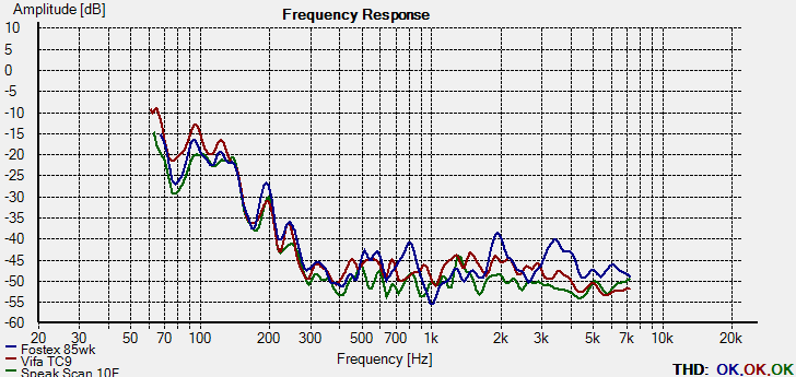

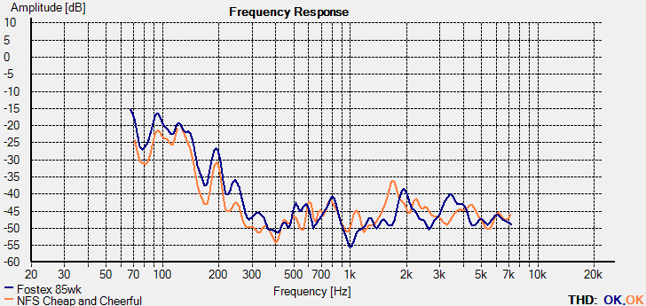

Here are the distortion measurements between the Vifa, 10F, FF85wK and NSB (or NFS): ???Is it "No stinking Badges" or "Not For Sale" for my current drivers???
Bear in mind the drivers were mounted on a 18" x 32" panel, which resulted in a natural roll-off around 300 Hz...

Isn't it amazing to see that Vifa almost keep up with the 10F?

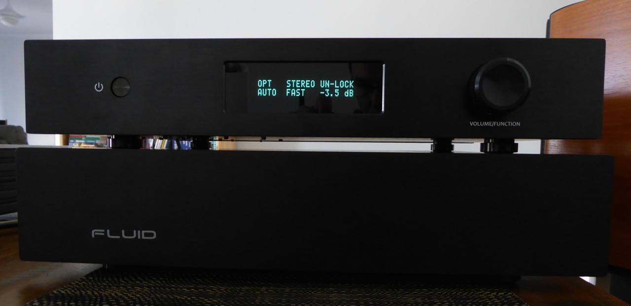

I've seen your pretty amp on LazyCat's thread, now that I know it's going to be used on arrays I'm getting pretty curious how that's going to work out! :up:

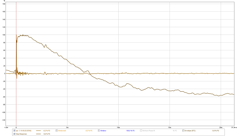

Let's see, here's the original signal that goes trough the DAC:
In other word: as fast as the bass can be
Here it is played in my room at the listening position:
Almost as fast with a delay in the lowest octave, better seen in a 2D plot:
This is what I call fast bass, loud and clear.
