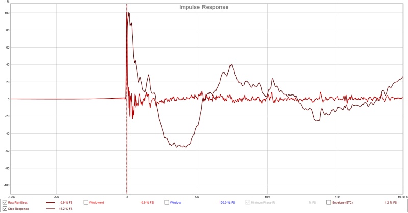

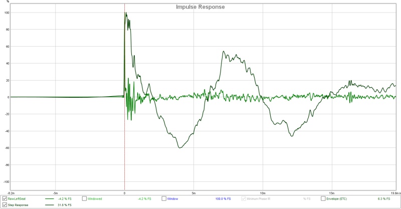

20ms STEPS in %
Thanks Brytt, I am still slowly learning this software and how to use these graphs to improve the sound.
These look a lot better, a broad peak between about 5ms to 10 ms, centered at 7 ms. At the speed of sound, 7 ms is about 9 feet, which is the distance of the arrays to my back wall. Not sure what is causing the 11 ms peak from the right speaker, that is about 14 feet - outside this room. Maybe that open doorway is not benefiting me as much as I thought. Do I have the math of this concept right?
Edit: Maybe the 11 ms peak is caused by the right array bouncing off the left back side wall/corner. This does not occur on the Left array due to the open door... thinking aloud here...

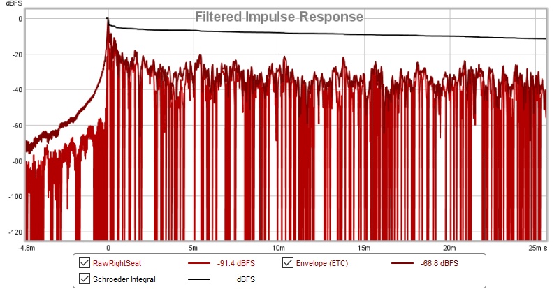

Hi Allen, we can see a couple of things here. Though it would help to also see the same area in the filtered IR. Just to see what level some of those disruptions are. Several things can influence the behaviour of the STEP. Not only reflections (I see a couple of very early ones) but also the driver itself. Also the length of the array matters, as it will end behaving as a directive source at some point as mentioned above.
The filtered IR tab should look something like this:
This is in dBFS. It shows the levels of the reflections. My goal has been to get everything in the first 20 ms down by -20 dB right after the peak. This isn't totally fair, as it does not show the complete picture. The low end isn't that good presented in this graph. But for starters it would be a good goal. I know this graph shows a way longer time frame, the first 20 ms would be enough to concentrate on for this moment. Getting that cleaner will also clean up the slowly declining tail.
A third graph that is useful to see next to the two above is the frequency plot with phase, with a ~5 cycle frequency dependent window. Just to see where phase is moving off from the normal expected path. (another indication of trouble, either due to the drivers/enclosure/room. At those points where phase is showing a change in direction the STEP could also sway the other way.

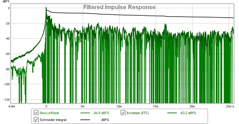

Filtered IR in dBs
Here they are, scaled to match the STEP. The arrays are 60" (152.4 cm) tall, so I am in the near field down to about 600 Hz in my listening area. Also, the drivers have a rim that sticks out, and the cabinet baffles are not smooth. It would be good to learn how to see this in these graphs, so when I start designing my Vifa arrays, I can "see" what is going on and connect that to what I am hearing. 🙂
The thing I notice, both in the IR and these filtered IR's is the stuff that happens right after the peak in the first ms. Those are also the points where you clearly go above that -20 dB goal for now. The right array is doing something the left isn't showing at 2 ms. But it's less busy in that first millisecond. Can we learn something from that by observing the surroundings of the arrays?
Wait a minute, the left has that too, only at a lower level. See how both have an upwards peak at 2ms?

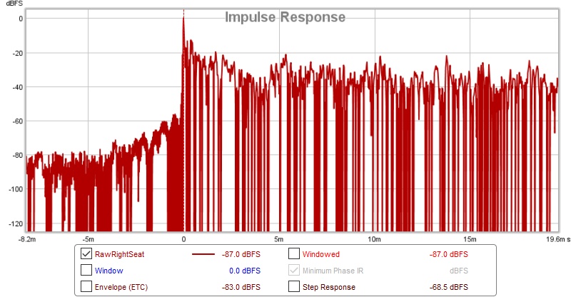

Can you supply us with the RAW IR's of the left and right channel? Stuff that happens very early can sometimes be corrected with DRC (see the DRC manual about placement).

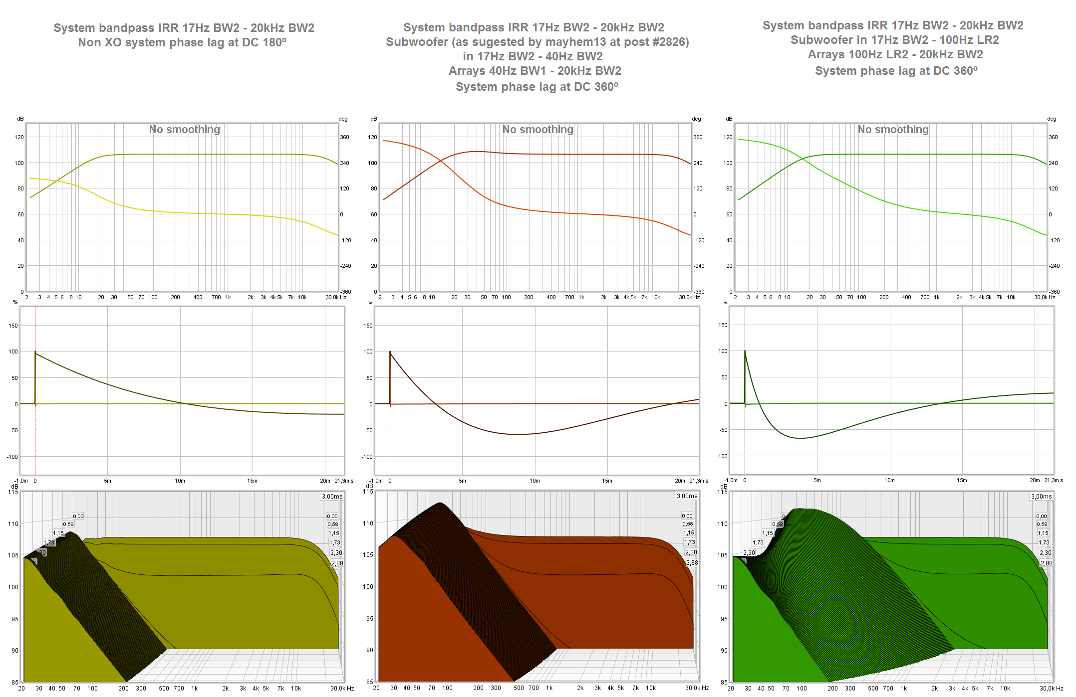

Great and welcome guess your arrays has subwwofer that includes IRR XO as in right examples of simulation based on IR created in Rephase.
At left is close to as wesayso's arrays, in middle same with a subwoofer IRR XO'ed at very low frq as mayhem13 suggested to be sub LP 2.order and arrays HP 1. order, and at right is also with sub but at 100Hz symmetric LR 2.order. Step response in first differ from wesayso's real world probably mostly because of his preferred ala B&K tonal house curve so that top of peak get rounded pretty much. Phase turn from IRR XO to filter subwoofer into picture is the difference that change SR and waterfalls by the way at waterfalls we look 20dB down, and at 100Hz LR2 we see otherwise the left one how it phase starts go lagging numbers around 2kHz and muds up in midrange area if i'm right : )
Of course if FIR power is available and CPU process release time to correct phase is accepted then middle and right example can look and sound have exactly same SR and waterfall as left one.

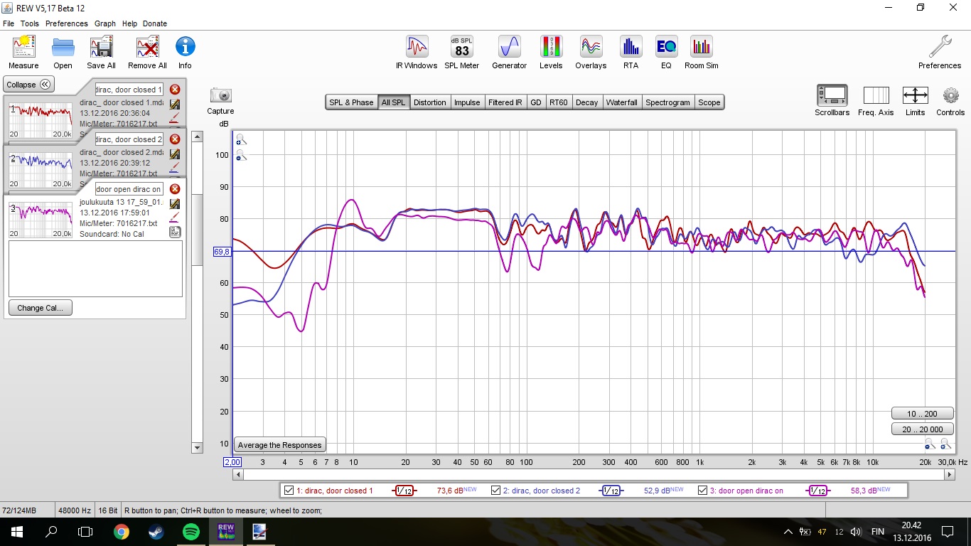

This is how my EQ is set. Notice a roll off at the low end. I have made the mistake of not looking at that roll off carefully enough.
Hope Mayuri doesn't mind but I will take his graph as an example:
See how the EQ is set? With a big bump at 10 Hz? On ~98% of recordings he will be fine. But I bet he will get a scare sooner or later if he keeps that graph like this. Listen at 88 dB to 92 dB average and all of a sudden you think: what was that! Especially if he leaves the door open 😀.

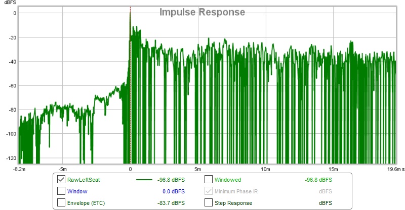

As requested, here are the "regular" IR's in dBfs:

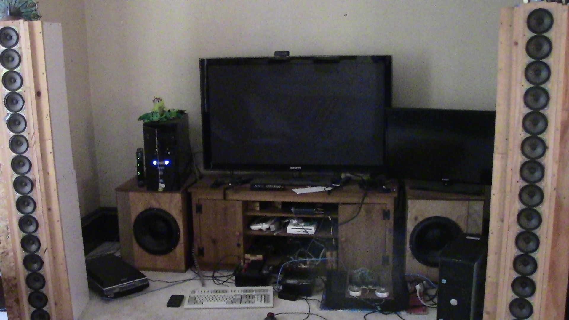

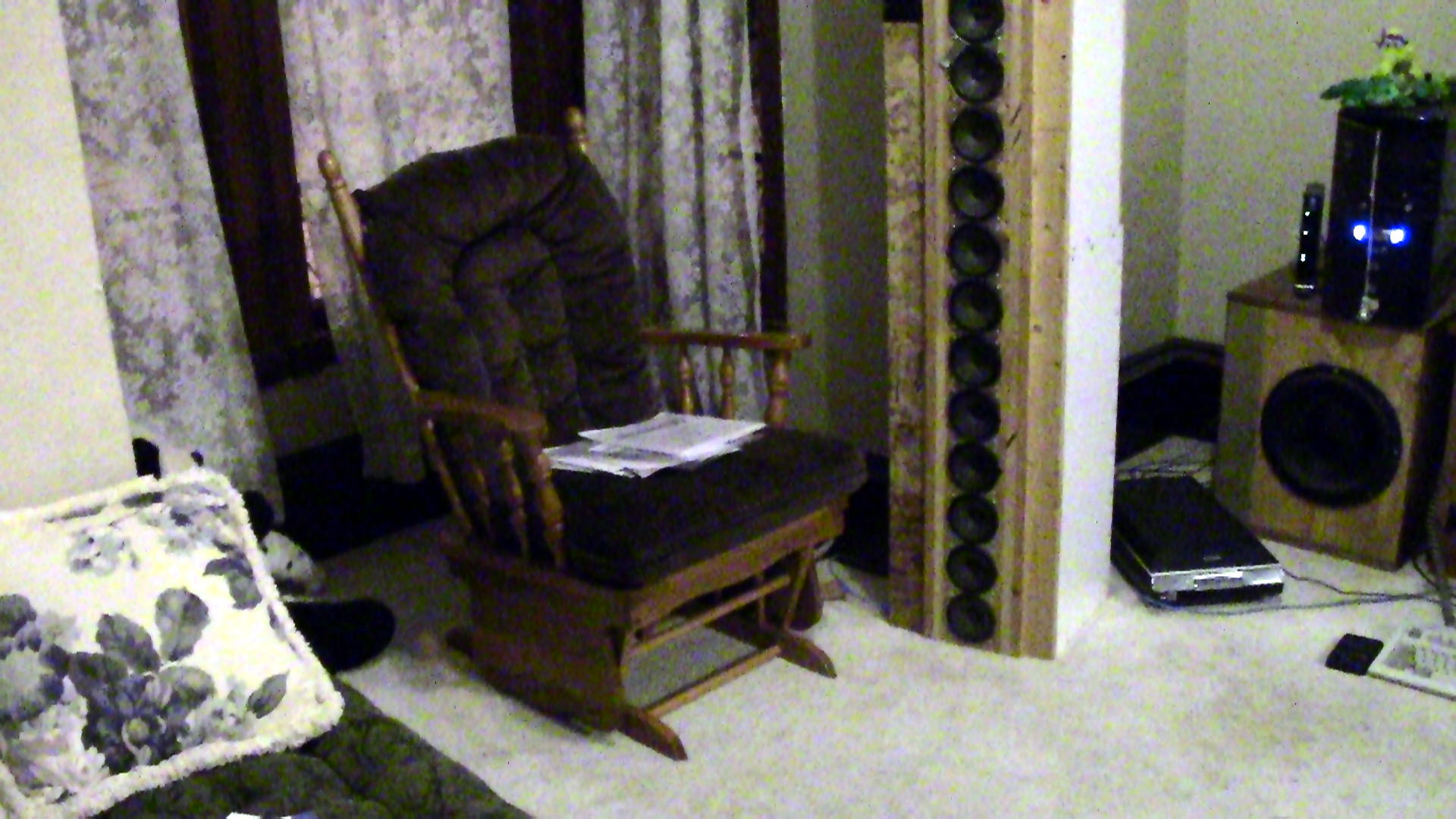

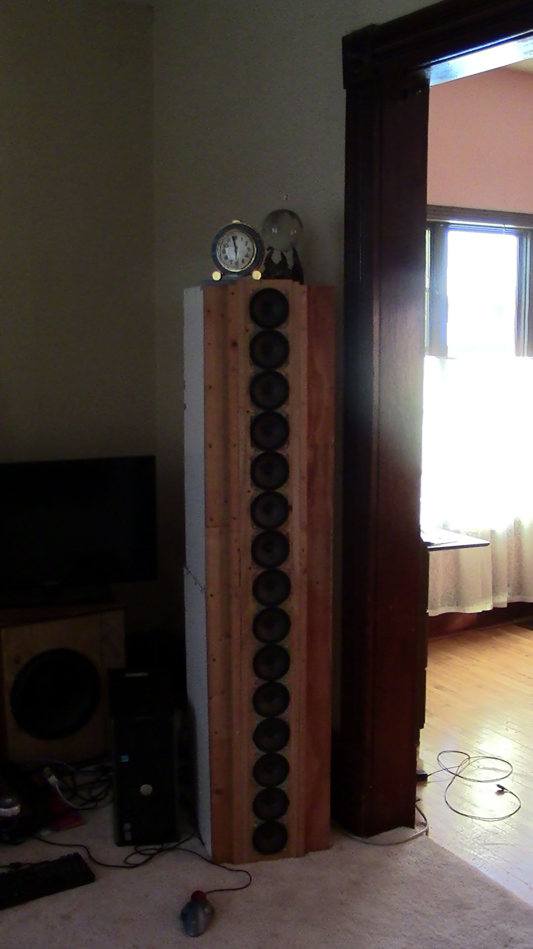

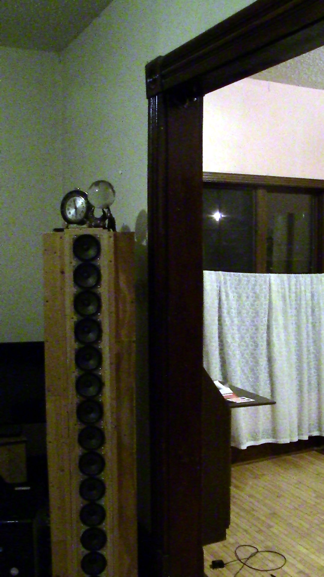

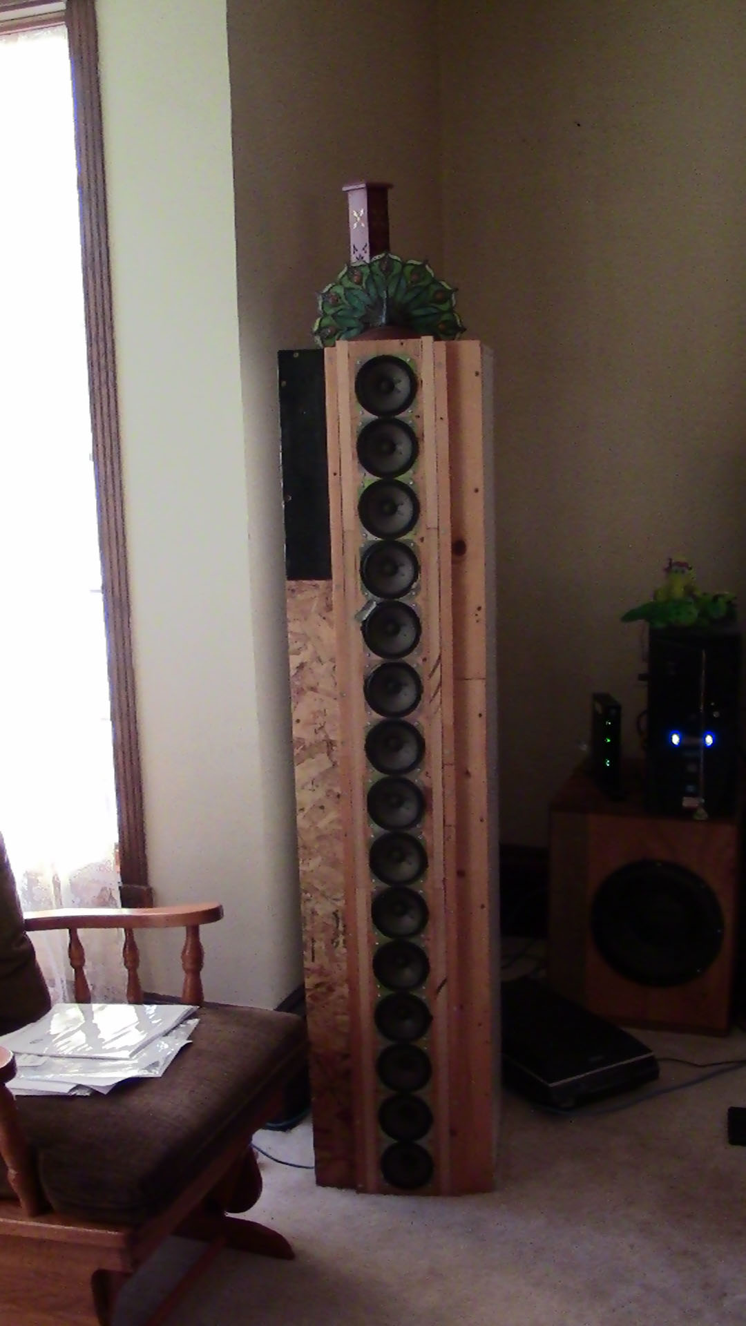

Pictures of a work in progress...
I am a little embarrassed to show these, partly due to the mess my system is in and the build quality of these cabinets. But the more I can learn and get out of this "Cheap and Cheerful" system, the better my next build will be. The amazing thing is how much Joy this hack of a system has given me. 🙂
2ms is about 28". The front panel of the arrays is 3 feet in front of the subs and entertainment center, so I do not think that peak is caused by that or the TVs. I am thinking it might be the rocking chair for theleft array, as the back cushion is about 28" from the array. This might explain why the peak is softer from that speaker, as the cushion absorbs. (Apparently it reflects too 😱) For the Right array, the only thing at 28" on the front side of the speaker is the top of the archway. With the arrays being 60" tall, the reflecting frequency would be below 225 Hz, at least in theory. In both cases, it could be the side walls behind the speakers also. I could try moving the rocking chair and remeasure that channel to "see".
For some of the closer hash I have, I am wondering if the archway side is influencing the Right speaker. For sure, the baffle and the driver ridge is causing some of this. I have considered mounting the drivers on the inside of the baffle, so the baffle sticks out slightly above the ridge. I could then figure out a way to do a round over. Also, I could make these cabinets way smaller. Yet that valuable time could be spent building the Vifa Array too. We will see, if I learn something by improving these "Cheerfuls", it would just make the Vifa build that much better.
