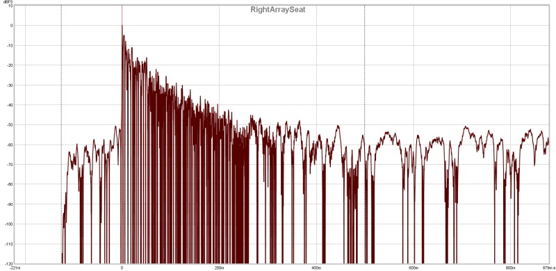

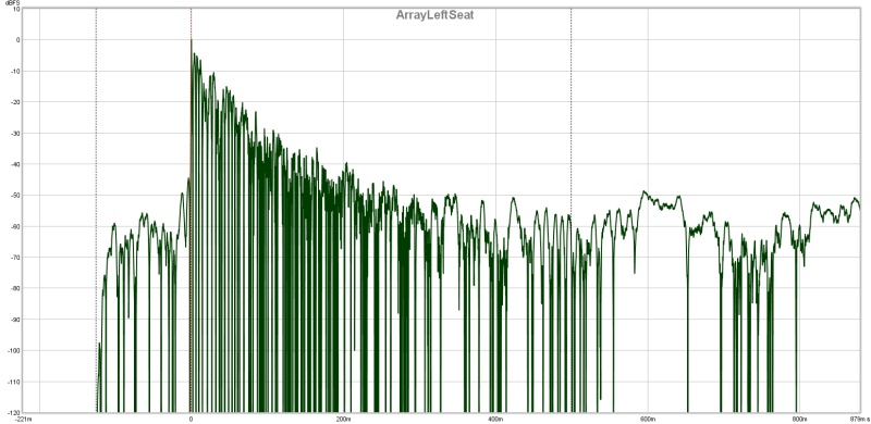

Here are my... ugh... STEP graphs. I show these in hope that they will encourage others to fail forward to success on their journeys also. 🙂
In REW you can turn on the STEP response and see how that STEP can change shape wherever there's too much reflections happening. If you don't fix that your DSP correction algorithm has to battle with it.

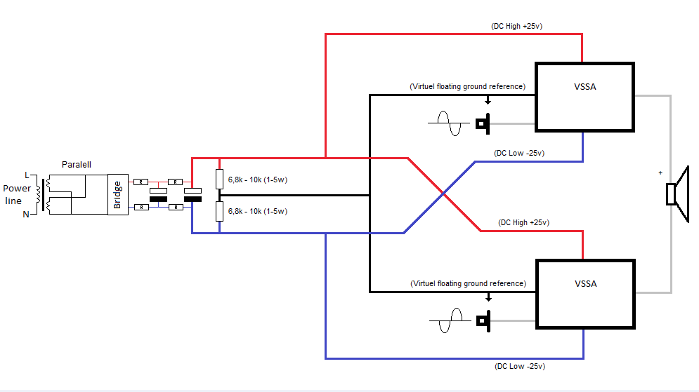

What you mention there is all true and good information but is not so easy as an upgrade path for Allen, as you need to double the heatsink which is basically a new chassis. Wiring the speakers to present a 4 ohm load will allow the maximum the amplifier can give and the existing heatsink should be enough as maximum power will only really be used for peaks.
I am not convinced that a balanced bridged amplifier is the best use as the modules themselves are not matched and even calibrating them to draw the same quiescent and bias current is a real pain unless you have three multimeters.
The L modules matches the MOSFET's which seems to me to be a better approach. Both a balanced bridged M and single L will need the same heatsink which will be pretty massive. The fairly high bias point really does produce a lot of heat unless you drop the voltage rails. I have a six channel First One amp that I am building at the moment and I needed to use a 5U 400mm deep chassis to get enough heatsink and 4 of the channels are running at a lower voltage (45V).
If you are building an amp from the ground up all options are open to choose the best, trying to re-use other parts might lead to different choices.
As Allen's amplifier is already built but the array's aren't I was just throwing the idea out that he could wire them for a lower impedance to allow maximum use of the amplifier he already has 🙂
