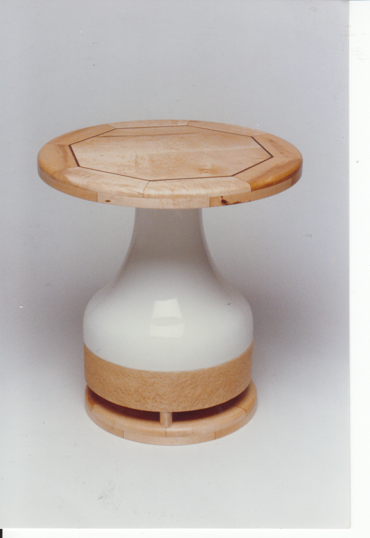

I am still deciding. Ideally for my current listening room, I can fit 30/cabinet, but I might go 25/cabinet, so I can drive them around and set them up in other rooms with standard ceiling heights. Either way, I would use my current arrays (16 drivers/cabinet, 60" line) for surround sound, although I would redo the cabinets.
This concept really has a lot going for it, as Linkwitz calls it "direct-to-reverberant sound ratio." I hear a lot of my room with my point source Avebury system. They still have the edge on upper range detail, but my current arrays are getting closer the more I tweak. The Vifa does have a smoother high end compared to the NSB drivers, so we will see.
It is also worth noting that my Avebury has a 11" x 18" foot print and can go down to 25 Hz - impressive for a single 6" driver. Yet, Ronald's Two Towers is capable of 17 Hz, and it has a smaller foot print!
I really think more people need to hear these line array designs. My NSB's are pretty impressive given the cost of the drivers and the terrible cabinets. These arrays have turned out to be the funnest and most tweak-able systems I have ever had. The experiment became the main system. I would show them off more, but I am too embarrassed to. 😱
