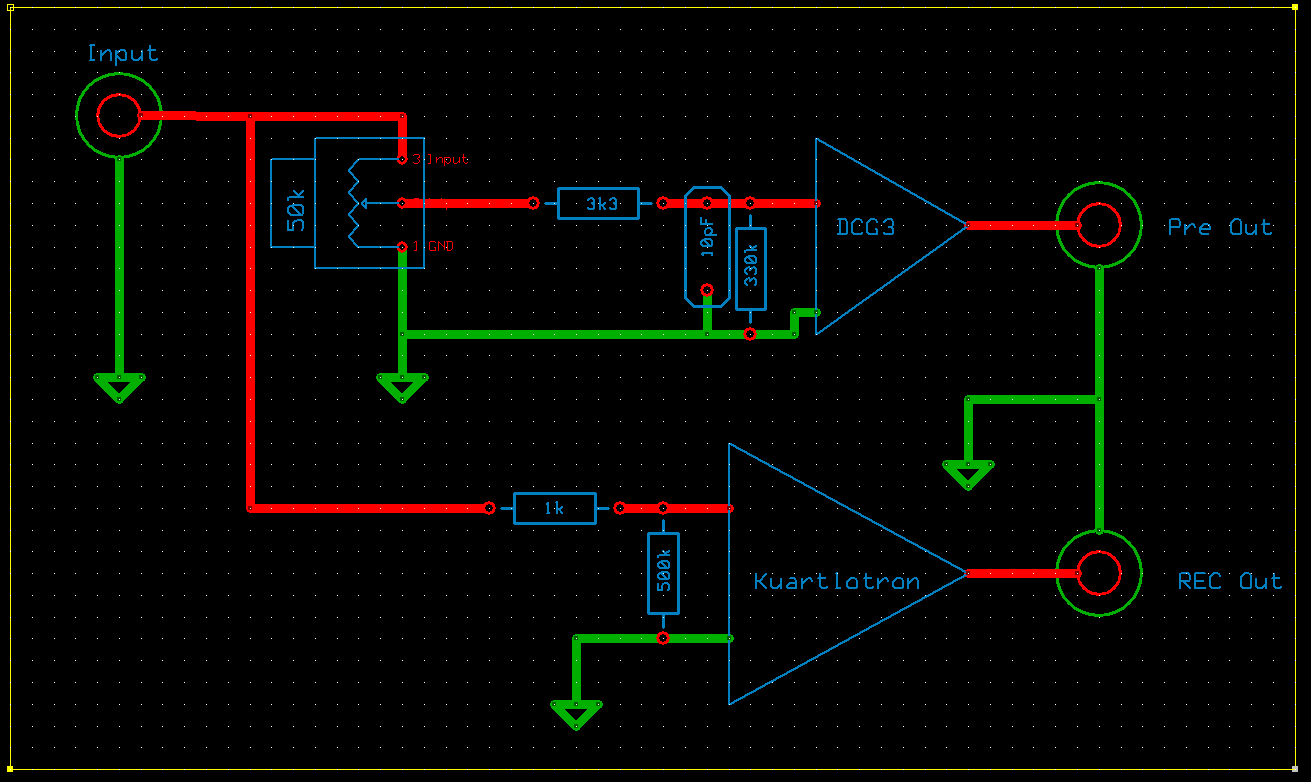

Hi Anthony
I am going to use your kuartlotron buffers in my new preamp.
These buffers will be used for the tape recording output so they will be connected directly in parallel with the preamps inputs.
These inputs are also connected to the volume pot and to the DCG3 preamp from Salas.
Now, the pot has 50k ohm
DCG3 has 300k input impedance
I would like to increase the kuartlotron input impedance to minimize it's inpact on the overall input impedance for the preamp.
Can I increase R8 to 500k without having issues with the offset ?
Should I also include a series resistor in the input to avoid interactions between the two circuits connected in parallel ?
I am working on the layout I will post later to clear any doubts about the connections.
This is what I have in mind:
As long as the Kuartlotron input has a DC path through the 50k pot to ground which doesn't get disconnected, you will be fine. 500k alone could cause a lot of offset. But with the 50k pot there, you don't really need the 500k unless you plan to disconnect the two circuits.
