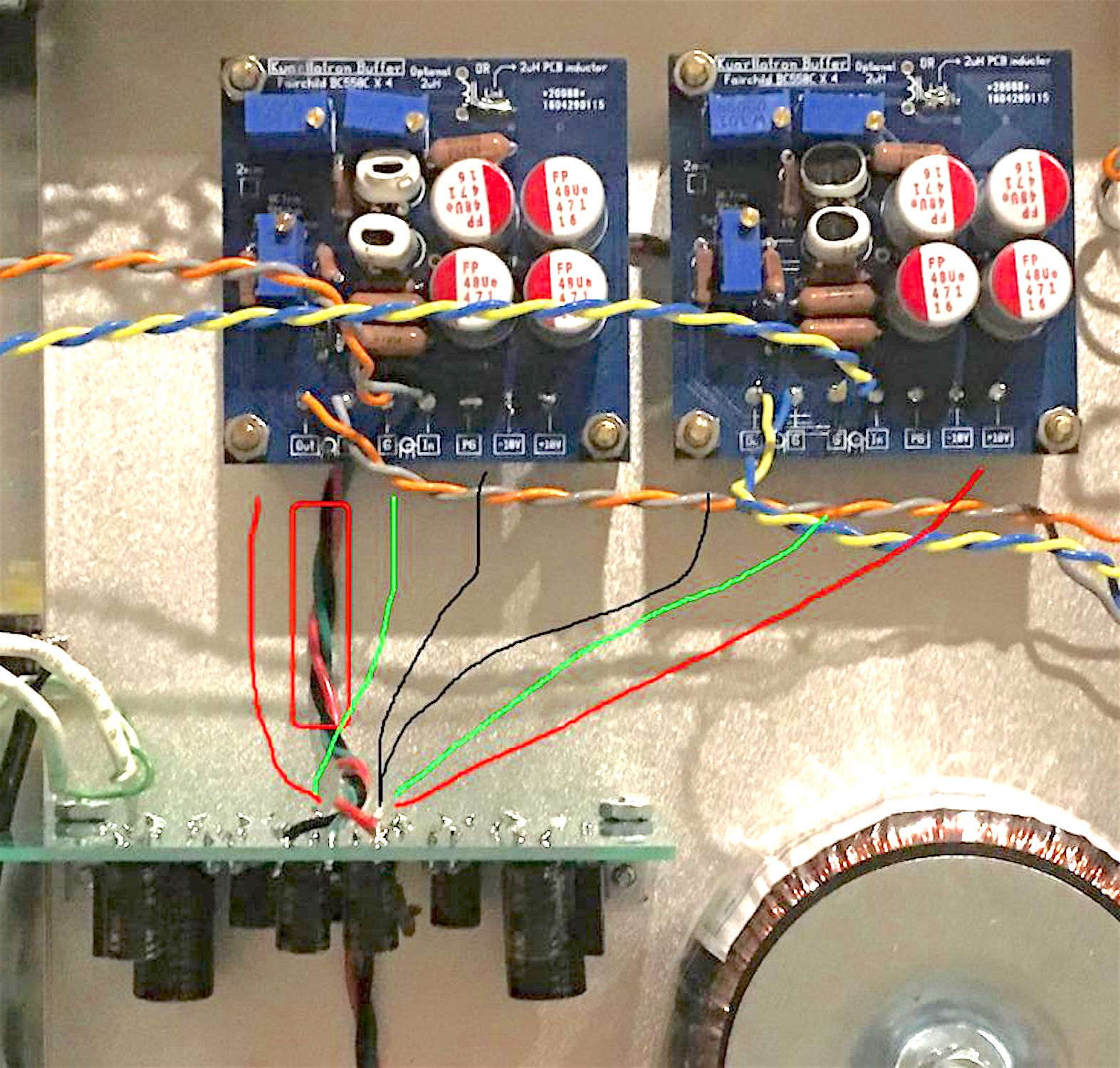

I have copied and cleaned-up a picture from an earlier post.
Examine the polarity of the four elcos on each board.

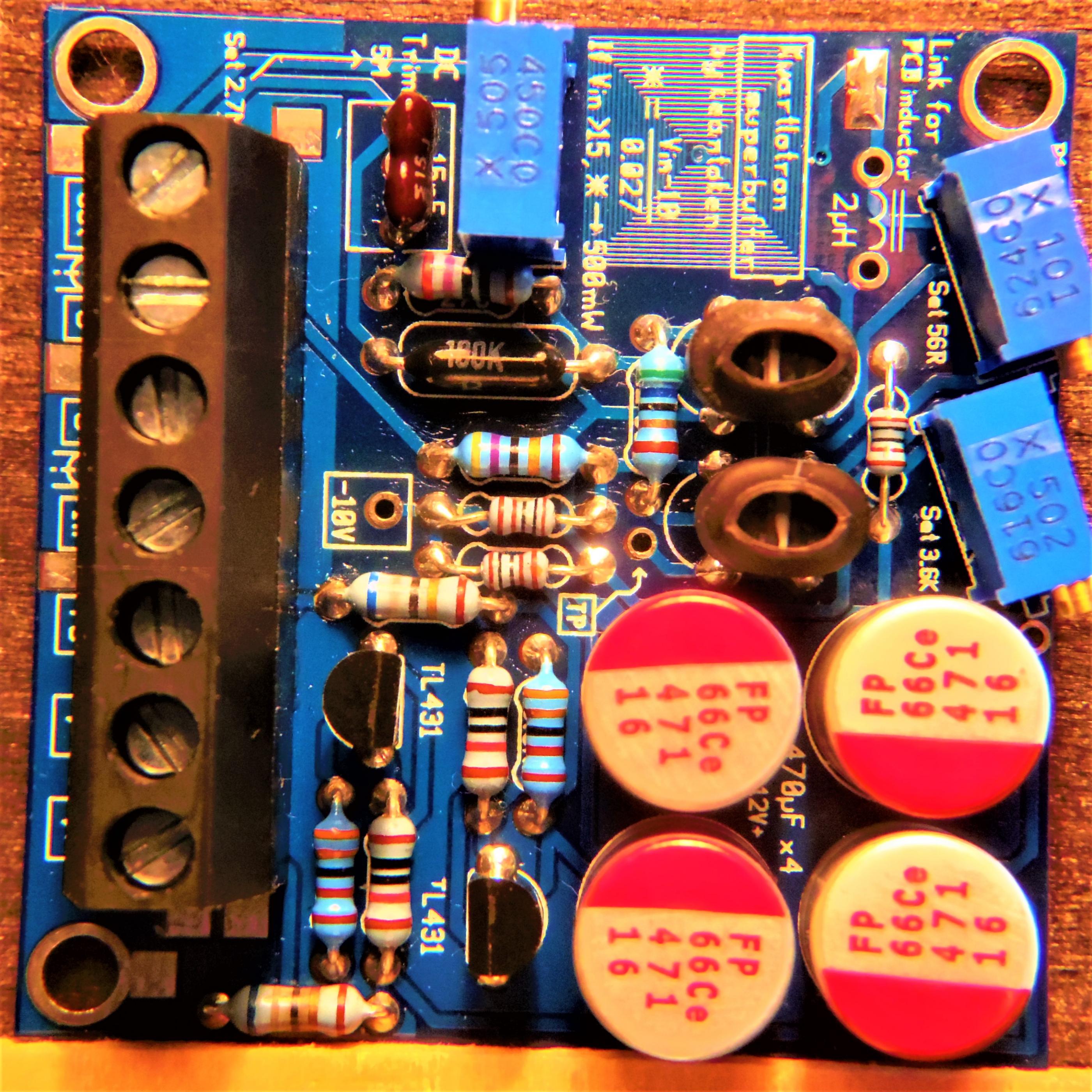

Now that I have the transistors off the board, is there a way I can check the output of the regulator if I power it, without damaging the Kuartlotron?

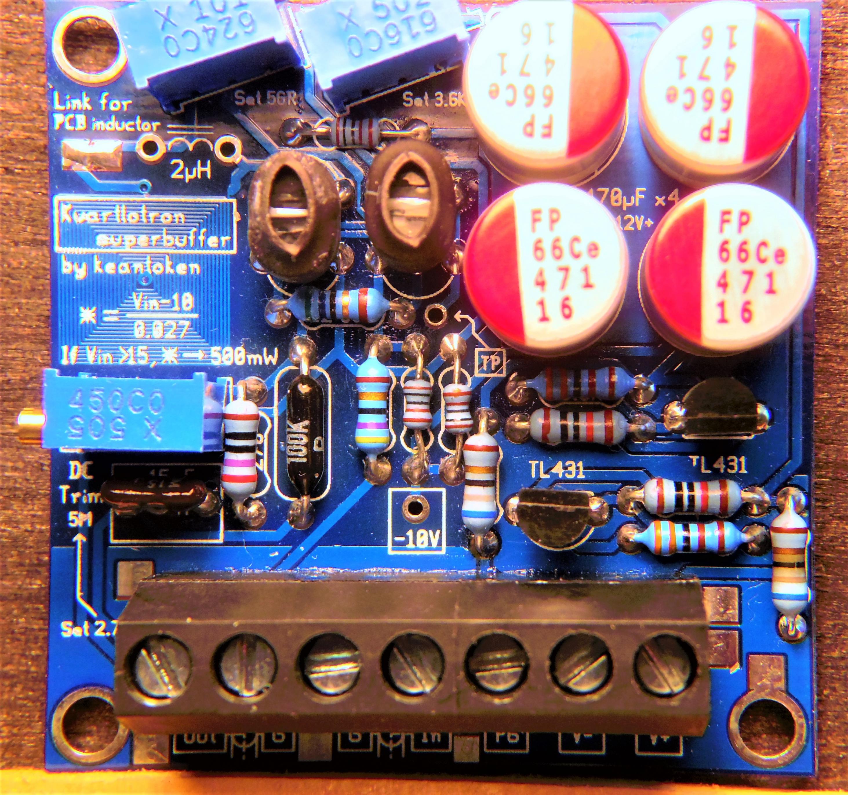

Photos of the board attached:

Yes - I swapped this resister, and both regs with the ones on the second board which is a working board. The resistor measures 68R, and it with the regs installed on the good board are working, but the known good parts from the working board exhibit the same problems when installed on the non working board.

Can be just a problem on the PCB, a cut off track or a bridge between two tracks!
I have inspected the board thoroughly with a high magnification eye loupe, and did't find any cut traces, or solder bridges.
I don't know if you read the whole thread, but it is possible that I reversed power ground with V- on the initial start up. I am not sure I did that, but it's possible.
It is possible that vias haven't connected between both sides of the board due to manufacturer defect, but this should not be a problem if both sides of the board are soldered to the lead.
At this point I would measure the resistance of all the resistors on-board. It looks to me by your transistor voltages that the Kuartlotron section is fine, and that the problem is in the regulator section.
