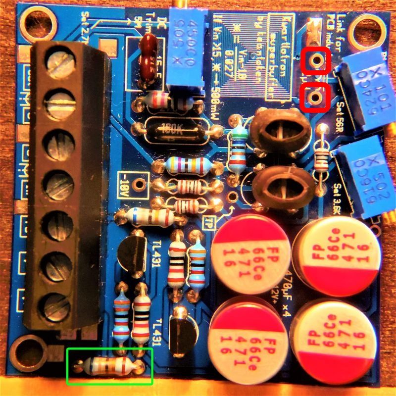

It is not certain that it comes from there but it does not cost anything to test.
With a tester to continue (beep) between the two holes circled in red the measurement must be able to be tested.

It is possible that vias haven't connected between both sides of the board due to manufacturer defect, but this should not be a problem if both sides of the board are soldered to the lead.
At this point I would measure the resistance of all the resistors on-board. It looks to me by your transistor voltages that the Kuartlotron section is fine, and that the problem is in the regulator section.
All my solder connections are solder to the leads on both sides of the boards.
I checked every resistor on the board including the trimmers. Everything is within spec. except the 10K resistors which give a reading that rises. Is this because the they are in circuit with the regs? Also I removed the caps. My DMM only reads capacitance to 200 uF. but charging/discharging test with DMM indicated they are good.
Inductor holes show continuity (beep)
With the transistors, and caps off the board are there any tests I can do with my DMM with the board powered?
I just reordered most of the BOM from Mouser, so since half of the board has already been stripped of parts, that might be a good idea rather than putting a bunch of new parts on a questionable board. Yeah - please send me a new board, and PM me the bill.

Received the new board, but didn't use it. With some new parts I was able to get the problem board up and running. The Kuartlotran is sounding great in my system. Thanks for all the help with solving my issues.
