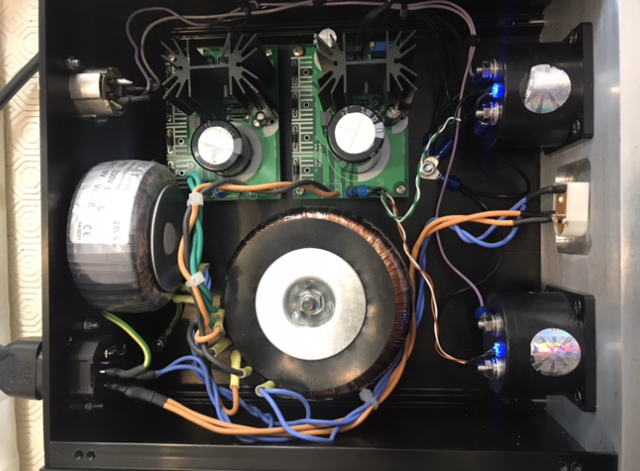

Re-capping the electronics is a waste of time, all caps on the electronic PBC's except C2, 4 & 6 on the Drive PCB are bypass for the electronics and will in all likelihood be good.
The PS by will need new electrolytic caps if it has not been done.
The purple Panasonic caps used in the SP-10MKII are generally regarded as average quality and are definitely past their useful life at this point. Most of these will show the tell-tale expansion at their bases.
C227 lives a hard life and 9/10 times will have physically leaked, and 8/10 that will have eaten away the traces on the PCB. If that has happened note that the through hole is also a via and repair accordingly.
C106 and C12-C17 are not bypass caps and the latter can lead to performance degradation of the drive.
Usage and environmental conditions play a significant role in how well these caps age. For units that have lived in hot and humid environments I routinely see green legs on at least half the caps in the motor unit. Similar for high-use units. And of course a capacitors health cannot be ascertained by physical signs alone.
Were these Elna's my advice would be different, but there is overwhelming evidence that these caps are on borrowed time.

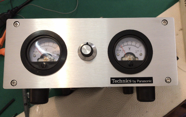

Using the 140v line is a great idea, I use it myself for an extra 32.5v supply fed in thru the power lead which means the control and drive pcb no longer share a supply.
