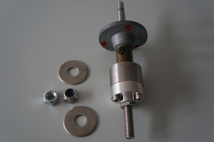

from the Sony TTS thread but may be of interest here,i made a brass ring to strengthen the bearing housing area,if it does anything remains to be seen.

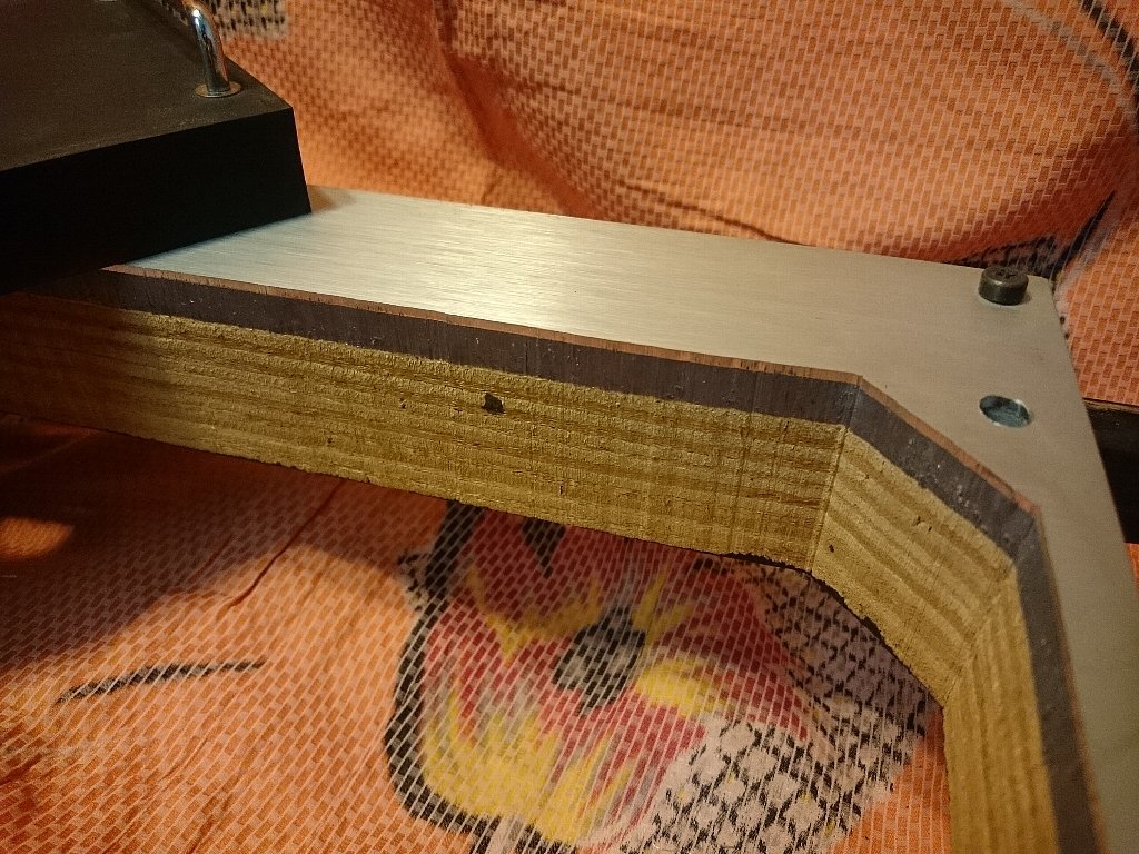

ive tried a few armboards, acylic,mdf/aluminium,ebony and panzerholz and also the tonearm bolted directly to my plinths panzerholz top plate,
the best by far and what i still use today is a CLD ( constrained layer damped) aluminium one.

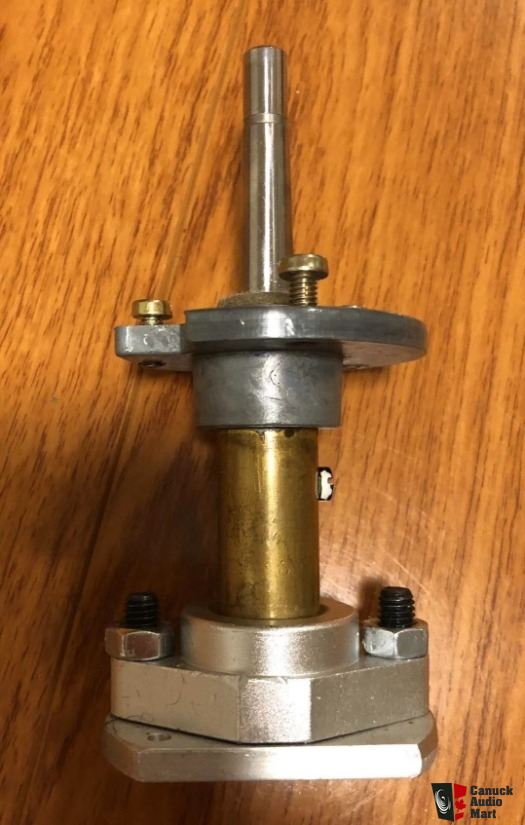

I have only seen images of the SP10 Mk II metal pressed/cast bowl that the motors stators are mounted in.
From the DD TT's I have stripped back, the SP10 Bowl is looking to be the most substantial in relation to the Wall Thickness.
The Base of the Bowl is also Quite Shallow in comparison as well.
The Bowl does have a additional form protruding from the Bowls Base.
The protrusion serves as the Bearing Housing that is seen at the lowest end with Threaded Cap.
The Threaded Cap extends to being being lower that the electronics PCB's.
Forming a piece of lead or using a Split Brass Ring to encapsulate the Threaded Cap and then incorporating another part that can clamp the lead/brass in place, as well as serve as an Anchor Point for a brace does not seem too awkward to achieve.
There will be a variety of ideas about what the Brace Material can be and how/if it should come into contact with the Threaded Cap.
A similar thought process can be put in place to decide the best methods for the lowest Anchor Point for the Brace and how that lowest Anchor Point should be coupled to the local materials.
The lead and brace working in conjunction with each other could prove to be a very useful modification on a standard Plinth Mounting for a SP10 Mk II, where improved rigidity for the Bearing Housing and the soaking energy away from the bearing housing is wanted.
The Link will show a off the shelf part that when the correct ID is selected can be used as the Clamp on the Threaded Cap.
An additional Plate can be produced with a Threaded Hole to be fastened to the Flanges.
This plate will serve as the Anchor Point for the Brace.

A quick description of details of the CLD aluminum and maybe a pic would be nice.
Thanks,
Don
An arm board is not CLD. CLD is 2 pieces of thin sheet bonded with a viscoeleastic center. Approaching 4mm total panel thickness CLD effectiveness drops exponentially.
An arm board would be MLS (multi layer structure). This is where different materials of slightly varying Acoustic impedance and thickness are bonded together.

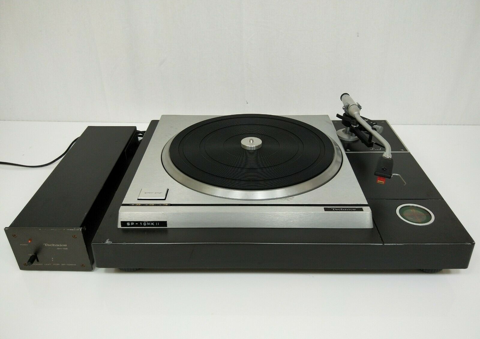

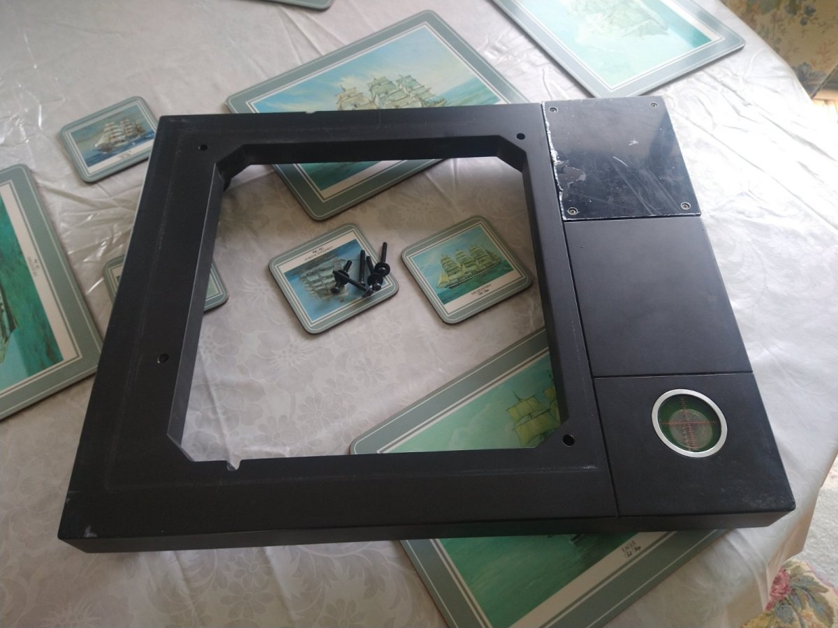

BTW, I found some pictures of the Lead Console SP10 mk2 plinth. I don't believe they use pure lead or the weight would be much greater than typically quoted. I have seen them come up occasionally on eBay. I have never been tempted though.
One of my first SP!0mk2's came in a Lead Console plinth. The plinth is cast impregnated resin and quite heavy. The arm board is 10mm thick solid lead. This plinth is open on the bottom.
I then made the resin/bento plinth for my other SP!0 and the resin/bento plinth was far superior.
