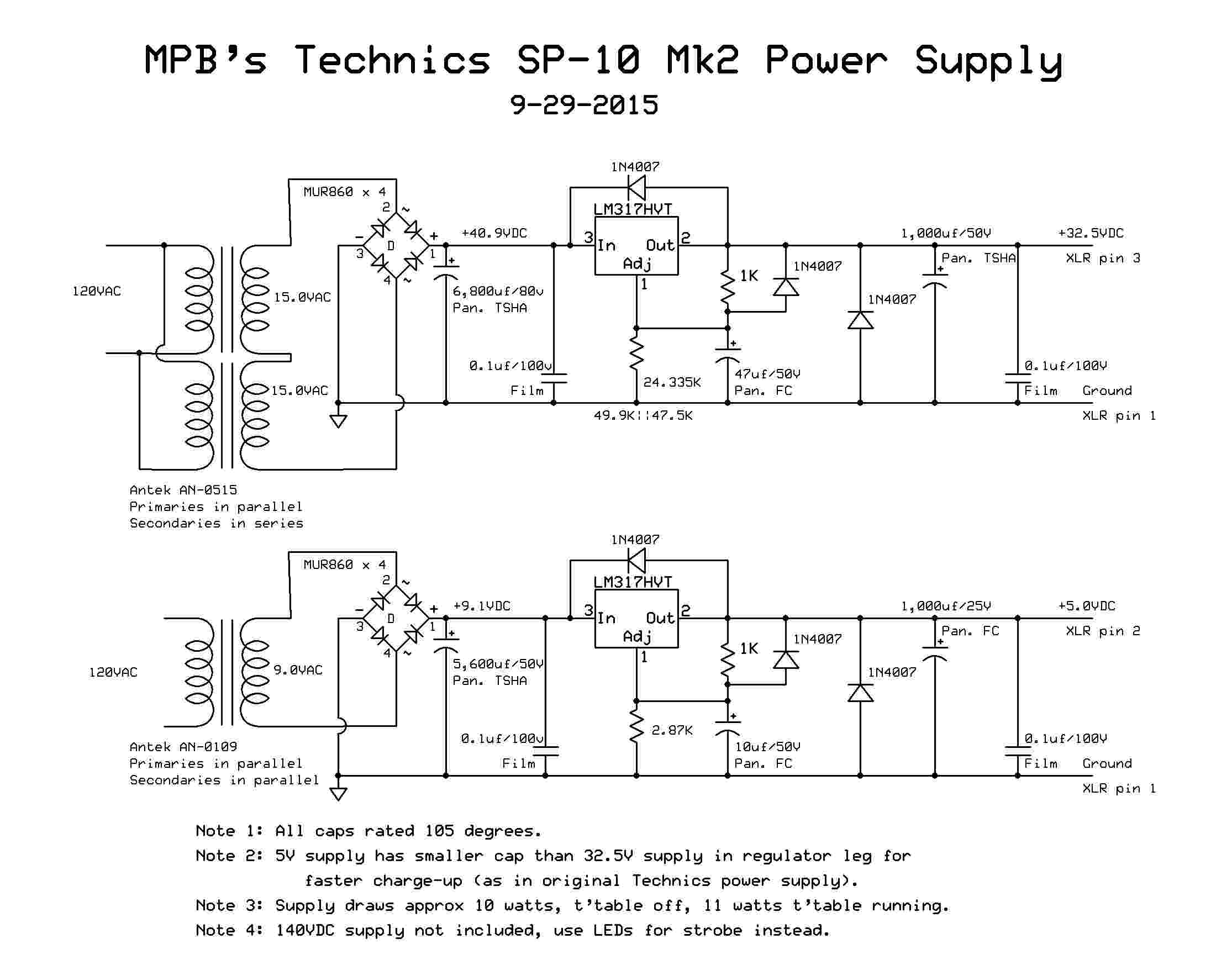

I have an SP-10 Mk II that I restored a couple years ago. At that time I replaced all the electrolytics and adjusted PLL according to the service manual. This table was saved from a radio station (along with one that went to 6L6) and did not have a power supply. I built a PSU according to the schematic from MPBarney (schematic attached). It delays the timing of the 32 V based on larger capacitor in the regulated section. I also replaced the strobe with LEDs as per MPBarney.
The table worked perfectly for many months. The speed stabilized and the strobe stabilized almost immediately. The table sat unused for several months as I waited for a repair to my cart. When I re-installed the cart and started using the table a couple weeks ago, I am now getting a slight delay in speed stabilization. The strobe jumps for 1 - 2 seconds and then stabilizes.
Before I take the motor unit apart, I thought I'd seek advice. Does this behavior indicate a problem? What is the likely source of the problem?
I replaced the caps with a mixture of Nichicon MUSE, Elna SILMIC II and Panasonic FR and FC. I realize now that the recommendation is to use Panasonic FC in all positions. I can easily go back and change the caps if it's recommended.
Thanks for your assistance.
p.s. I completely agree with the assessment of this turntable. It's performance is superb and I have not yet upgraded the platter or added something like a Tenuto platter mat. Cheers.
