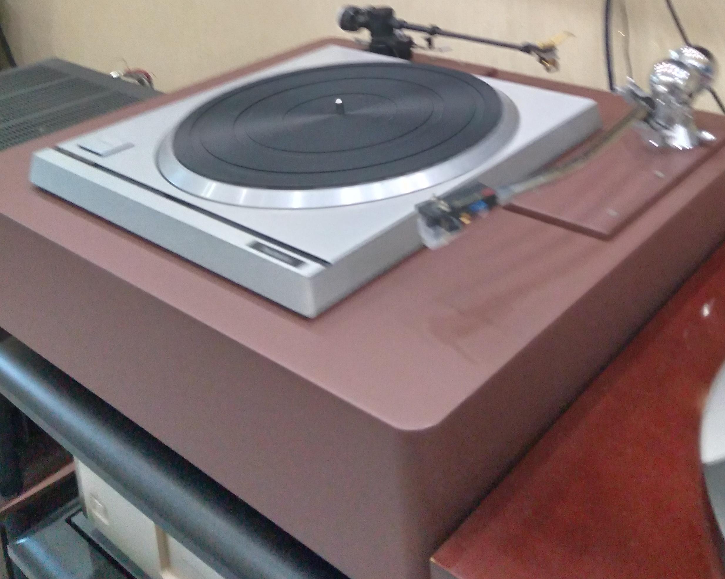

Correct his 10R is stock, it's only the mk2 that is in the Kaneta plinth.
I was doing some testing of my servo linear arm with a stethoscope and decided to put the stethoscope on the SP10mk2 OEM platter. One of my spare SP10's is stock in a resin/bentonite plinth.
Putting the stethoscope on the platter mat and tapping the platter, chassis and plinth ringing was clearly audible.
Doing the same tap test on my SP10 in the Kaneta with POM platter it was totally inert just a very dull thud no matter where I tapped. This is why the POM platter and remote motor mounting makes such a huge improvement.

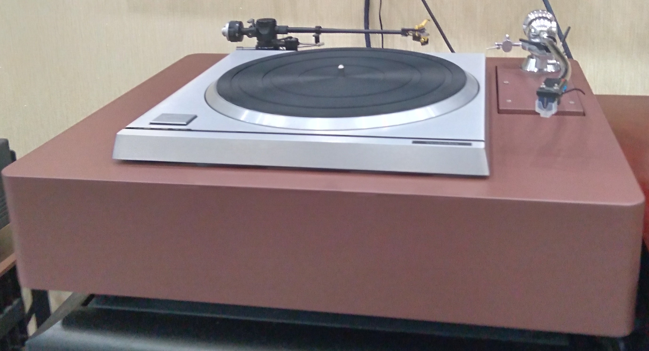

Hi Don.
The reason is simply concern for my substantial investment. The thought of de-constructing a mint, near new 10R, is just a teeny bit daunting.
I had a few mk2 in average/poor cosmetic condition, so choosing one for the Kaneta project was an easier decision.
Based on my considerable time with the Kaneta mk2, I am confident doing the same with the 10R would blow my mind. The reason Marc Gomez of SAT selected the 10R as the basis for his turntable, are well documented.
Don't get me wrong, the 10R is a great turntable, but mine is covered up next to the Kaneta mk2. With the Kaneta mk2, every LP reveals details that I never knew were there, even on the 10R. I have paused testing because listening has become so interesting. It has got to be connected to lowered noise floor, resonance control.

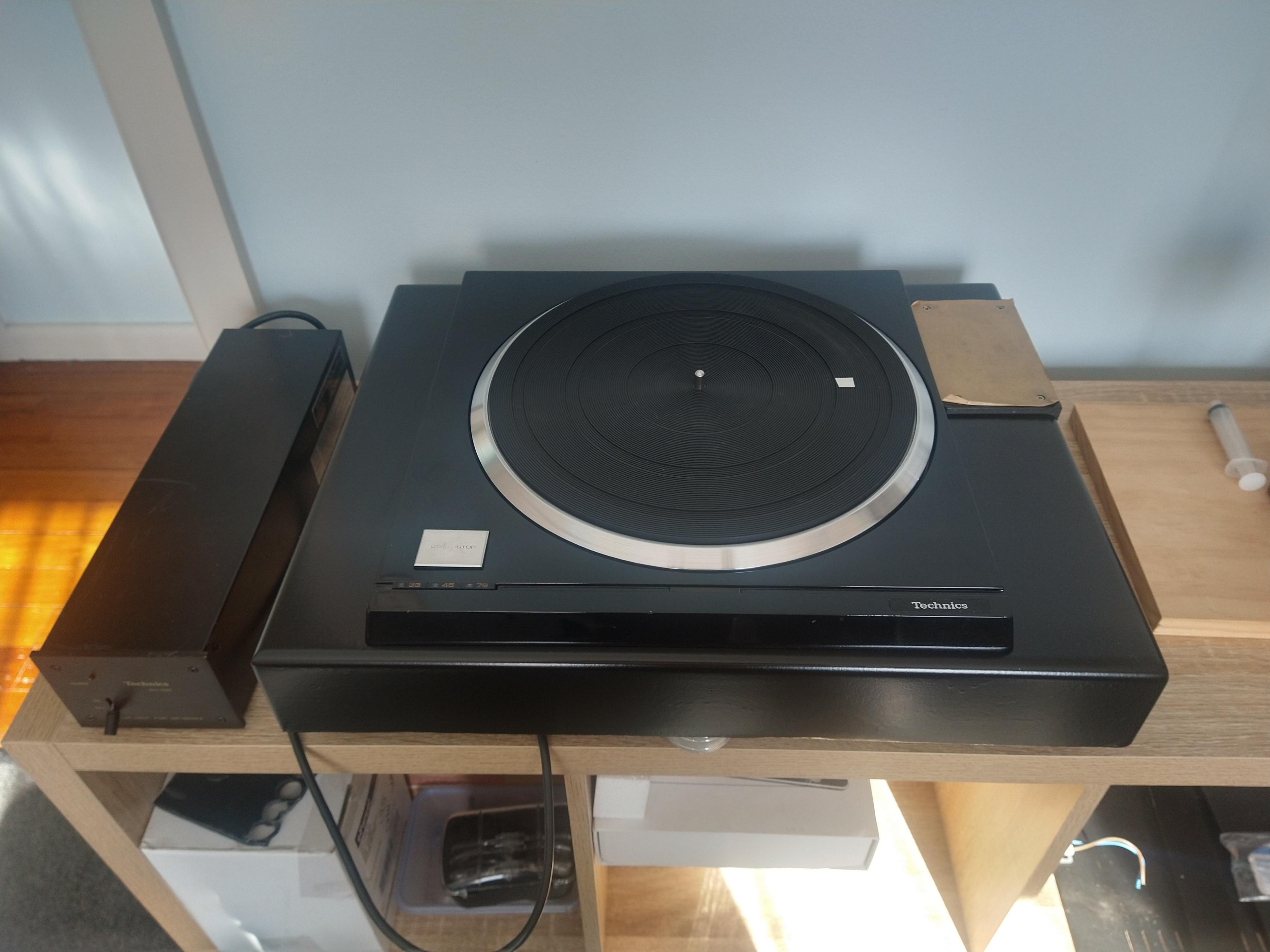

Good afternoon! Many thanks to all the members of the thread for the very interesting stories about this device ... They helped me a lot in my work. I changed the quartz to a higher quality one ... If anyone would like to post a photo ...
Hi micgum1967
Welcome to the Thread, there has been quite a few contributions recently that can be quite infectious.
IMV any of your experiences are welcome to be shared.
I am being guided by a friend, and we are in the early stages of arranging for the recreation in the UK of some of the projects carried out by warrjon.
