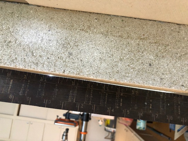

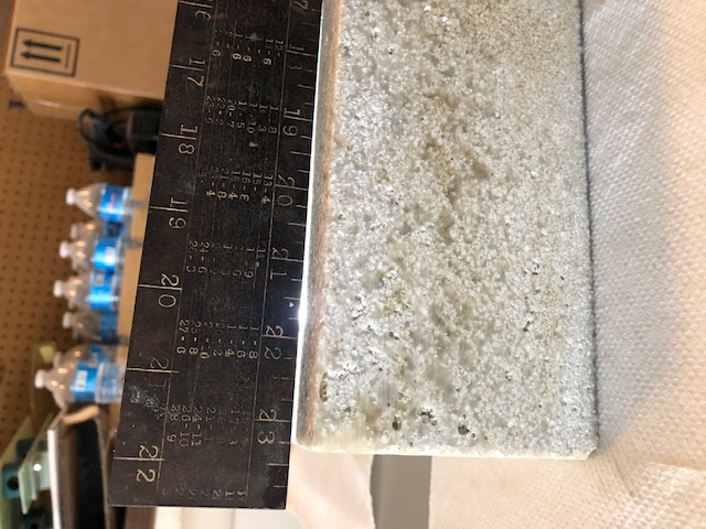

Concept worked pretty well but I used 1/8in Al which is a little bendy. A really flat table is key to the hole thing. I tried to make up for mine by having 4 2x2in Al tubes which held it pretty straight. You can see only two of the tubes in one of the pull pics. My table is cr__. That will get changed on the next casting. Another reason for the tubes was to get ventilation under the mould. I believe it is possible to get it near perfect (less than a mill) across the whole thing. You probably understand better than I how to do this. I was really surprised how hot it got. Almost too hot to hold your open hand on it.

With the heat from the curing, I am surprised the Al plate did not sag more.

I am not looking forward to drilling the hole for the TA through this stuff. 25mm thick between surface and cavity. Grr....
Be prepared to throw away your drill bit. Bento/resin is unkind to tooling. I use a wood spade bit for the larger holes.
Concept worked pretty well but I used 1/8in Al which is a little bendy. ....

surprised
"With the heat from the curing, I am surprised the Al plate did not sag more."
I think I got lucky. I checked flatness yesterday and the most out of plane I got was 0.5mm. That was at the back left corner. Anything else less was less than that. I put a light behind the straight edge so I could really see it. I don't know if I should even try to mill it. I think I will see how things go on the bottom and pick my poison for perfectly level.

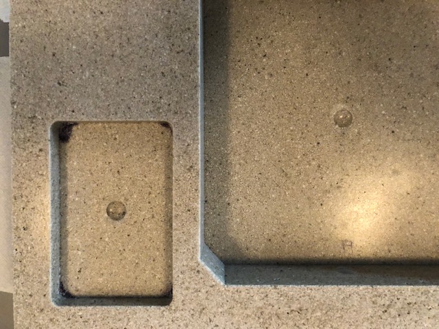

I am totally excited about the TA recess. It is perfectly flat and level with the top surface at 19mm recess. Not sure how it grew from the 18mm mold. ??? The black markings in the corners is felt pen ink transfer off the mold that I had marked to identify the corners to mill.
Looking closely at the top surface, I am surprised it is as good as it is. And the corners and edges are in great shape. Nowhere to go but down from here. Better not drop it.
