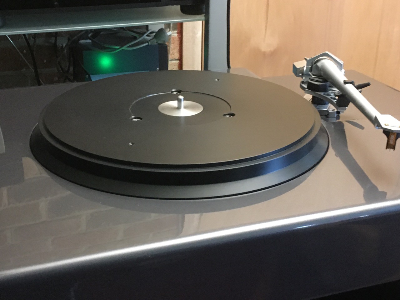

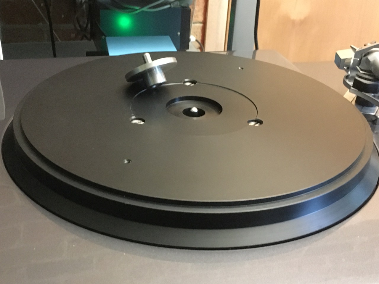

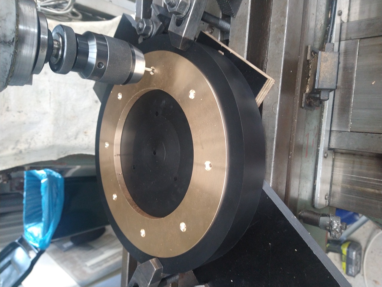

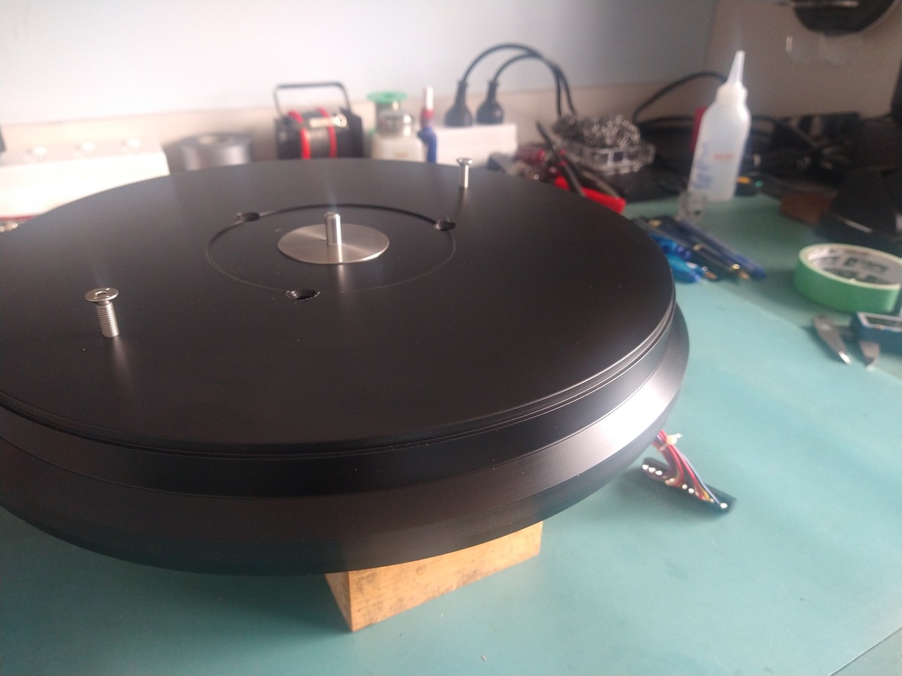

I strongly endorse this opinion. Together with warrjon, I have been undertaking a relentless improvement to the mechanical aspects of the mk2 industrial design. Ditching the OEM aluminium chassis, removing the electronics to a remote custom enclosure, installing the motor separately in a custom bento/resin plinth, replacing the Technics platter with a custom platter, has contributed to making it the best sounding turntable I have personally experienced, not withstanding the fact that I have owned an SP10R for the past 3 years. (see posts #1488, #1702). The latest iteration has installed a POM/gunmetal platter superbly produced by warrjon. The platter is a 40 mm thick POM layer, with a gunmetal base for stability, additional damping and moment of inertia. Words don't suffice to describe the improvement (otherwise we wouldn't need music!), but the comments I made in post #1702, are even more valid. The addition of a decoupled centre spindle has clearly audible benefits to noise floor and transparency. Warrjon has also implemented a bearing brace to improve the coupling to the plinth, but it is not yet fitted to my plinth. Bravo!

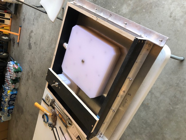

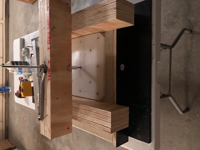

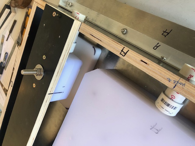

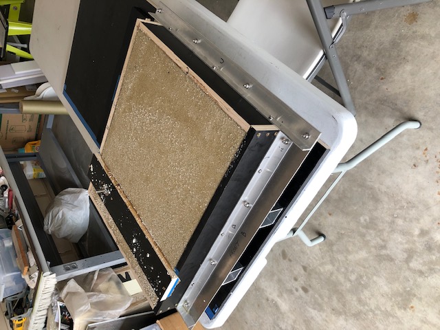

I did my plinth casting this weekend. All went well. Attached some pics. Some highlights, cast upside down, top of plinth/bottom of mold.
I made an aluminum mould bottom to dissipate heat. Worked well as quite a bit of heat is generated.
Total weight of casting material 24.5kg or 54lb,
cast 2/3 resin/bento by weight, 1% catalyst,
I broke it down into two back to back wet pours because of the difficulty in properly mixing everything. It is a very "stiff" and weighty mix. I actually missed it and had to do a partial third mix.
The board across the top with the bolt sticking up is the arm nut cavity. I wanted 100% resin/ bento for the tonearm mount 25mm thick as in Technics arm board. I set up the cavity mould to be mounted after the first pour to squish out material so no voids. Two screws.
One of the pics shows my mixing math with the scale. Kind of fun.
My plan is to let it sit for 5 days and then remove the cavity board and sides and then let it sit for 14 more days on it's face before I extract the displacement forms. They are HDPE.
Please weigh in with thoughts and comments. Especially the timing of the mould and displacement form removal.
Special thanks to Bon and warrjon who have done all the developmental work on this process. Could not have been done without them.

Looks good Don.
Be careful leaving the insert in, as the plinth shrinks there is a possibility of it cracking, I saw this happen to someone else on L/H I think.
Having the TA mounted directly to the plinth is a good idea and both Bon and my plinths are built like this.
This mix has a tendency to warp and will need a fair bit of sanding/filing and filling with polyester auto body filler. Make sure the TA mounting surface is parallel to the platter/plinth top. If it's not, as the arm traverses the LP azimuth will vary.

One other pice of information involves whether you care to have the bentonite to the very top of the casting (bottom of the plinth). The bento will sink and there can be a clear layer of resin 3 to 5mm thick at the surface. One way to avoid this is to only build your mould as deep as the casting you want - not any deeper. Then you can keep adding mix late in the pour letting the bento sink and the resin over flowing the mould. With a little work you can get the bento pretty much all the way to the surface. That's if you care about it.
Whatever floats your boat.
Don

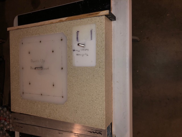

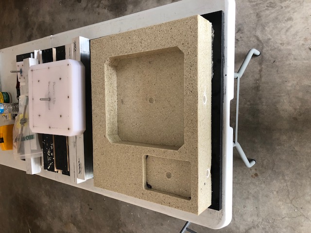

Attached are a couple of pics of the plinth insert pulls. I was shocked how ease they came out. HDPE (cutting boards) and mould release. Everything was basically a copy of Bon's methods. Thank you Bon.
Now for the hard part. Finishing it and setting it up to receive the TT and TA.
First step is to mill the bottom flat then the top to make sure it is perfectly flat and also the tone arm mount surface to make sure it is parallel to the TT surface.
Question, does anybody have any comments about cleaning the mould release off the mould. I worry about adhesion to it with the primers and fillers. There are numerous little cavities irregular in shape and depth. I am guess it is related to the bento and air getting trapped.
I wiped the surface with acetone and then gave the plinth a health washing with simple green.
Nevertheless I worry about adhesion.
Thanks again for all the great advice on this site.
You are welcome. It is gratifying to see that the instructions were clear and worked well for you.
Yes this part will try your patience. I would let the plinth "rest" for a while, then check the trueness again. Pulling the inserts out may cause uneven internal stresses to move it. It is not predictable. Some pours move, others stay rock solid.
Acetone should be adequate for clean up.
It looks like you plan to use an armboard. I decided that the plinth works best in its role as a vibration sink if the tonearm is directly bolted to the plinth. Admittedly this is restrictive and discourages use of different tonearms. I use epoxy embedded nutserts from below to receive the tonearm bolts. If you do use an armboard, I have used 6-10 mm acrylic with no noticeable quality loss.
