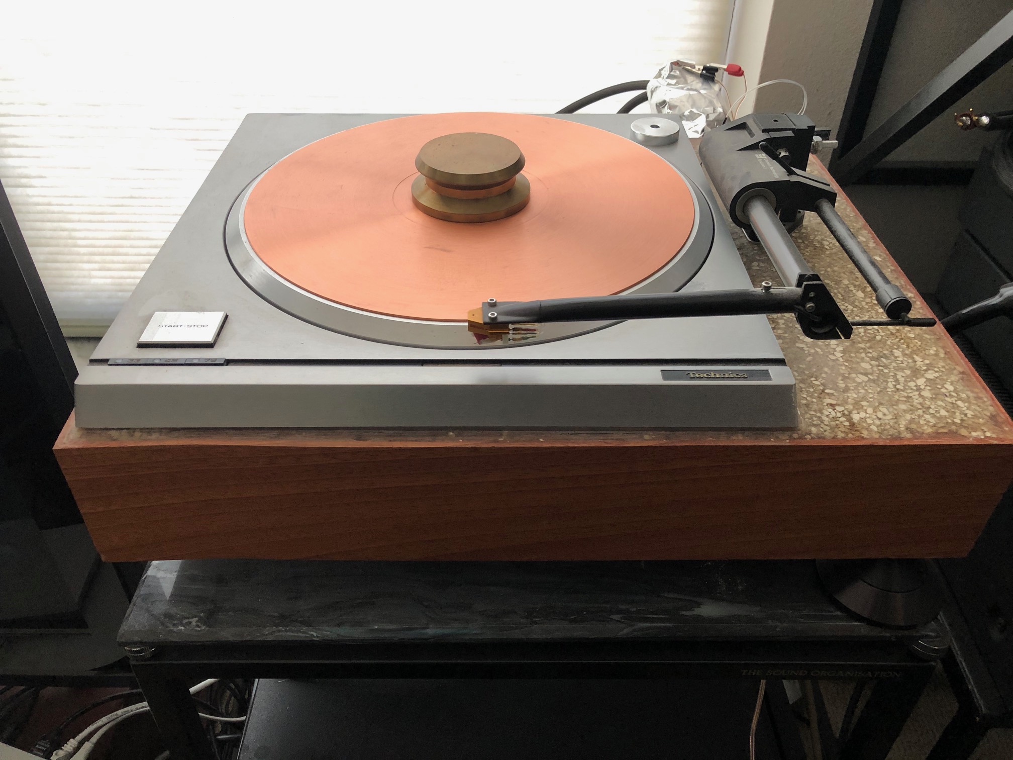

resin / bento mix
I made a plinth with the resin / bento mix.
I used hardwood strips for the sides of the mould, so no finishing would be needed. The top is the natural level of the mould, I did not sand it either.
Where I did sand was under the turntable where it it fits snuggly to the resin / bento surface so it was even. It is a very very hard material and I gave up sanding to level.
I used tape on the underside of the turntable and used small thin wood shims to level the turntable to resin / bento, then mixed up more resin and used a putty knife to fill the gap.
Cleaned up the surface as best I could before it cured.
It is not perfect, but it works and sounds great.
Removed the turntable and tape and remounted the turntable and mounted the arm, drilling holes where needed.
Hope this helps,

I like the Honesty to the Aesthetic of the Plinth.
Fair Faced Concrete is a much desired design/feature today.
Your work aligns with this feature quite nicely.
Good on you to be reserved in the cosmetic of the model.

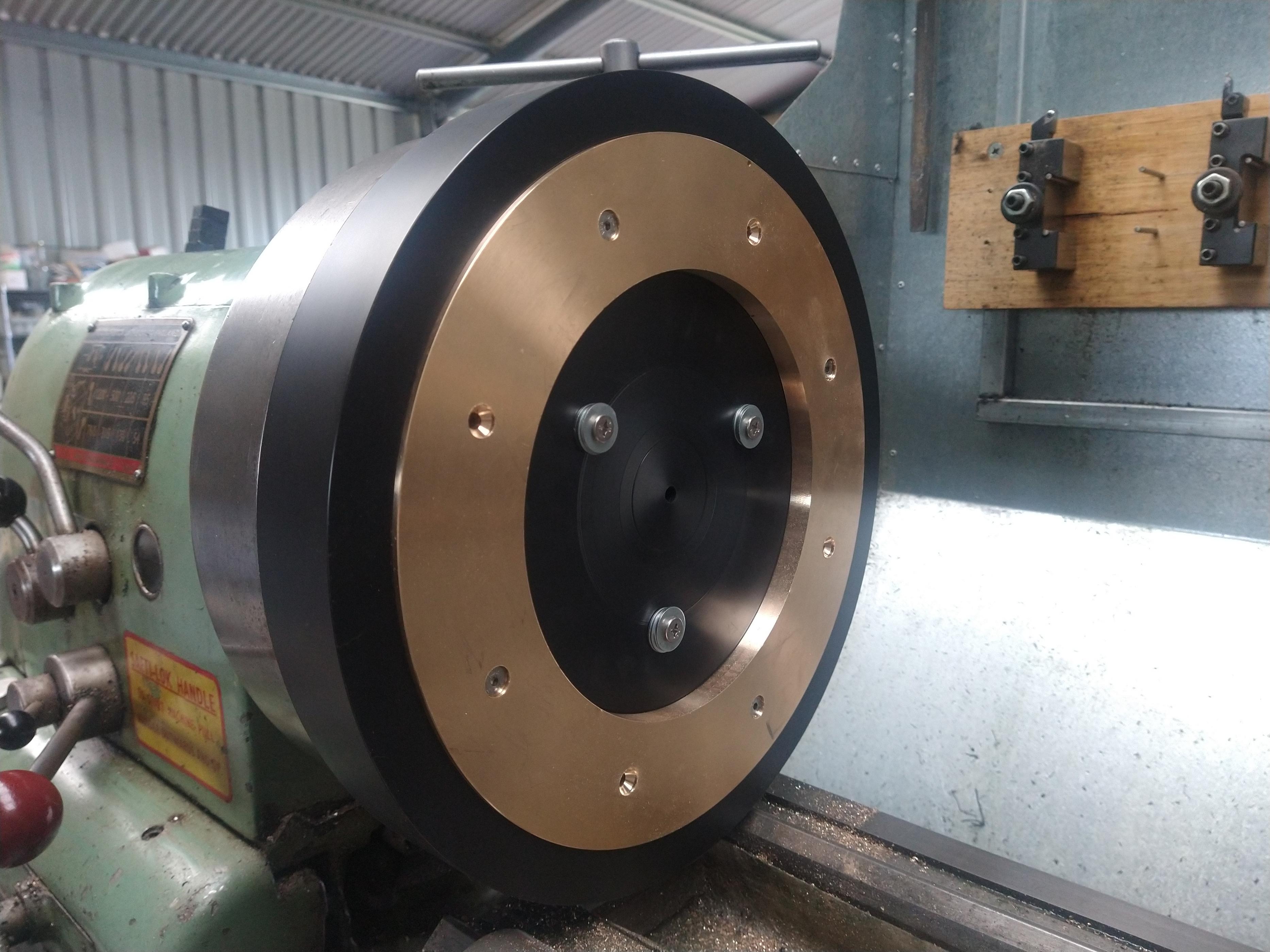

POM Platter

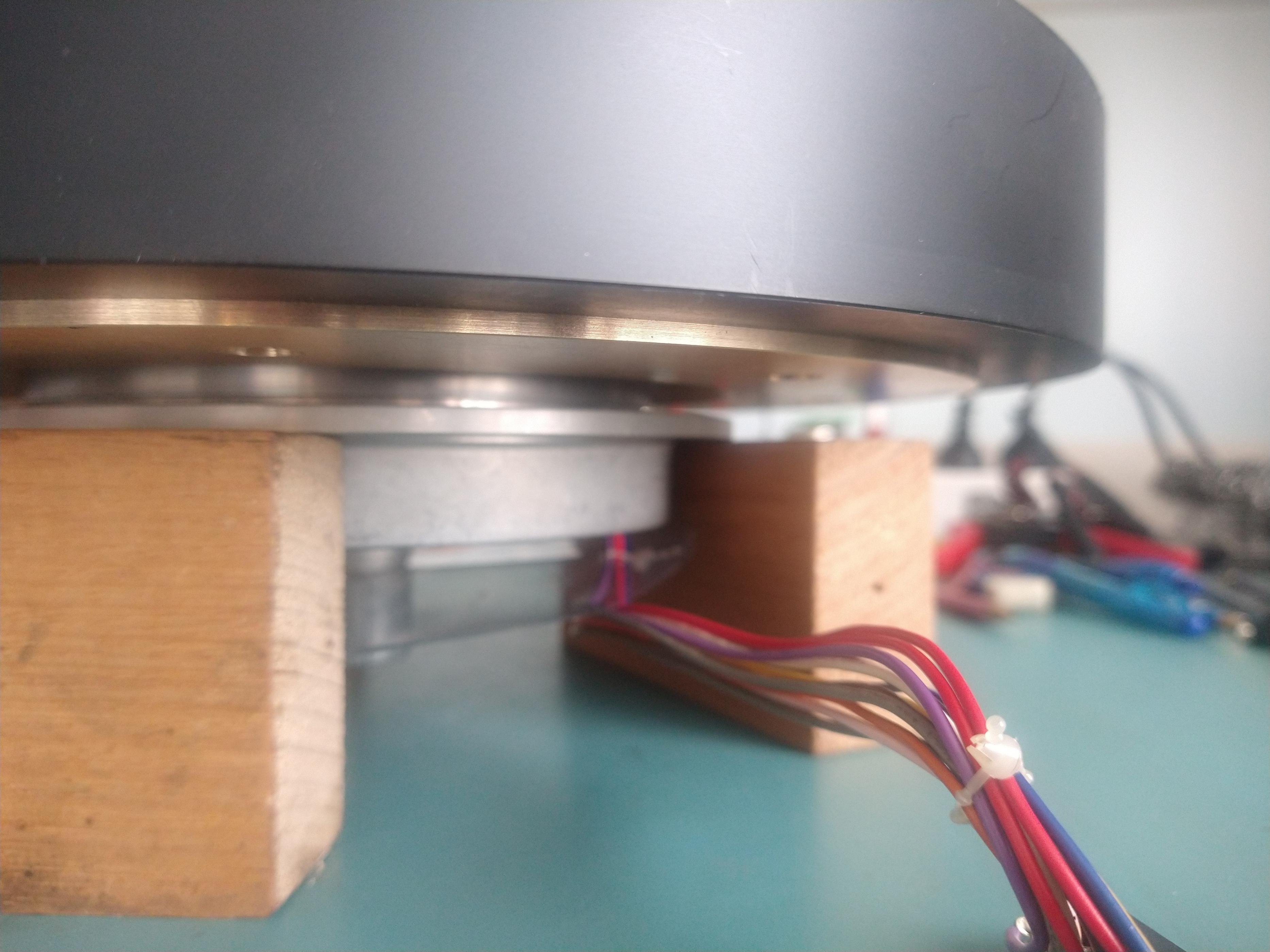

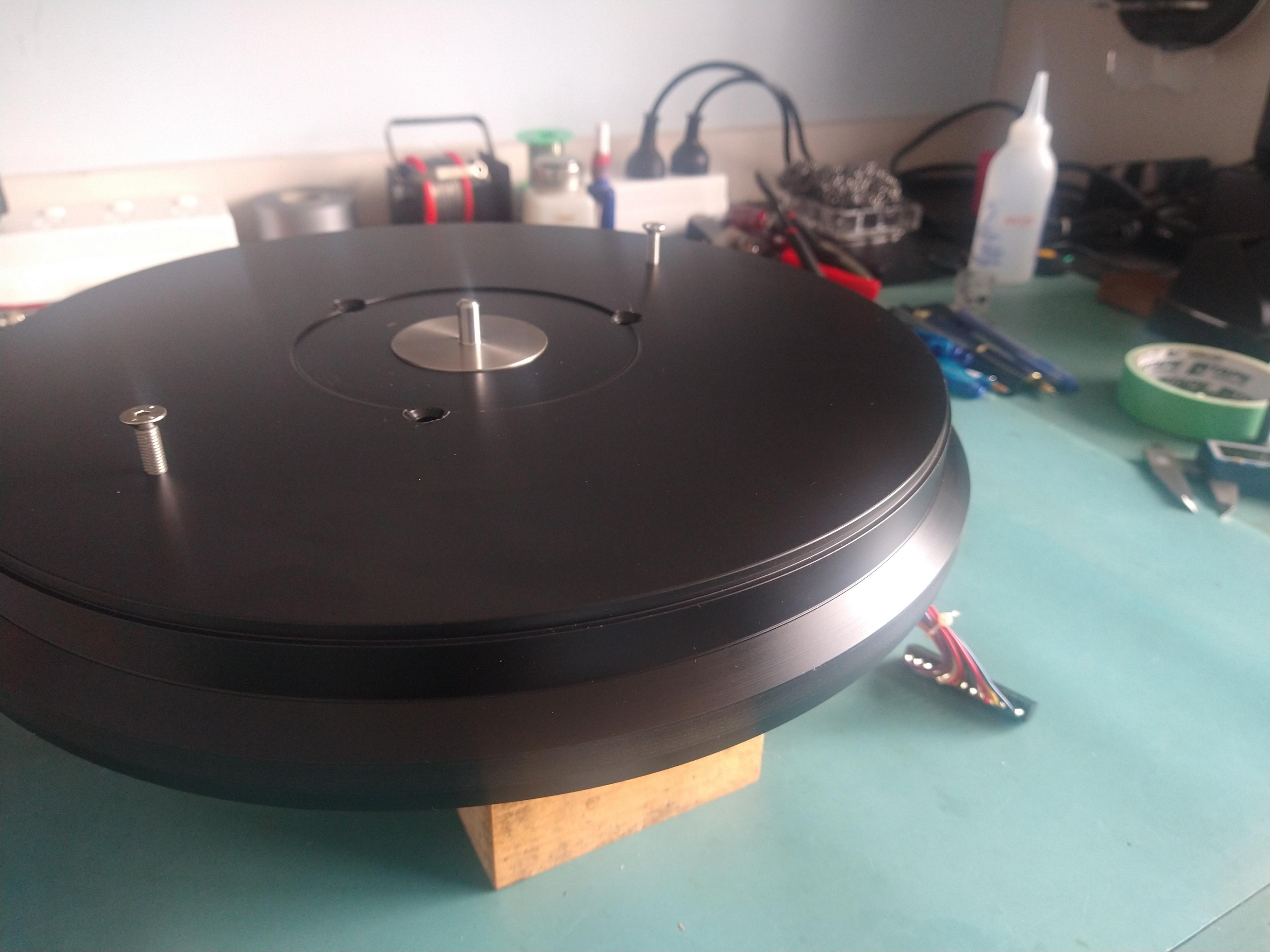

Another platter. This time 40mm POM with a gunmetal insert to lower COM. Removing the GM insert and this will fit a stock SP10 chassis with minor mods.
The POM sits directly on the motor and uses a secondary spindle so the motor spindle is isolated from the LP.
I had a quick listen last night and the results are promising.

It's only the outer lip where the outside of the GM is in the photo it's 35mm. That POM lip need to be reduced to 10mm to fit down the strobe recess.
However I'm not sure if in a stock SP10 the difference between the OEM/POM and the 40mm POM would be audible, I don't have a stock SP10 in a plinth yet to test it. It's definitely audible in a Kaneta plinth as the resonance control is far superior with the motor coupled directly to the Polybento.
I have another SP10 owner coming over in a couple of weeks I was planning on offering him a couple of platters to test in his stock SP10 setup and give me feedback.
