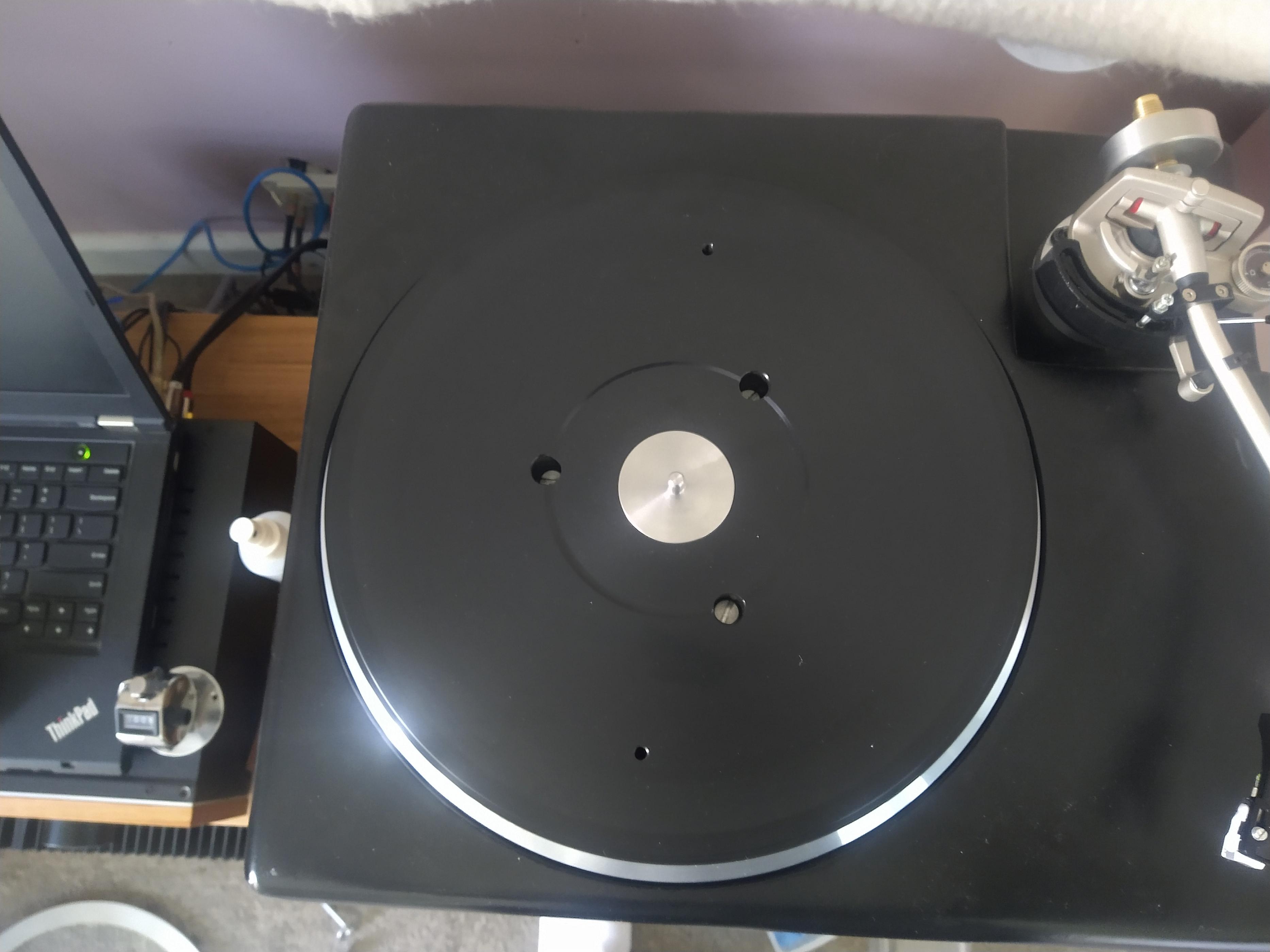

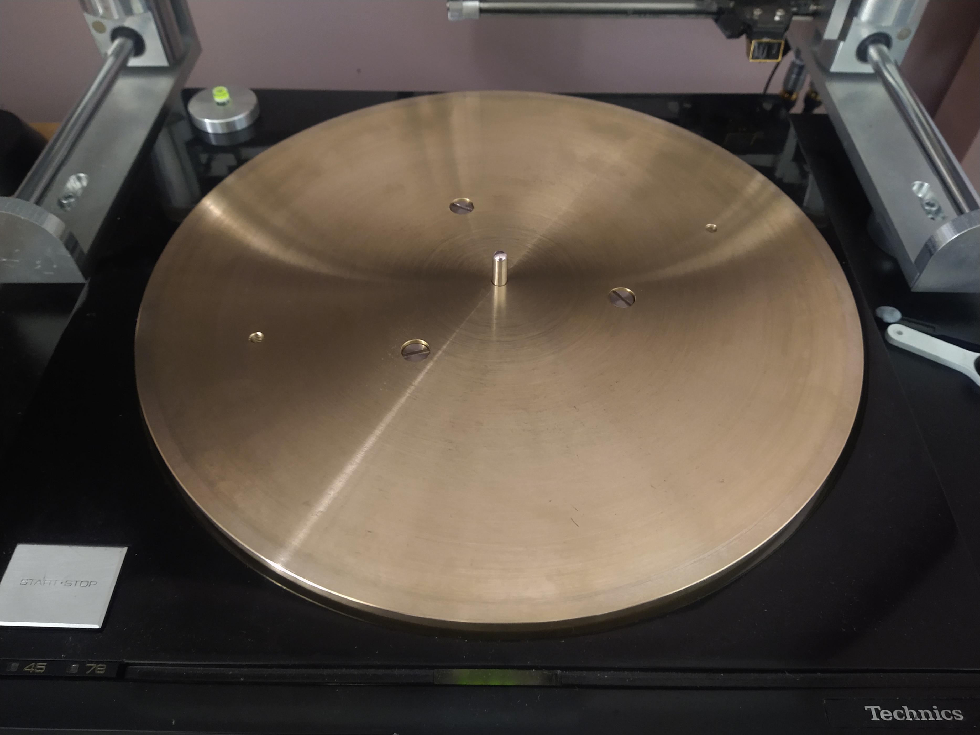

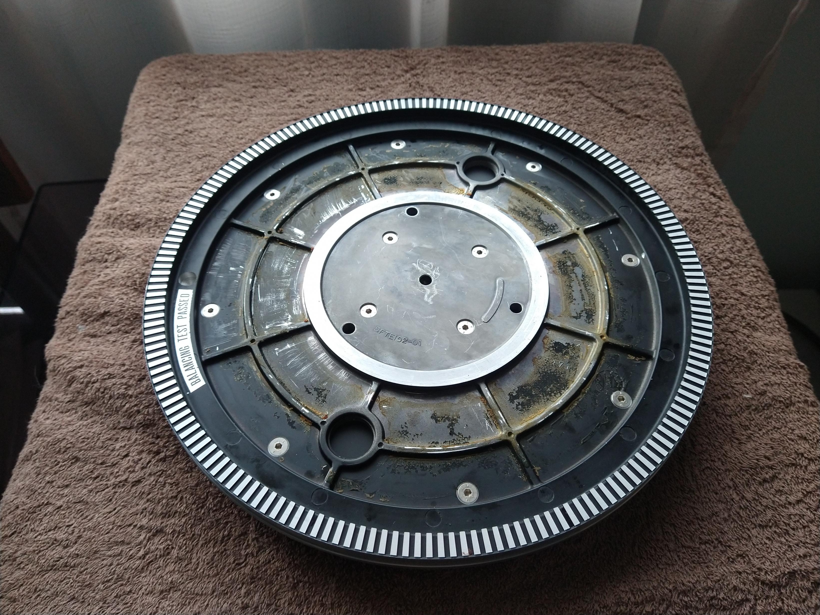

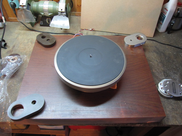

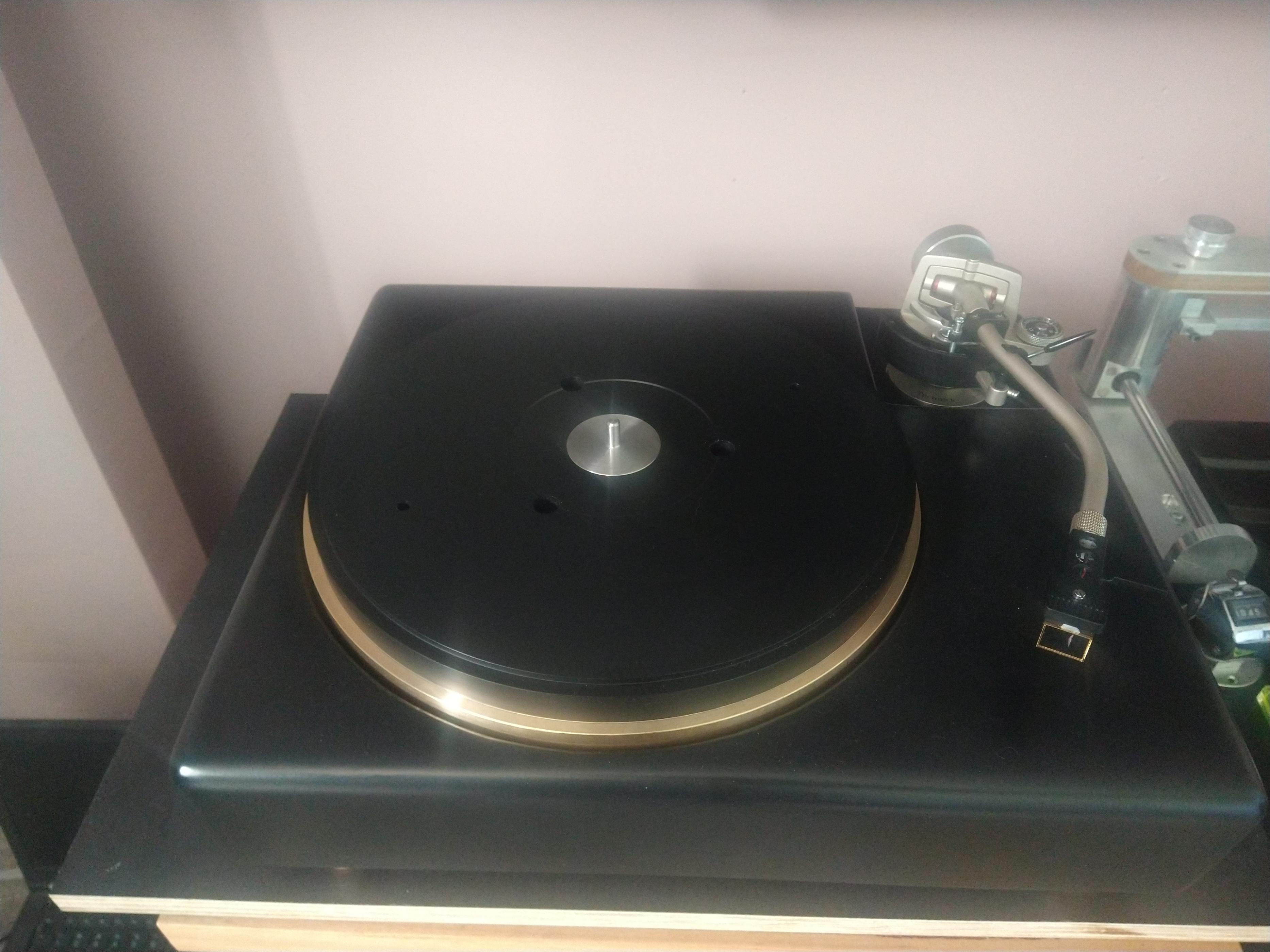

I made the platter and secondary spindle. I have done 2D CAD drawings of the platters. I made a plug and had the GM blanks cast but I have had issues with voids and impurities in the castings The GM platter on my TT is slightly smaller in OD because I had to turn it down to remove these voids. So I will not be making anymore GM platters.
I'm in the process of making 2 more platters. 1 will be 20mm POM bolted to an OEM aluminium platter and the other will be a 40mm POM with 10mm gunmetal insert in the bottom. This GM will use one of the bad platters but I will turn the OD to 290mm which will remove the voids.
Both of these are experimental.
I have 4 SP10mk2's and all of the platters the damping material fixed to the bottom has started to come away and has hardened, rendering it ineffective. This damping has been removed 20mm POM will be bolted to the top and Dynamat Xterme fixed to the bottom.
The other POM platter will be 40mm deep with a gunmetal insert in the bottom to keep COM low and provide a good mounting face for the motor.
Both of these platters will get a secondary spindle.

As I understand the electronic design the mass of the platter should be important. The weight of the subplatter plus the rubber mat and the upper platter should be the same as the new one. If you increase the weight of the platter it will have an effect on the speed control unit. The MKIII has a complete different speed control design. There are a lot of people using heavy platter on a normal MKII version and the bearing is almost dead. The small bearing mirror made of plastic is not usefull for higher weights.
May it is possible to design a top platter made of POM with the same weight as the original platter including rubber mat.

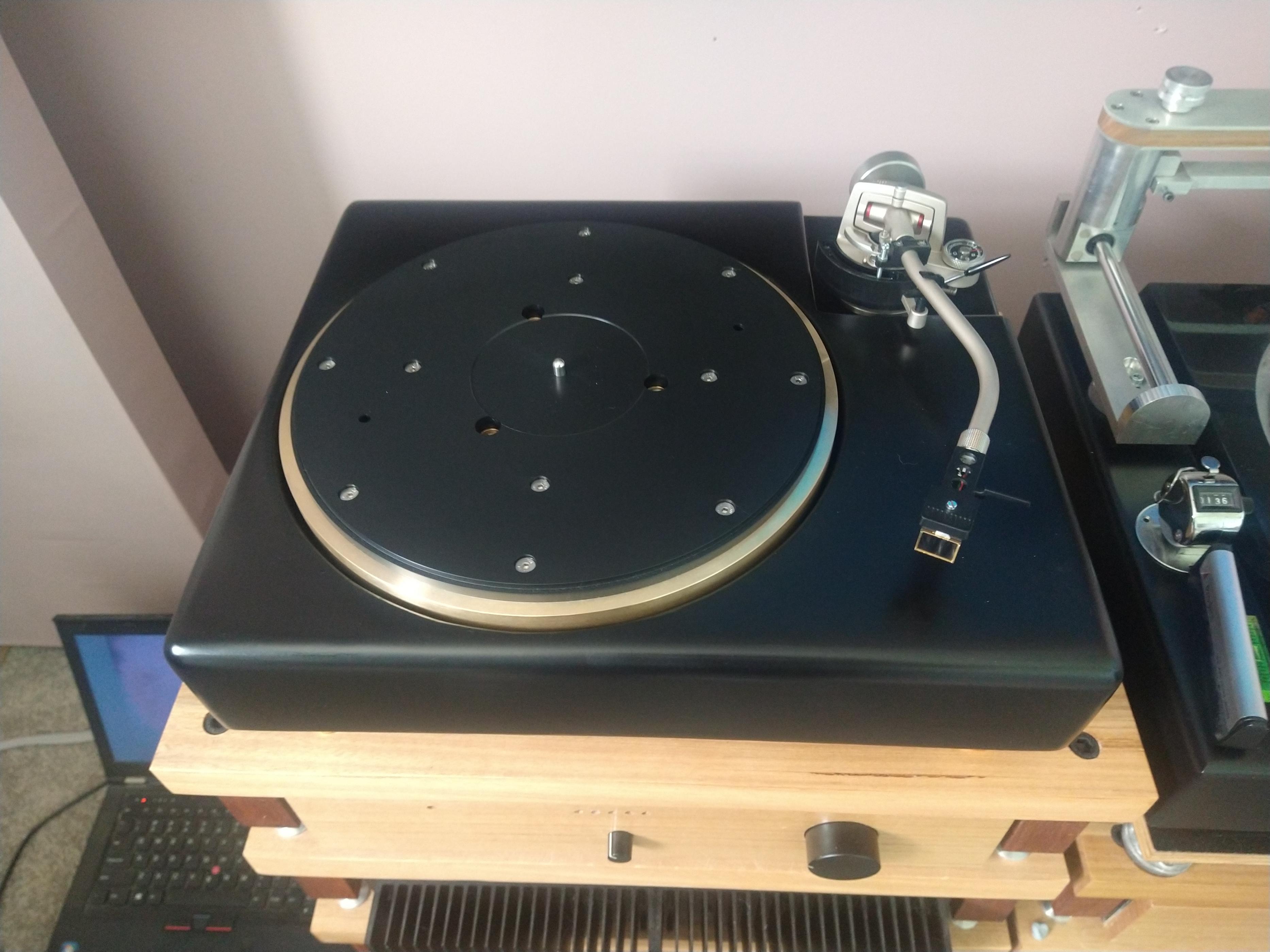

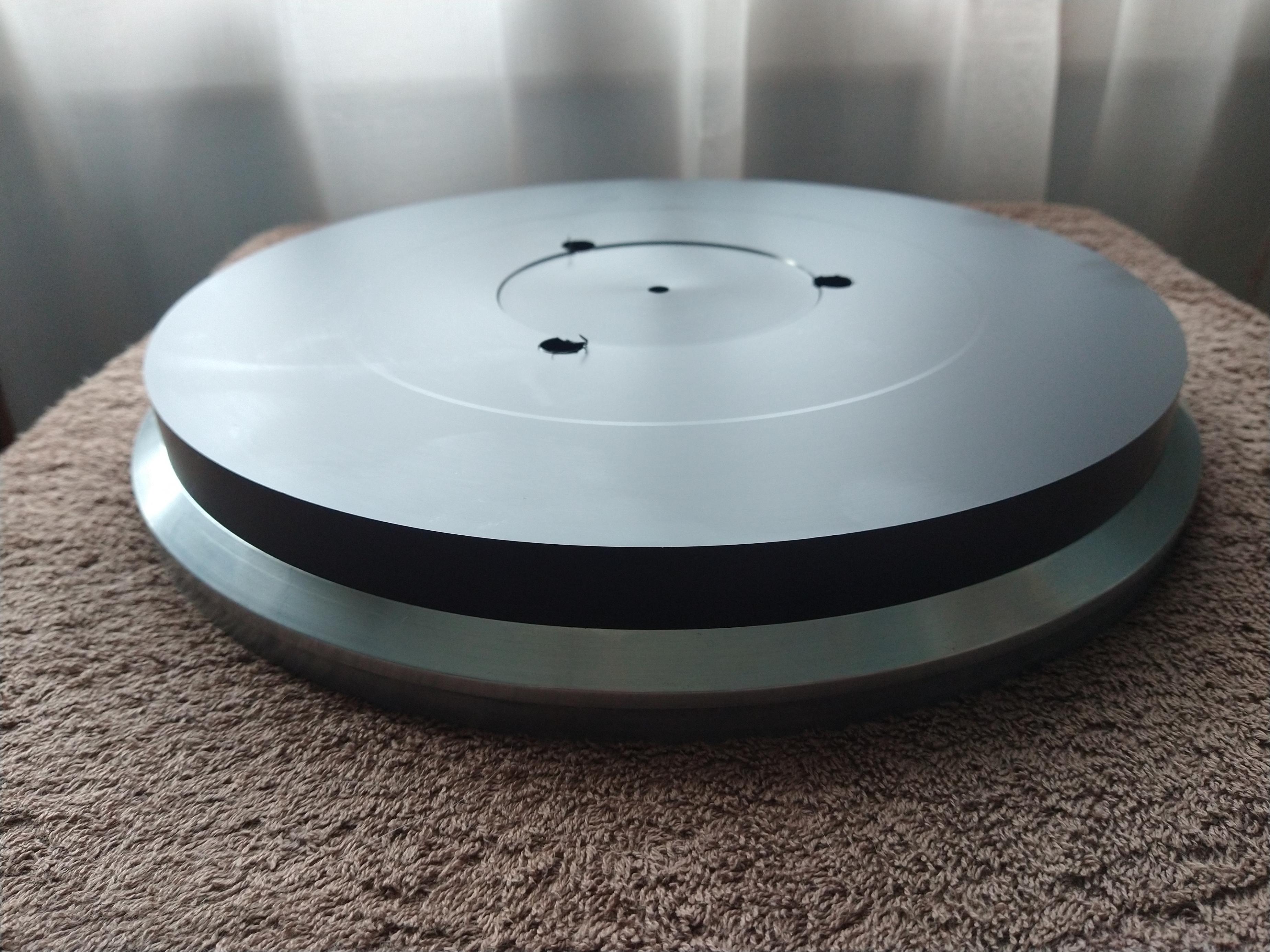

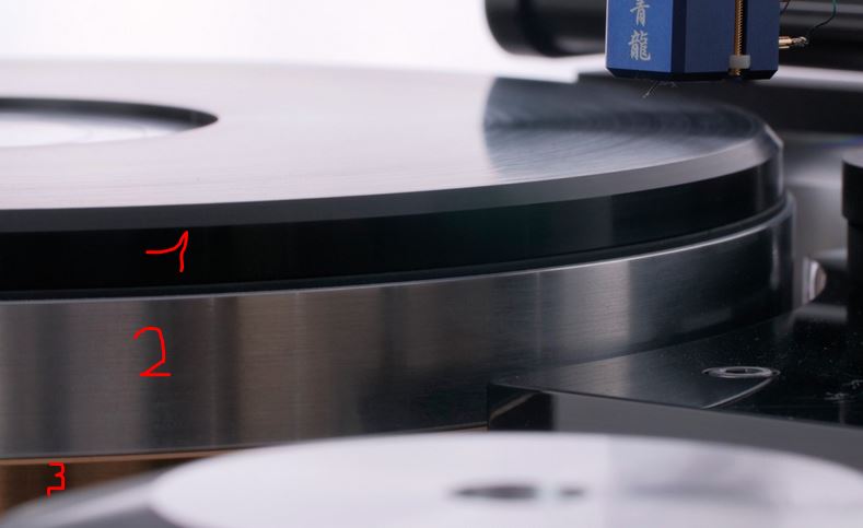

Hi Don,
Yes it was disappointing that the quality of the raw casings was not up to my expectation. My 2 GM platters are OK. I had to reduce OD to 315mm to remove most of the impurities. This makes the gap in the platter recess a little large for my liking. I had a second batch cast using a larger OD plug but these were worse. there are voids in the casting and the castings were warped significantly.
It was Bon's idea to make a POM platter. Between the 2 of us we ended up deciding to bond the POM to SS and in my case GM to provide stability to the POM (it has a tendency to warp when machined) The SS and GM also keeps COM low.
Bon's background is in seismic modeling so he has a great deal of experience in vibration analysis and control. His testing of his POM/SS platter suggests the POM is doing all the heavy lifting. Which correlates with my experience between my GM platters, 1 has 10mm and the other 20mm POM bonded to the top. The 20mm out performs the 10mm by a large margin.
Based on this testing and listening it is suspected that 20mm POM bonded to a stock platter should perform similar to GM/20mmPOM.
When I did my first 10mm POM/GM platter once bolted together the GM went from a dinner gong to a very dull thud when struck. This should also carry over to the aluminium platter. If this is successful it will also lower the cost as the GM blanks cost me $300 each + the POM.
If successful I can offer an exchange platter in either 10 or 20mm POM.
Both options will require height adjustment in the tonearm base of 5mm and 15mm for 10 and 20mm POM respectively.
Pics are 10 and 20mm POM/GM
This is somewhat correct. The PLL is designed for the mass of the platter and if you look at the filter math reducing platter mass has an effect on PLL stability. Increasing mass as long as the motor has enough torque makes no difference.
I have done measurements off the FG signal which clearly show the increased mass of the platter has no negative effect on speed stability.
If this were the case the Yamaha GT2000 would suffer speed stability problems when the aluminium platter 6.5kg was replaced with the optional gunmetal at 18kg, both are factory platters.
Yamaha GT 2000 Turntable | Audiogon Discussion Forum
The bearing contact is a ball mk2 and radiused shaft mk3 so the actual contact point is the same. My platter is 10kg and the bearing after 100's hrs is hardly worn.
Adding a rubber mat to the POM negates it effectiveness you want the LP directly on the POM.

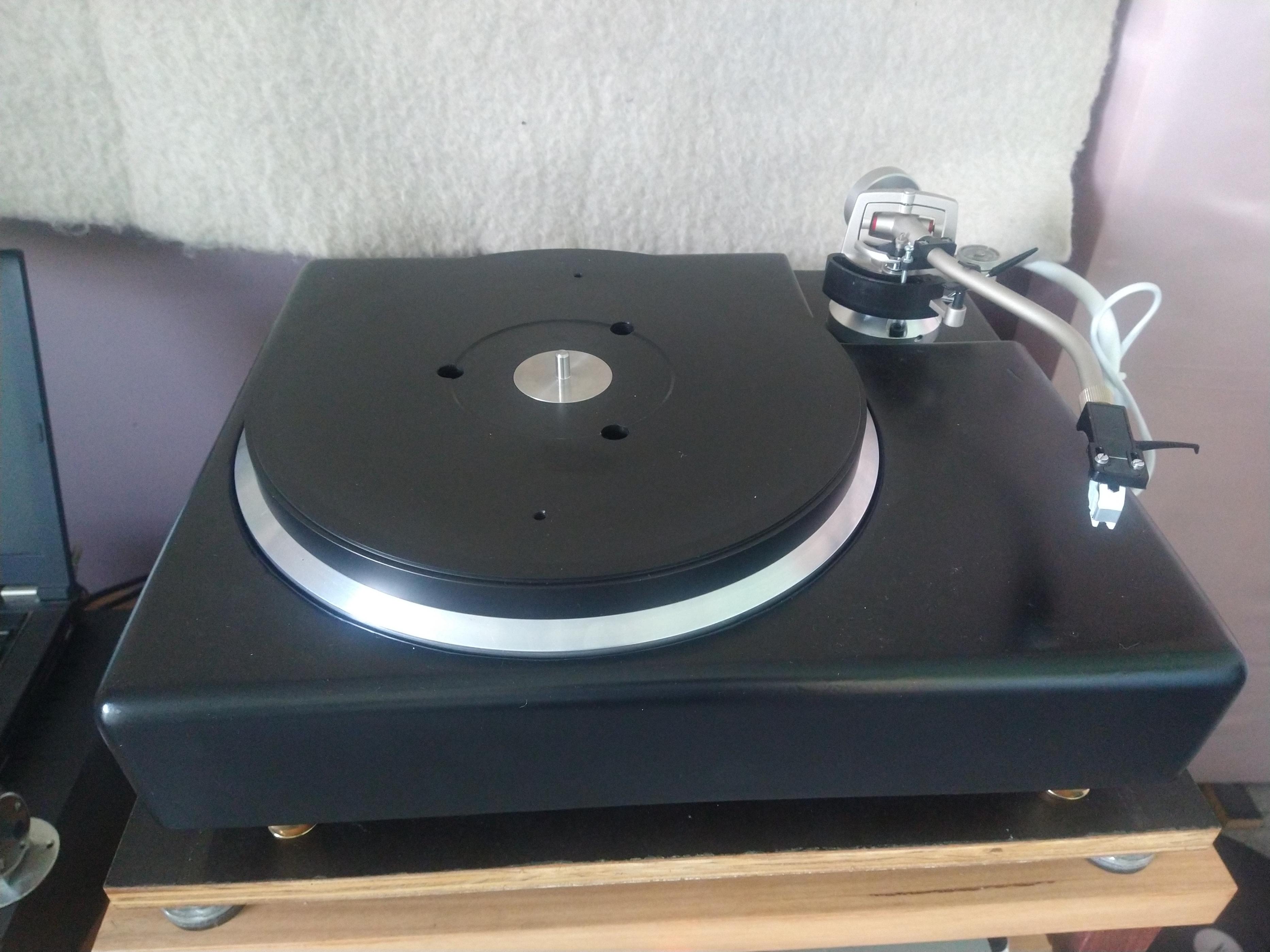

Got the 20mm POM bolted to the stock platter today. This is roughed out, it still need a shoulder on the outer edge, secondary spindle and final finishing cut.
I should have it finished tomorrow for a listening test.
Here is a short video of a resonance test stock and POM platters. BTW that is the best OEM platter of the 4 I have.

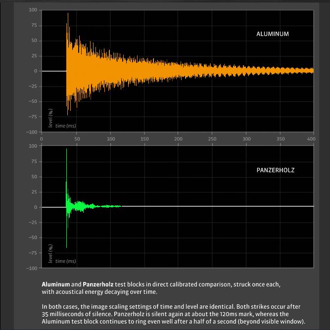

A forum member Catsquirrel has measured the damping properties of both P'holz and Permali and these are both highly recommended by his results.
There are different quantities of Lamination Tiers per 25mm, of which I believe the more is the better ?
Pico Wood has the maximum Lamination Tiers of all in production at present, but this could be shown to be incorrect, if new productions are available that I am not aware of.
A friend swears by a 32mm P'holz over the previous used 25mm.

I have done rudimentary testing on my current resin/bento plinth with a stethoscope. Put the stethoscope on the arm bearing and you can clearly hear the music, move the stethoscope to the plinth and the music is attenuated to the point where it's hardly recognizable.
My plinth was made so the arm and motor mount directly to the plinth, no arm board is used. This is to ensure a rigid mount and allow the vibration energy to damped by the plinth..
https://qualia.webs.com/newdampingfactors.htm
Resin/Bentonite is up there with Permali for damping and it's significantly cheaper and in my case much easier to work with. To complicate mattes further I live in Rural Aus 100's miles from Melbourne so shipping becomes a factor in anything I need to source. Where I get my fiberglass supplies a 20kg drum of resin costs $30 in shipping where shipping 1000x2000mm flat wood is a problem.
So the decision I guess comes down to availability as well as cost. Both densified wood and resin/bento will make for a great plinth. Especially if you make a Kaneta plinth.
OEM/POM platter. Mass 4.2kg so less than 1/2 the weight of the GM/POM.
I have done back to back listening between the GM/POM and OEM/POM and the jury is out. Is the GM better maybe by a very small margin, but I'm not 100% sure, it's that close. (and I 'm conscious of perception bias).
Listening tests between the following;
OEM/OEM mat and GM/OEM mat - GM is a clear winner. includes SS
GM and GM/POM 10mm - POM is a clear winner.
GM/POM 10mm and GM/POM 20mm - 20mm POM is a clear winner.
GM/POM 20mm and OEM/POM 20mm - no clear winner.
I am currently in the process of devising a series of tests that will hopefully clearly show the audible differences between platters. My first thought is pink noise and a spectrum analyser. But if anyone has any ideas I'm all ears.

Alu vs. Panzerholz
Here is also a helpfull technical sheet comparing alu vs. panzerholz:
The Virtues of Panzerholz : An Investigation into the Acoustical Properties of Aluminum and Panzerholz
