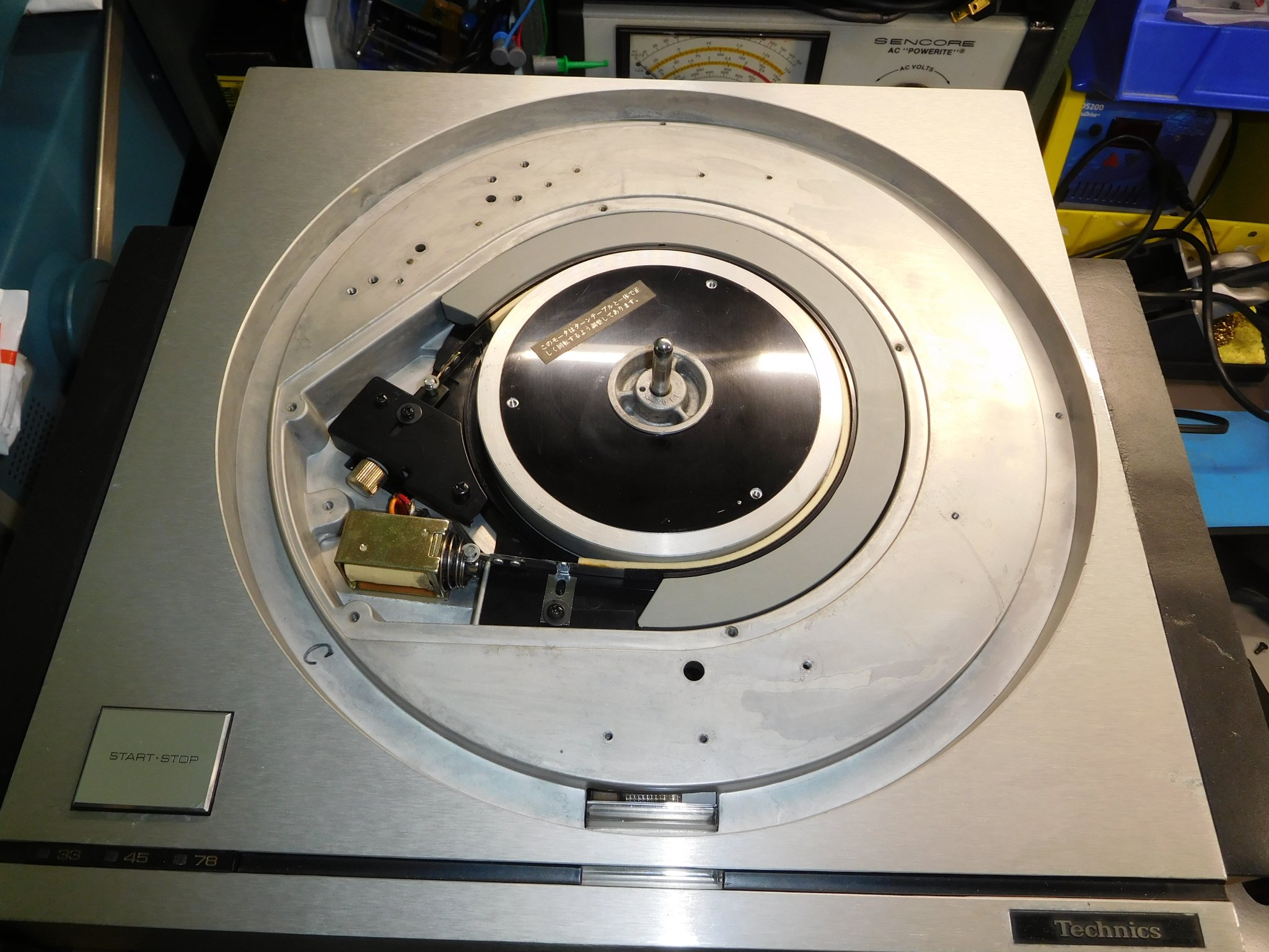

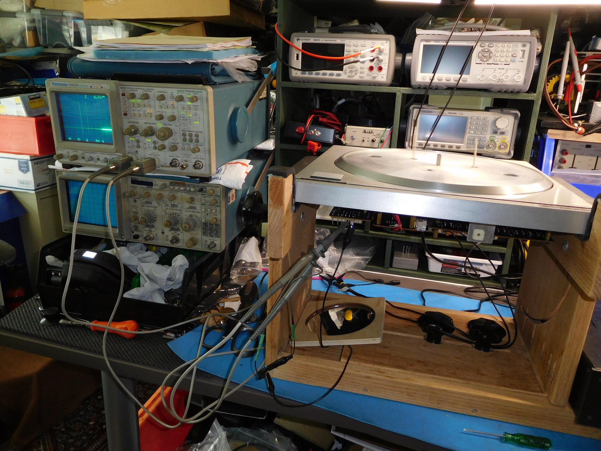

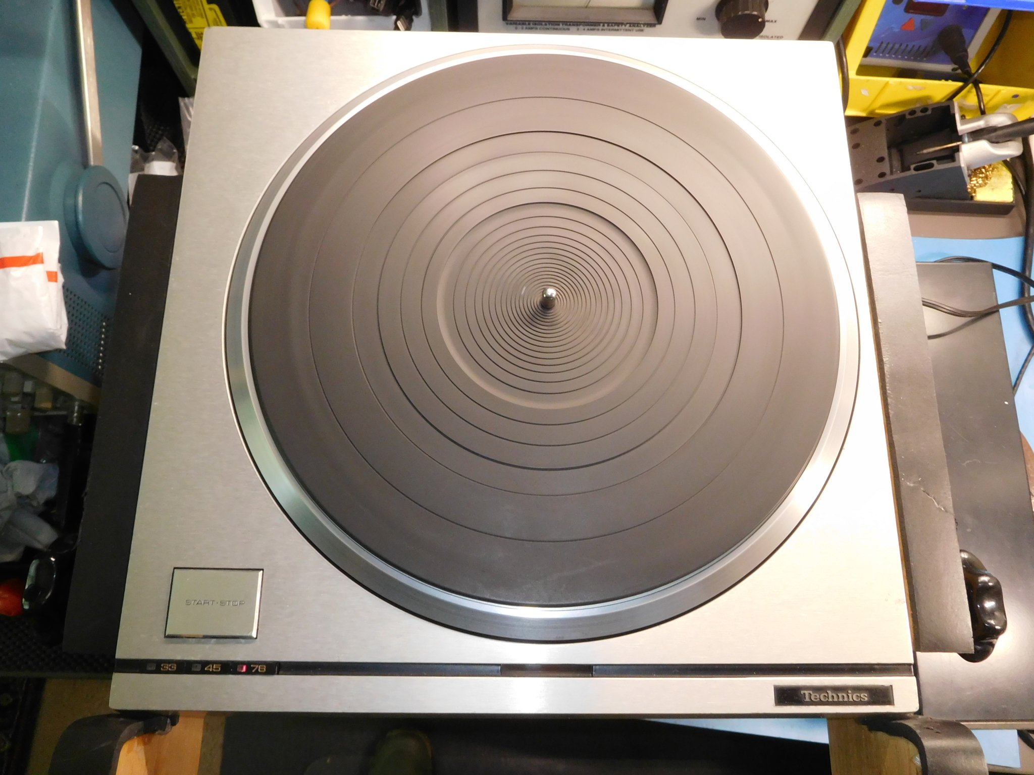

Got the turntable ready to go into the plinth when it arrives, and mount the tonearm.
Spun the platter on my lathe and cleaned up with Scotch pads - didn't want to remove much material.
VR101 and VR102 adjusted per specs, brake reassembled and adjusted, and I added some chassis damping material, with extra securing using dabs of polyurethane adhesive (don't want them dropping down near the PCBs).
The plinth is used, but will serve until I build exactly what I want it to live in. The tonearm is an EPA-b500 with a -a501H arm. I am also looking for a -250 arm at a reasonable (hah!) price.
Getting anxious to get this in operation now!

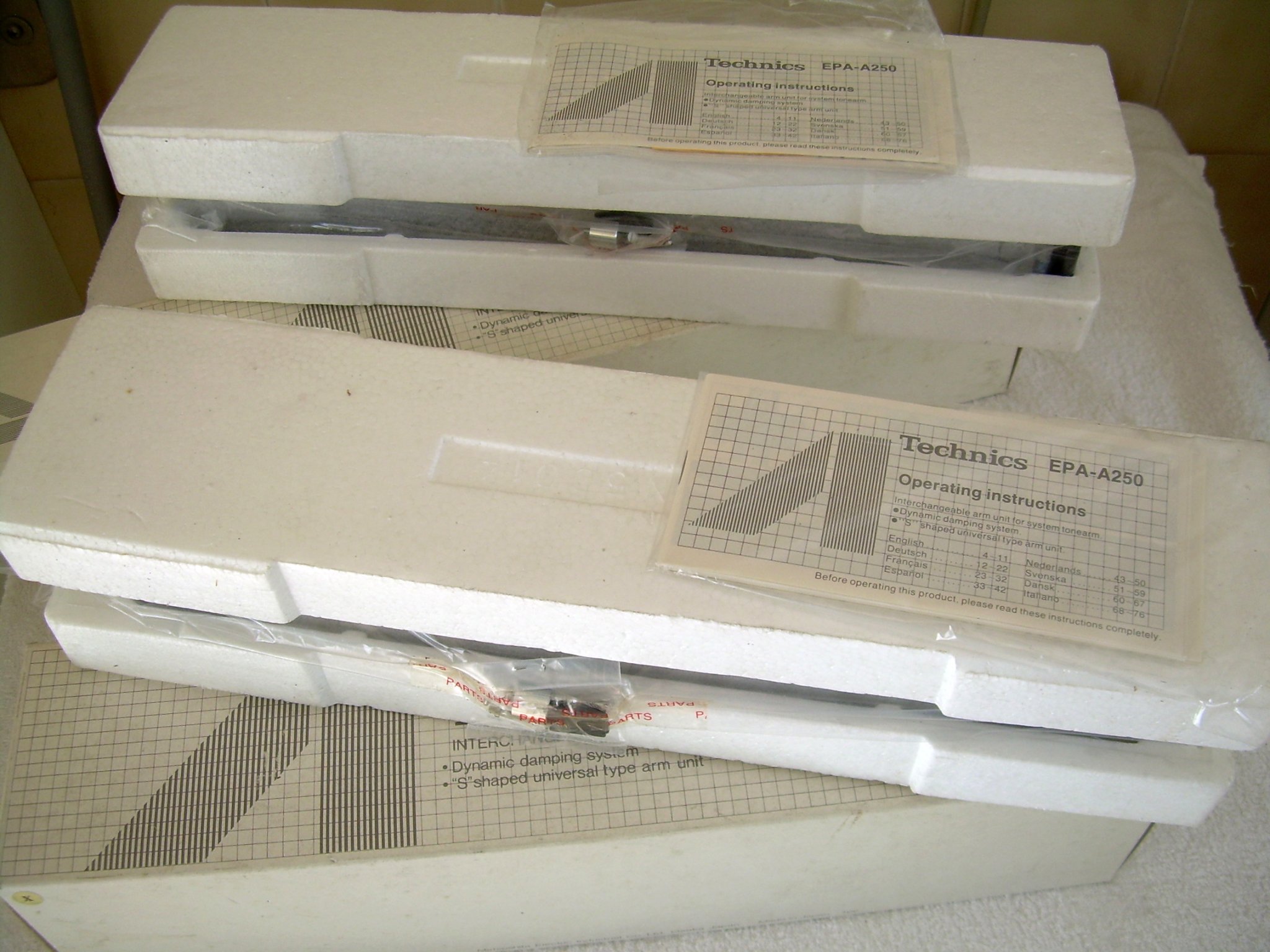

Out of Japan is likely your best bet, though EPA wands have been a bit thin lately, aside from the over-priced pieces that haven't been moving. I'm not shopping for an A250 at the moment, but I do occasionally grab others, so if you're bidding on something feel free to let me know so we don't bid against each other.

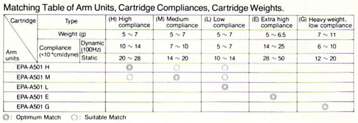

100/100MK2/500 have the same geometry. Ergonomics on the 100MK2 are better than the 100, and the VTA range is 20mm on the 100MK2/500 vs. 6mm on the 100. Pin races on the 100 are finished to a higher standard.
500 has steel ball bearings, but those can be upgraded to 100 spec. There are five straight wands available, an "S" universal, and a P-mount:
EPA-A501H - 8g
EPA-A501M - 10g
EPA-A501L - 18g
EPA-A501E - 6g
EPA-A501G - 14g
EPA-A250 - 14g
EPA-A505 - 6g
They're geared toward lighter cartridges and mounting a modern long MC on the straight wands can be an issue. All have dynamic damping similar to the EPA-100s with a fluid chamber in front of the CW and a magnet in the rear, only not adjustable.
I use 500s as I can have many carts mounted on different wands and the bases on different 'tables which allows swapping things around with great ease - all I need to do is adjust the AS and height.

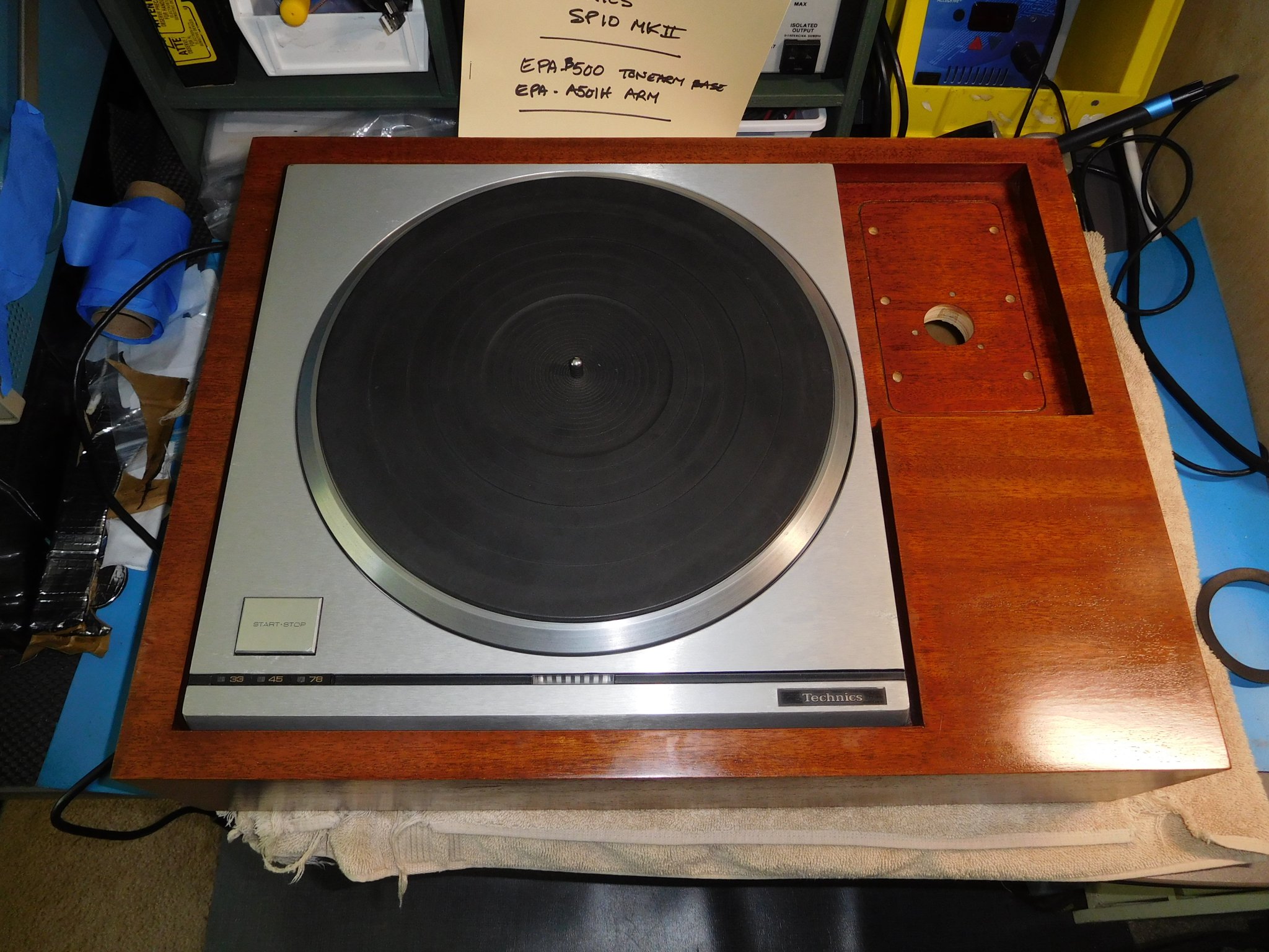

The plinth arrived and it's nicer than I had expected. The seller did a great job packing, so as heavy as it is, it arrived safely.
A little stain to refresh the surface, followed by some Feed and Wax, and it's ready for me to make a larger hole in the arm board for the EPA-B500 base, or make another because I think it needs to be raised above the plane that the table chassis sits on, based on the factory "obsidian" plinths (please correct me if I'm wrong).
Need to get some longer metric screws for the arm base and much longer ones for the table to plinth connection, but I might have to make them, as long metric screws aren't readily available locally.
Also need to determine the size of the ground spike/screw on the table and make or buy a suitable replacement nut. Looks like 7 or 8mm.
