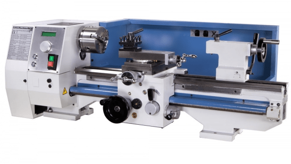

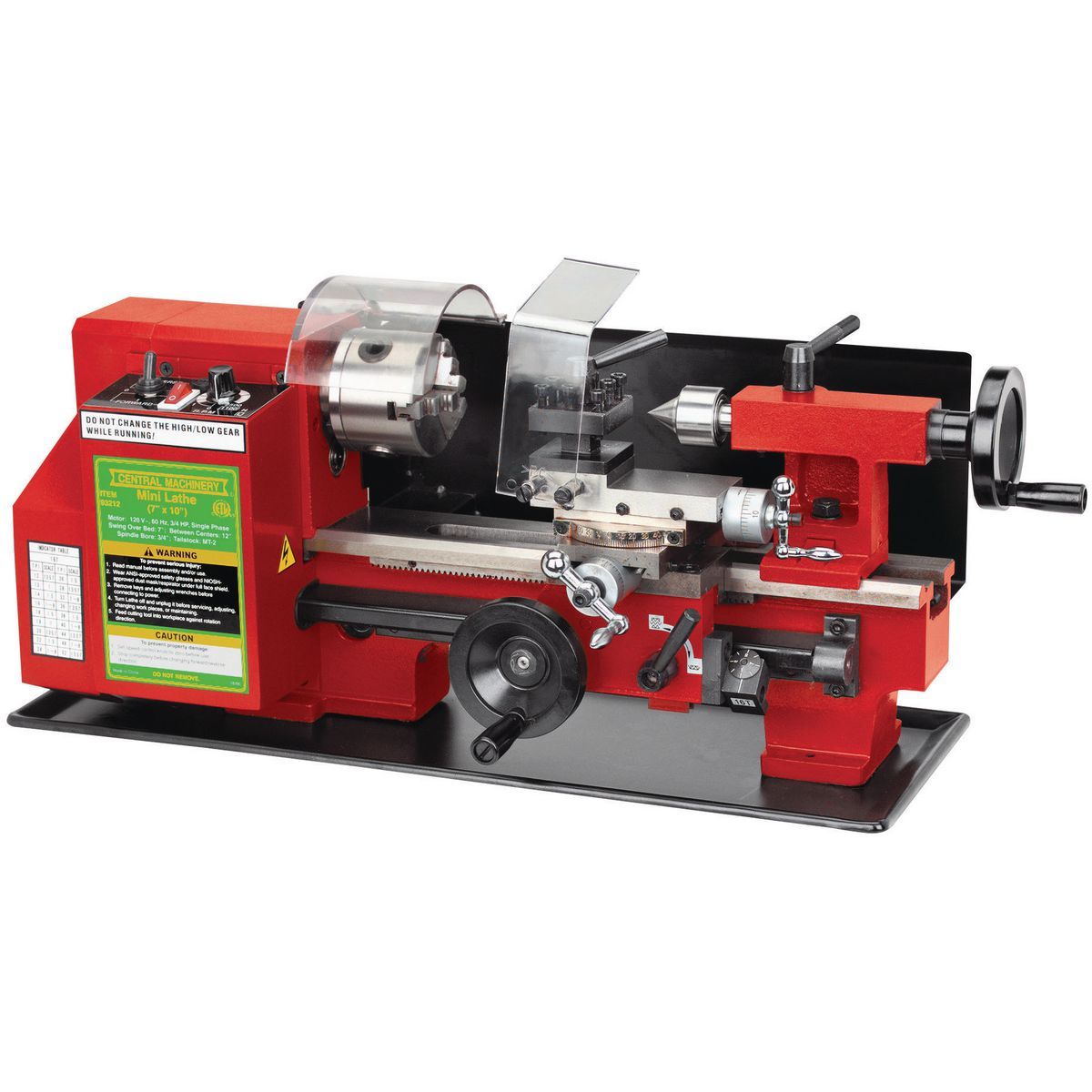

I've got this small machine, and after considering the diameter, it should do the trick. Also just remembered I have another jaw set for the 3-jaw chuck that might go down this small.

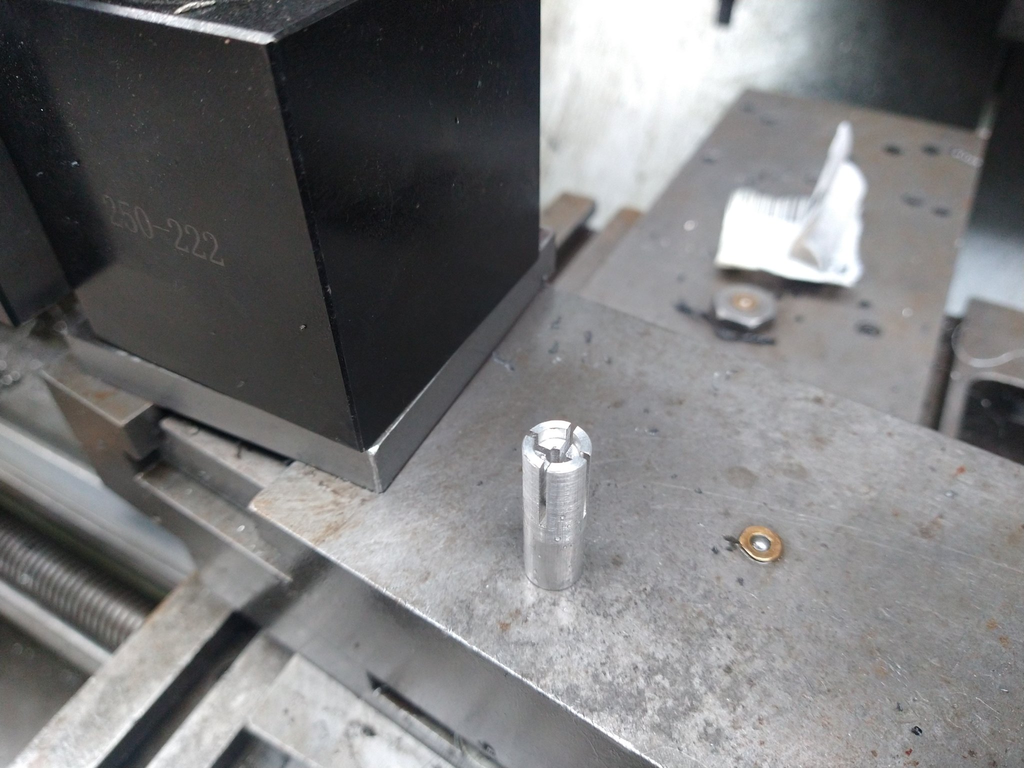

You can machine the thrust pads with a larger lathe. I use a collet chuck. I also made an aluminium fixture to hold the pad to make machining it easier. The fixture can also be held in a 3 or 4 jaw chuck, it's kind of like a 5C emergency collet but straight not tapered.

This is the fixture I made to machine the pads. It's 10mm aluminium round bar. You could easily make it from larger OD stock to fit your chuck. The pad does not need to perfectly concentric so long as the pad doesn't touch the journal sleeve. The important part is the fit of the pad on the bottom of the journal. This needs to be a positive clip fit and the bottom of the pocket needs to engage on the bottom of the journal.
The ID is 6.8mm and 2.5mm deep. I use 8mm OD bar machined to 6.7mm then cut the pad at 3mm length. Place the pad in the fixture and clip one side which becomes the bottom flip it over and machine the pocket. The depth of the fixture is what I use to govern the depth of the pad so repeatability is better than 0.1mm. I use a 4mm slot drill to pocket the hole then a small PCD boring bar to finish. A digital depth gauge on the tailstock makes drilling the pocket easier.

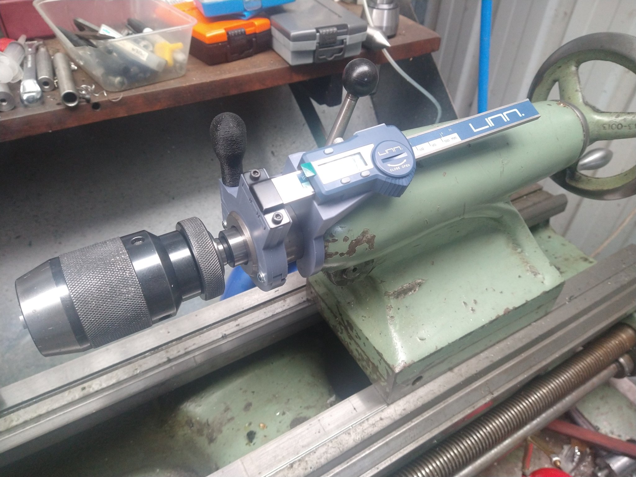

@GKTAUDIO You can use a 3/16 end mill just be careful as the 3 or 4 flute end mills can wander when plunging. A HSS boring bar will work, I have a few small boring bars made from broken drill bits. It does take time to get setup to make parts but once you have jigs it becomes easy to make more. When Woodsong stop making thrust pads I needed to make my own for servicing peoples SP10's.
Rather than polluting this thread with machining talk PM me if you want details of my tailstock depth gauge.
