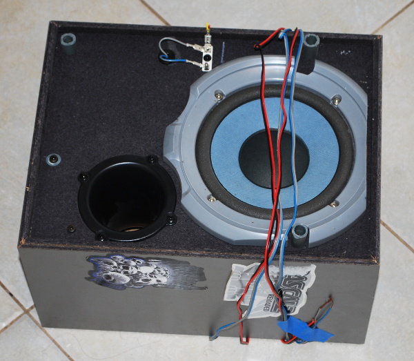

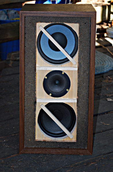

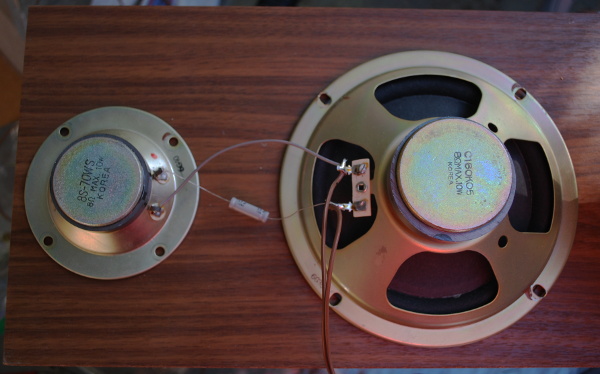

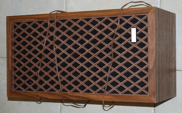

I have an elderly friend, David, with a physical handicap that makes it very hard for him to handle anything heavy. His passion is playing guitar (clean tones most of the time) and singing. I am slowly piecing together a relatively solid-state guitar amp as a surprise gift for him, starting with a vintage Sears "Adequate-Fi" speaker from a thrift store, and a little class-D audio power amp from Parts Express.
The vintage Sears speaker has a diamond-pattern plastic grille that reminds me of period Vox guitar amps. That was one of the reasons I bought it for David's project.
The power amp is stereo. One channel runs the original woofer/tweeter combination that was in the Sears speaker. I've hacked in a third loudspeaker driver into the box, run off the second amp channel. That driver was the mid/woofer in an incredibly ugly plastic boombox speaker from the same thrift store. It sounds decent as an electric guitar speaker. (A few pics attached.)
As far as the rest of the electronics goes, part one of the plan is to build a simple mic preamp, mated to the woofer/tweeter channel, so David can run his vocals through it.
Part two is to build an electric guitar preamp with JFETs, which will be encouraged to gradually produce smooth, low-order harmonic distortion. The JFET guitar pre will drive the other channel, and the other (single) speaker.
My hypothesis is that separating the guitar and vocal channels completely (both electronically and acoustically) in this way will allow undistorted vocals to coexist with (slightly) distorted guitar.
If it all works out, it should serve triple duty as small vocal P.A., acoustic guitar amp, or electric guitar amp, while remaining small and light enough for David to cope with. Deep bass and extreme loudness will, of course, be sacrificed to make this possible.
David won't accept a gift if it costs much, I'm quite sure. That's why the thrift-store and low-buck approach. Who knows, maybe it will qualify as a hundred-buck amp too, though entirely solid-state, and with one-off thrift-store parts in the mix.

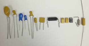

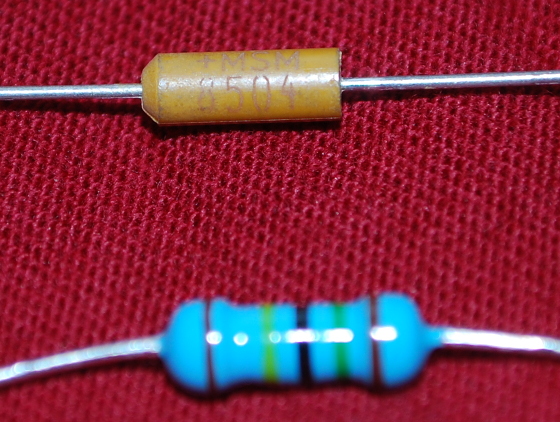

After a few attempts I have a passable photo of one of the mysterious (to me) tan capacitors, next to a 1/2 watt metal-film resistor for comparison.
So, is this a tantalum electrolytic? If it is, I'll stop using them. I didn't know about their tendency to fail early, and fail short-circuit.
Yes, it is. There are several varieties of packaging, yours is one of the least common. Your parts are from 1985. See picture.
Similar parts are still being made today.
T322C106K025AT Kemet | Capacitors | DigiKey
Actually there is no reason to trash them. Tantalum caps are regarded as quite reliable, and having lower inductance than other types, so they were often used in military applications, and other high spec circuits. Tantalums have fallen out of favor since the "great tantalum shortage" in about 2000. At that time there was only one active mining source for raw tantalum. The cell phone boom in the late 90's sucked up all the available tantalum creating a shortage. Within a year a 10 cent capacitor went to over a dollar in million unit quantities, and there were 52 week lead times. This forced parts vendors to accelerate the development of non-piezoelectric high K ceramics. Now we have ceramic caps that are cheaper, and of higher electric quality. Tantalum caps have however, not gone away. There are still plenty of applications where they are a good fit.
All capacitors are made of two conductors separated by an insulator. A modern dry capacitor usually fails by one of two ways. One of the connections breaks and it goes open circuit. This happens, but isn't too common. A "wet" type capacitor (most electrolytics) will eventually dry out and go open, although modern electrolytics are much better than old ones, heat is their enemy, and many are rated for as few as 1000 hours of operation at their maximum temperature.
The insulator can break down and the cap shorts out. This is the usual failure mechanism for most types of capacitors. If the capacitor is in a circuit where a high current can flow when it shorts out, bad stuff can happen with ANY type of capacitor. Ceramics and some electrolytics explode. Newer electrolytics have a safety vent. When they short out, they spew their stinky corrosive goo all over your amp. Tantalums explode or burn, not because of the tantalum, but because of the potassium oxide cathode....it is flammable.
I wouldn't use a tantalum in a high current circuit, say across an unfused B+ line, but they are useful for cathode bypass caps, and impart a slightly different sound than a similar sized electrolytic. I enclosed a picture of several Tubelab TSE HiFi amps. The very first prototype in in the lower right corner. Note there are tantalum (small blue cap) and electrolytic (large light blue can) capacitors wired in parallel for the cathode bypass caps on the preamp tubes.

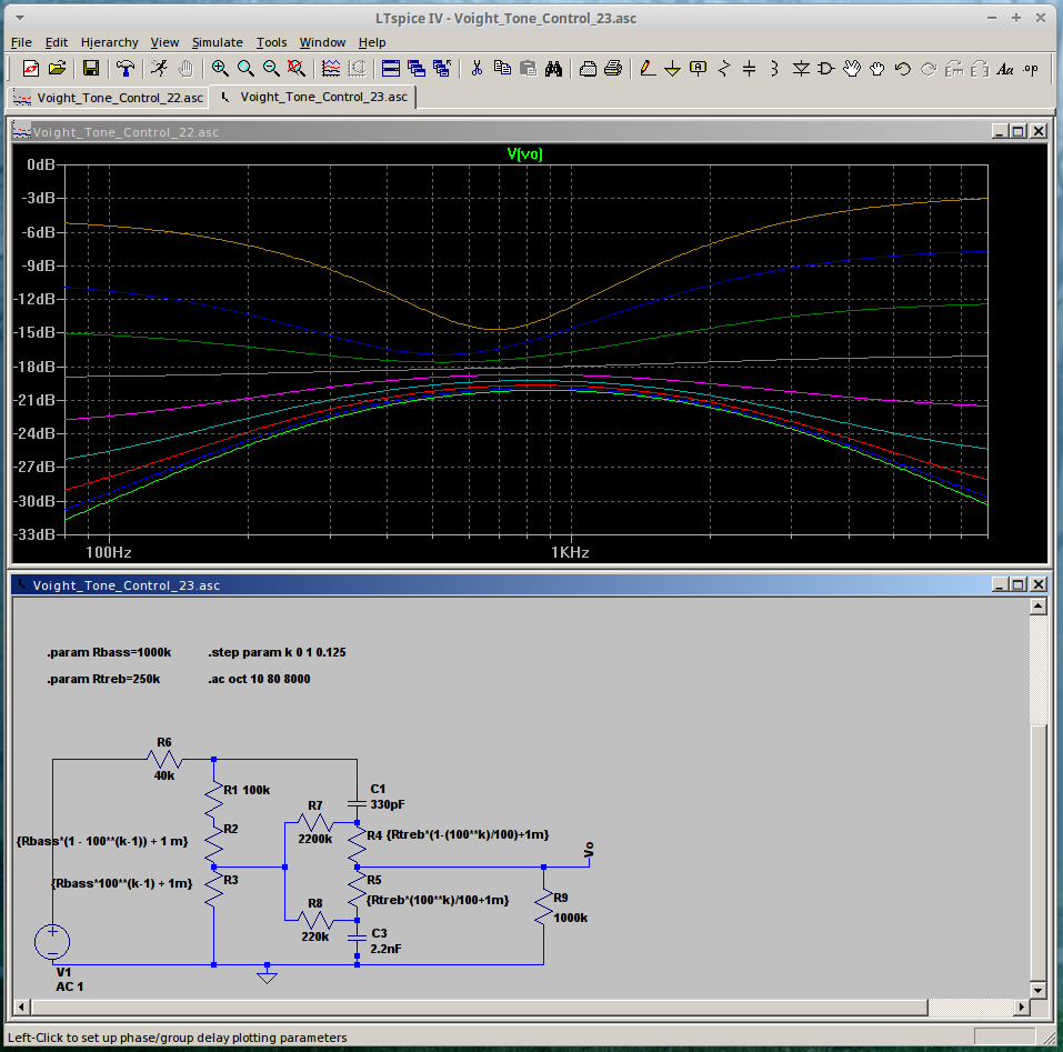

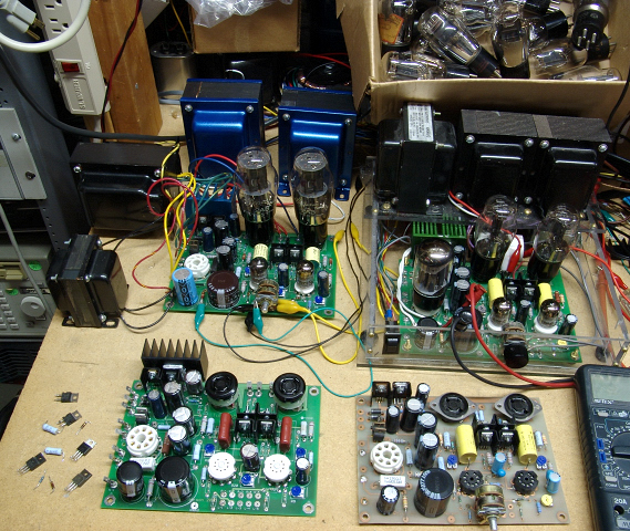

I have something interesting to share with those of you still on this thread. Take a look at the attached screenshot showing LTSpice doing its thing with a passive tone control circuit.
The circuit is a heavily tweaked version of the Voight tone control presented in Merlin Blencowe's valve preamp book. I have tweaked almost every component value to get the circuit to behave the way I prefer. Centre frequency is now about 700 Hz (bang in the centre of the 80 Hz - 6KHz guitar frequency band on a logarithmic frequency axis).
A few points to note:
Looking at it another way, when we use $1 valves, voltage gain is cheap. We don't need to penny-pinch and minimise the total number of valves, as Leonidas Fender used to. That means I can focus on getting the timbre I want, without worrying about every last decibel of insertion loss.
I've mocked up a version of this tone control (a rats-nest build right on the pot tags). I tested it with my guitar amp, and I love it!
IMO, this is the way guitar amp tone controls should operate - with the same ease of use and predictability as an active Baxandall tone control circuit on a Hi-Fi amp. Just turn the bass knob to adjust (only) the bass, turn the treble knob to adjust (only) the treble, and you're done!
You don't have to fuss around endlessly because the "treble" knob mucks up the bass, and the "bass" knob mucks up the volume, and the "volume" knob mucks up the treble, and round and round and round you go. None of that "interactive" garbage that came from sheer bad circuit design.
Ease of use isn't just nice, it's really important to me as a musician. To be a good musician, I have to try and stay in a more creative, right-brain-dominant state of mind. If I have to stop and think about how to operate confusing interactive tone controls, that pulls me into a left-brain-dominant thinking state. No good music performance comes from a left-brained thinking state!
-Gnobuddy

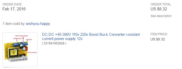

Do you by any chance have a link to the DC-DC converter you used? I don't think most models can handle 19V input, so I'm interested in the one you used. I too have a couple of unused laptop power supplies waiting for a project to use them.

Thanks for the link! That 12 unit survived 19 volt operation?Laptop bricks can supply plenty of current to run this and the heaters. 😀

It says it can go to from 8-35VDC input.
No issues found at 19V.
It did output up to 400VDC with 19V in no problem.
Less than $9 delivered is hard to beat.

You have almost made a sale. How do you adjust the voltage out? How about the max current? Some more options.

Adjustment made with the pot, of course. LOL
Current is stated to decrease with increased output voltage, and lower input voltage and current.

I was originally drawn here looking for a PP EL86/6CW5 guitar amp design.
I designed and built two amps for this thread. Amp 1.4 used 100 mA series string radio tubes and made about 2 watts. It was intended to be a usable guitar amp for minimum $$$. One of the main arguments in this thread was the use of silicon in the signal path. I asked the question early on and it was allowed, but hotly debated throughout the thread. For this reason Amp 1.4 had no silicon other than for rectification. It worked, but didn't inspire me to turn it on every day and wound up getting tossed into a random box when I had to pack up everything and move it all twice for a total of 1200 miles.
This thread had fallen into a six month deep sleep when I found amp 1.4 in a box while looking for some parts. Curiosity convinced me to plug it in, which led to how can I make this thing ROCK!!!!!! That led to amp 1.5 which, despite of a cabinet still gets played nearly every day.
At the time of the active challenge, I also had two other amp projects. Both were higher power designs with some mosfet followers used as buffers to bring the gain of a TV / radio tuner tube into 12AX7 territory. The design was inspired by the "Marshall 18 Watt" schematic floating around the internet.
Both fit into the "under $100" parts budget, including the attenuator used to reduce the power output for practice amp use, while allowing full metal racket tone from overdriven output tubes. The "twins" were identical except for the output tubes. One used 2 X UL84 / 45B5's and the other used 2 X 50JY7 sweep tubes. Both used 3 X UCC85 / 26AQ8 preamp tubes. The sweep tube amp never quite worked right so, of course that's the one I have recently found.
The 45B5 is a 45 volt 100 mA heater version of the 6CW5. The power supply was a SS diode rectified 120 VAC isolation transformer which delivered 170 VDC. There was also a voltage doubler to make 340 VDC. The heaters were all wired in series and connected to the 170 VDC supply, as were the output tube screens. The output tube plates and the preamp tubes were fed from the 340 volt supply. The OPT was a 50 VA power (mains) toroid creating about a 3200 ohm CT load. The amp made 25 clean watts, and about 30 watts at clipping. Played through a single 8 inch Jensen alnico speaker, it screamed.
I thought the schematic was somewhere in that long thread, but I could not find it last night. It is included here. There were many changes sky wired into the amp that were never documented and put into the schematic. Most were deletions. All of the mosfet shunts on the preamp tube cathodes are gone. The idea was for variable gain, but it didn't work. The whole amp had far too much gain, so most of the mosfet buffers were removed, and I believe one gain stage had been removed. I won't really know until I find the amp. The PI and output stages work great and didn't need mods. I now believe that the pentode / mosfet saturator that I added to amp 1.4 to make amp 1.5 will go into this design.
