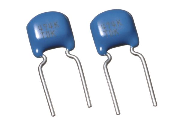

These 3.3uF caps seem to make nice cathode bypass caps for valve preamp stages, if you want a little bit of bass cut.
Even stranger, in the surplus section of the same store, some months previously there were small plastic bags of little tan components that looked very much like 1/4 watt resistors. Same size, same shape, same axial wire leads. But the bag was marked "3.3 uF". Nobody in the store knew the voltage rating, but they were cheap and interesting, so I bought a bag.
These are some sort of capacitor - but I've never seen this much capacitance in that small, cylindrical, form-factor. Under a magnifying lens there is a "+" on one end, and I think I also see "30V".
Are they electrolytics? I've never seen an electrolytic cap with wire leads this small before. And these look like moulded plastic, not an aluminium can full of liquid electrolyte. 😕
Whatever they are, these seem to work well as full-bandwidth cathode bypass caps for 12AX7s and so on.
Caps the size of (low-wattage) resistors with microfarad capacities - who saw that coming? I didn't!
You can get 10uF 16V ceramic chip caps in 0805, and 3.3uF in 0603. I have seen tiny molded glass cylindrical devices with a chip cap inside in modern military surplus. You can buy tiny 10uF leaded ceramic caps from Mouser. I'm using these in a consulting project that I'm building:
FK24X5R1C106K TDK | Mouser

I think that axial leaded component is a tantalum cap. I don't like them because they fail at the slightest exceeding of their specs and fail closed - which is not good in most places you need a cap.
The 10uF, 16V caps George linked to are listed as multi-layer ceramic, made by TDK.
I remember seeing those 10uF ceramic leaded caps at Mouser the last time I placed an order, many months ago. I thought I had actually ordered a few of them, for use as cathode bypass caps. But a week or so ago I rooted through my parts box(es) looking for small value caps, and I didn't see any 10 uF ceramics. I guess I never did order them.

If it's got a + on one end, it's not ceramic or film, they're non-directional. Tants are polarized and solid, so that's my best bet. I've seen some like that before.
Perhaps we are somehow looking at two different cap types on Mouser? 😕
Here is the (Mouser-provided) link to a PDF datasheet for the caps George and I are talking about: http://www.mouser.com/ds/2/400/eadmlcc_conventional_fk_en-844010.pdf
The datasheet is 23 pages long(!) and I didn't read every word, but it starts out with a description which includes the following text:
[special="High capacitance has been achieved through improvements in the thinning process of ceramic dielectric layers and multi-layer lamination technology..."]%[/special]
No mention of tantalum or electrolytic, only of a layered ceramic dielectric. I did not see any mention of the caps being polarised, either.
On the other hand, those mysterious axial, tan-coloured, moulded, 3.3uF caps I have - the ones that look like 1/4 watt resistors - do seem to have a + on one end. Those may be tantalum, I suppose. Is that what you were referring to?
