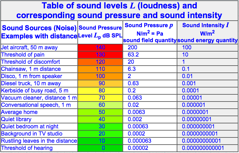

I started by trying to establish "acceptable sound volume" actually meant, once translated into in fairly objective engineering terms.
So, one night, I put together an adjustable speaker attenuator, hooked up an old 12" Jensen speaker I had to a signal generator, and was shocked to find out that I could very audibly hear the test tone with about ten millivolts of drive to the (8 ohm) speaker; that translates to just barely ten *microwatts* of power!
At first I was convinced I had made a calculation error, but a few checks and re-checks convinced me that I hadn't. Ten microwatts is (-50) dBW. Run that into a speaker with, say, 95 dB / watt sensitivity, and you should have (95-50), or 45 dB SPL @ 1 metre.
45 dB SPL is quiet - but very distinctly audible, and in fact, loud enough to be very annoying when you listen to a 1 kHz sine wave test tone for more than a few seconds!
With my initial expectations of "low power" shattered - I did not anticipate microwatts - I went looking for information on subjective descriptions for SPL numbers. I quickly found a number of suitable tables, one of which is attached.
This particular table compares 80 dB SPL to being 5 metres from a busy road. 70 dB SPL is compared to a vacuum cleaner at 1 metre distance. 60 dB is similar to "conversational speech".
One can argue about the exactness of those numbers (How busy a road? How loud a vacuum cleaner?) But they at least provide a starting point.
In other words, I'm pretty sure my neighbours don't want to hear my electric guitar sounding as the "kerbside of a busy road" (80 dB) under any circumstances. They *might* be okay - during the daytime - with my guitar sounding as loud as a vacuum cleaner (70 dB). But at night, that better come down to no louder than "conversational speech", i.e. 60 dB SPL, and maybe even lower, to the 50 dB SPL range, as loud as the "average home".
That gave me initial targets for my guitar amps expected SPL numbers. I would need acceptable guitar tone at a maximum of 60 dB SPL if I expected to use the amp in my apartment at night without annoying the neighbours. During the daytime, that might be increased to a maximum of maybe 80 dB SPL, though 70 dB would be a safer number.
In a later post I will translate these SPL numbers to guitar amp output power numbers. The results shocked me, and perhaps they might surprise you, too!
-Gnobuddy

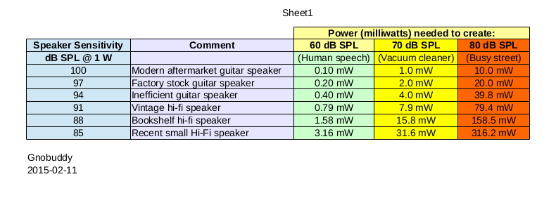

In my last post, I set initial SPL targets of 60 dB to 80 dB for my guitar amp design, as those seemed likely to be acceptable to the neighbours.
The next step was to translate those into actual guitar amp output power in watts. The translation requires the speaker sensitivity (dB SPL at 1 metre for 1 watt input power), and a few assumptions about the environment (such as, how far your ear will be from the guitar speaker).
Assuming a typical small room, the guitar amp will be within two or three metres of your ears. Assuming a fairly acoustically reflective room, the SPL at your ears won't be much less than the (anechoic) SPL at 1 metre that the speaker specifications list.
With those assumptions, I put together a little spreadsheet that contained a list of typical speaker sensitivities, and calculated the power in watts needed to drive them to my three target SPL levels of 60 dB, 70 dB, and 80 dB.
Here's a (pdf copy) of the spreadsheet. Using an efficient guitar speaker, we only need a few milliwatts (!) to achieve even the highest of the three SPL numbers.
At the other end of the scale, a quite inefficient contemporary speaker (perhaps designed for a small bookshelf Hi-Fi speaker system) might require as much as one-third of a watt to hit 80 dB SPL - which, I might remind you, your neighbours might find obnoxiously too loud.
Now we know why we hear so many complaints on the Internet about 5 watt amps being far too loud for home use! What we actually need is an output power controllable down to a few milliwatts, and we probably won't need a maximum sustained output power any higher than maybe a hundred milliwatts.
I found that these theoretical estimates seem to apply fairly well to overdriven guitar sounds, which have very little dynamic range, so that the output power from the amp is fairly constant for the entire duration of the notes emitted by the guitar.
Clean guitar sounds are a different story. Guitars emit a big initial transient, followed by a fairly rapid decay. The average SPL is much less than that initial peak. Put another way, to get an average SPL of, say, 70 dB, you need a peak SPL that is much higher. That means you need considerably higher peak power than the figures in my spreadsheet.
In practice, I found that maybe one or two watts RMS was a good maximum power target for *clean* guitar tones. For heavily overdriven tones, the output power needed to be in milliwatts, as the spreadsheet predicts.
-Gnobuddy

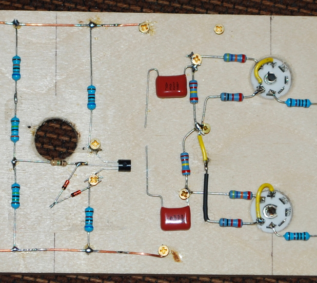

Sorry I've been silent so long, work was crazy busy for a while.
For my amp project, I spent quite a lot of time trying to re-think the traditional ways of physically constructing the actual circuitry. Tag-strips and turret boards were perfectly good choices in 1955, but today these are specialty items. I wanted to find a replacement that I didn't have to mail-order.
Also, I knew nothing about making a good guitar amp when I started, which meant I would have to modify, rip out, and re-do parts of the circuit as I learned what worked, and what didn't. I needed a flexible construction method that could easily accommodate changes - that means PCB construction was ruled out.
I don't enjoy doing the same complex and time-consuming task twice, so if possible, I wanted a prototyping method that would also serve as the final construction method - no need to build the whole thing over again.
Also, I wanted a nice tight layout - no long dangling wires everywhere, to pick up noise and cause RF instability. And I like the physical layout to at least somewhat mirror the schematic: inputs on one end, outputs on the other, positive supply rail along one edge, ground along the other, et cetera.

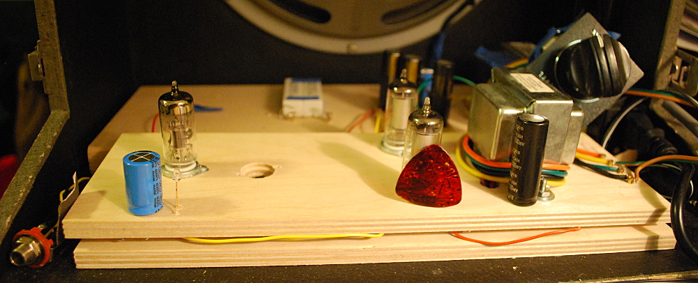

After much head-scratching, I came up with something that met all these requirements. The circuits are built on 3/8" thick, 4" wide x 12" long rectangles of plywood from Michaels (arts and crafts store) as the substrate.
Chassis-mount valve sockets were mounted in through-holes cut in the plywood. Physically, plywood of this thickness and size is very sturdy. It can easily carry the weight of small transformers and valves, and cope with valve insertion/removal forces.
The small components (resistors, caps, etc) are mounted flat on the underside of the plywood. They are soldered to tie-points which are #2 brass wood-screws, 3/8" long, which I found at Lowes hardware. The screws are short enough not to protrude through the other side of the ply, particularly because I leave the head and about 1/8" of the shaft sticking out of the wood on the underside.
Big components - large filter caps, transformers, valves - go on the top of the plywood, with through-holes for leads as necessary. Just keep temperature-sensitive components well away from the valve bottles. (Transformers mount with through-bolts, with lock-washers and nuts on the other side of the ply. We don't want tiny wood-screws to pull out and allow a live transformer to flail around. :eek: )
Obviously, it is really easy to add new tie-points (screws!) as necessary, if the circuitry evolves. I drill a pilot hole for each screw, using a small drill bit and a pin vise held between my fingers. That ensures no splintering or flaking of the wood.
I am very happy with how this construction method turned out. Easy availability, good layout, short leads, good durability. To me, this method incorporates some of the best aspects of both PCB and turret-board construction, and - for home-constructed one-off valve designs - improves on both.
Attached is a picture of the underside of my power amp board, at an early point during the construction. You can see the sockets for the output valves, and some of the passive components around them. You can also see the bare copper wire rails for small-signal ground and B+.
The second picture shows the top of the power amp board, during early testing. (It was plagued with blocking distortion at this point in the design process.) The Fender guitar pick is for scale. These are little valves!
If you recognize any of the valves in the photos, please don't mention the part number here. We don't want that mysterious Hong Kong outfit that George told us about, buying the entire supply, and most likely, crushing them into powder. Once these are gone, they're gone for good - none of these valves is in current production.
You may have noticed three semiconductor devices in one of the photos - a three-lead device in a T0-92 package, and a pair of series-back-to-back zener diodes.
Back in 2014 I came to the conclusion that using a valve in a cathodyne phase-splitter was a total waste of a good valve; with 100% local negative feedback, a cathodyne has too little distortion to be audible when operated below clipping. That means, when not overdriven, a valve cathodyne is audibly transparent, "solid state clean", with no "valvey" sound to contribute to the amp. And if you do overdrive it, it has a tendency to make some very nasty noises, unless you carefully design them away.
I remember that Tubelab George has expressed a similar opinion somewhere in this very long thread.
So, the little black plastic object in the attached photo is a TO-92 MOSFET, a Supertex LND-150 N-channel, depletion-mode device that is well known on this forum. It's wired up as a "source-o-dyne" phase splitter.
It's essentially the same as a cathodyne, except for the biasing method. MOSFET's have far too much tolerance in their electrical parameters to be reliably "self biased" like a valve. So the gate is biased to one-quarter of B+ using a voltage divider.
IMO, a mosfet makes a much better phase splitter than a valve-based cathodyne. It is 100% audibly transparent and contributes nothing to the sound of the amp, just like the cathodyne; it can output a much bigger signal than a triode running off the same B+; no heater elevation voltage is required; and it has none of the nasties that can afflict a true valve-based cathodyne.
In addition, of course, it's small, light, cheap, and requires no heater power.

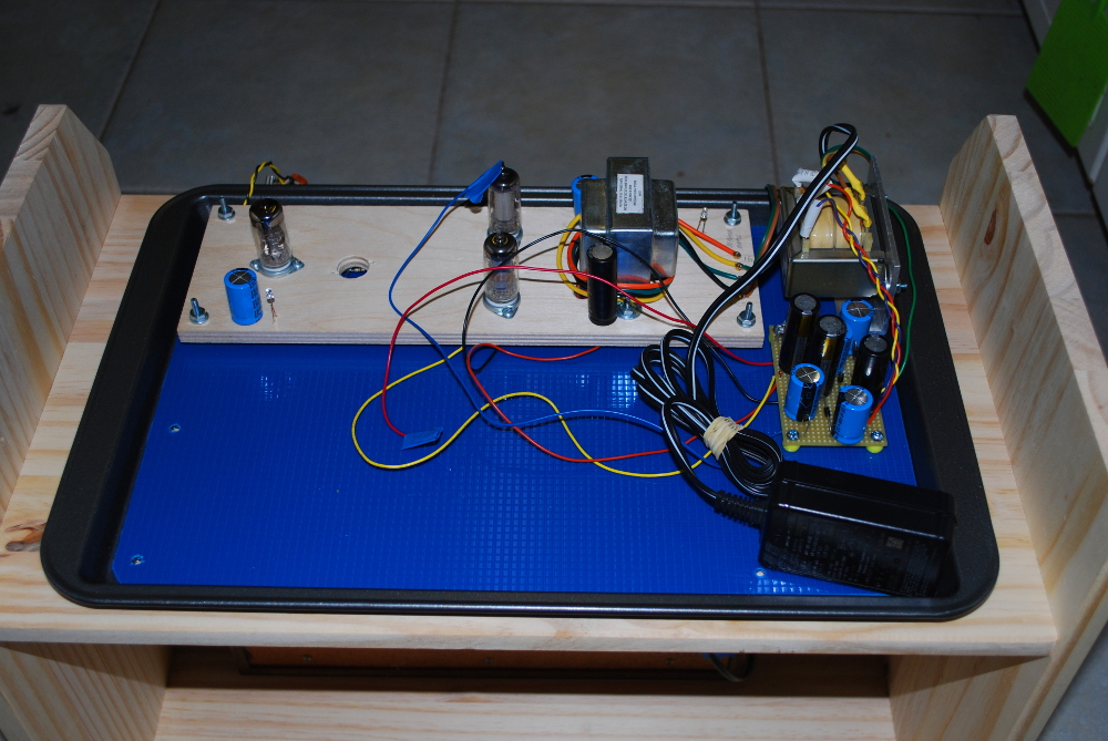

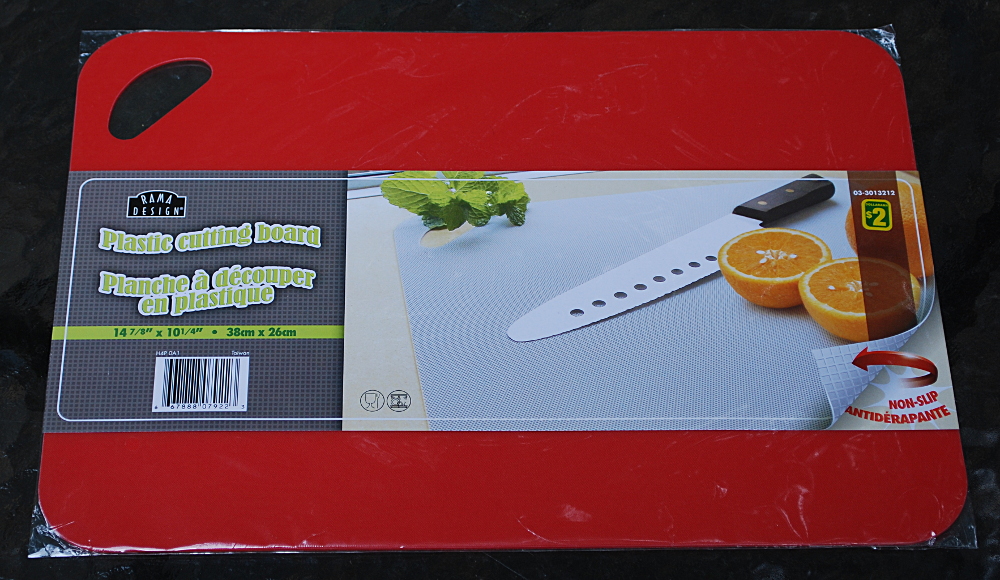

The other half of the "plywood and brass screws" circuitry is a metal chassis made from a dollar-store cookie baking tray.
The construction is inverted compared to the traditional way valve circuits are built, i.e. the chassis is on the bottom, with the circuit boards (carrying the valves) mounted on top of it with machine screws, nuts, and standoffs.
The standoffs are "pony barrel beads" from, of course, the dollar store.
There is an insulating sheet between the metal chassis and the underside of the circuit boards; we don't want brass screws carrying 280 volts to short out to the grounded metal chassis! The insulating sheet is another dollar-store item, this time a plastic kitchen cutting board.
This construction method reduces metalworking to a minimum. There are no complicated holes to cut in the metal chassis - no rectangular transformer openings, no lopsided hexagons for IEC inlets, etc. The chassis tray only needs small holes drilled in it for the mounting bolts. That is easily done with a hand-held electric drill.
-Gnobuddy

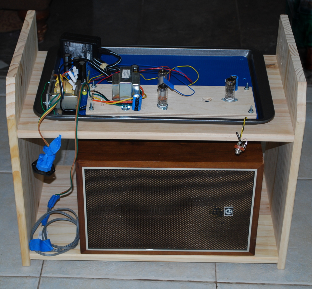

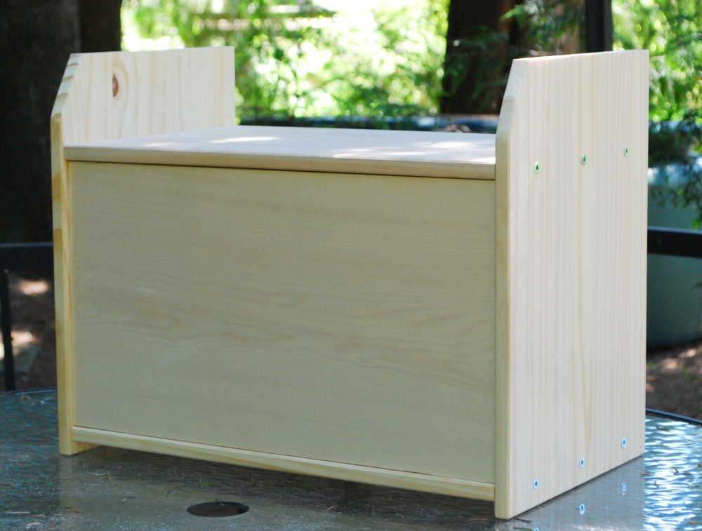

Speaking of guitar cabs, a while ago I stumbled across one solution to to the DIY guitar cab problem. IKEA makes a little solid-pine night stand called the RAST, which sells for $20 in Canada and $15 in the USA. ( RAST Nightstand - IKEA ).
Flip a RAST upside down and add a front and/or rear panel, and it makes an excellent guitar combo//speaker cab. For those of us without access to a table saw and/or the skills to use one, this makes constructing a cab a whole lot easier. :)
It will fit up to a 10" speaker in stock form; one shelf can easily be moved over to fit a 12" if desired, all that's required is drilling six screw holes. My tip for this is to use the existing holes in the second end panel as a jig to drill the new holes in the first end panel - that way you get perfect spacing and alignment automatically.
The pics below show part of the tale of my RAST turned combo guitar cab. One intermediate stage in the process used a rather sorry-looking $4 thrift store JVC speaker lying inside the RAST, while I waited for the speaker I actually wanted to arrive in the mail.
