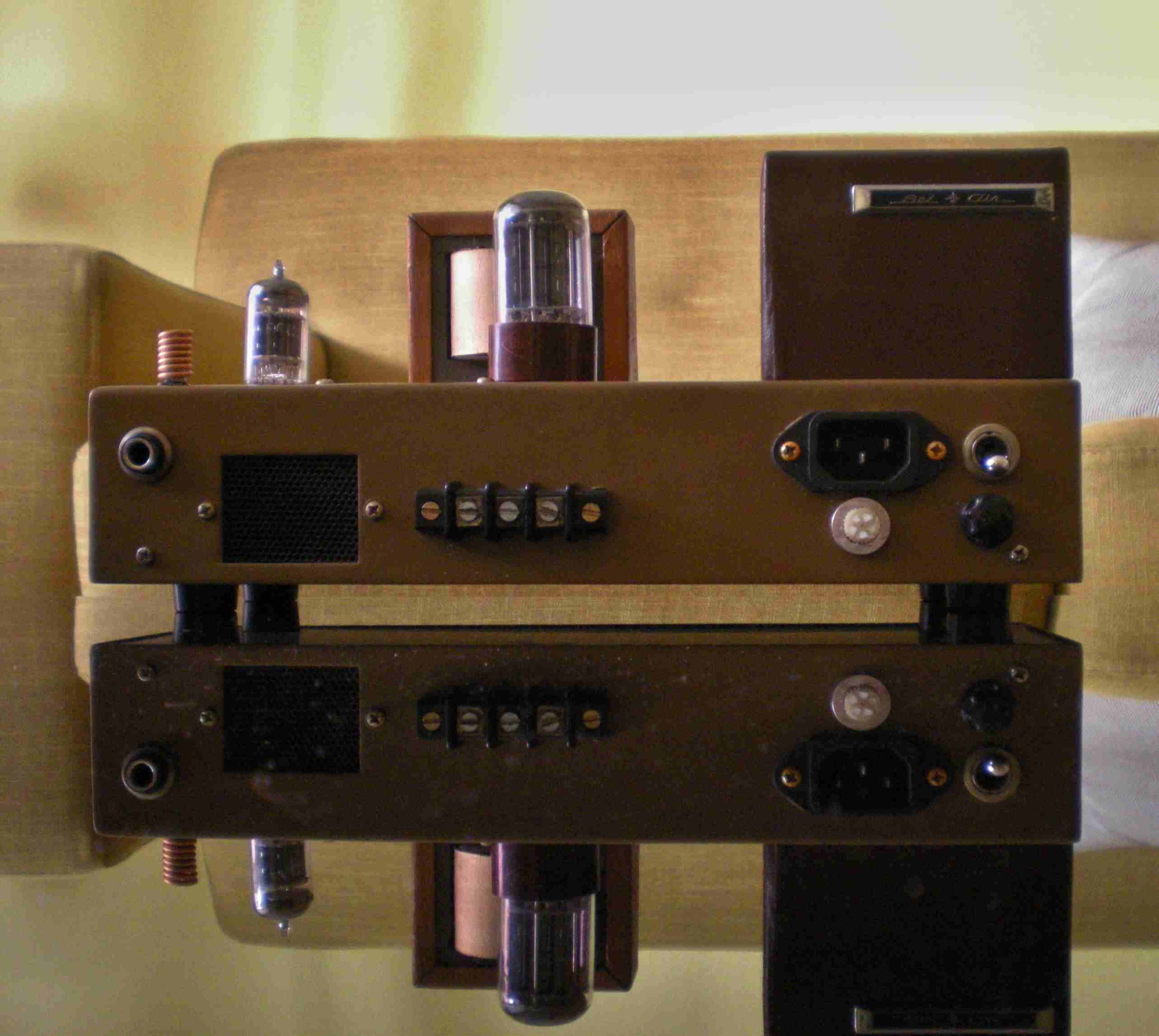

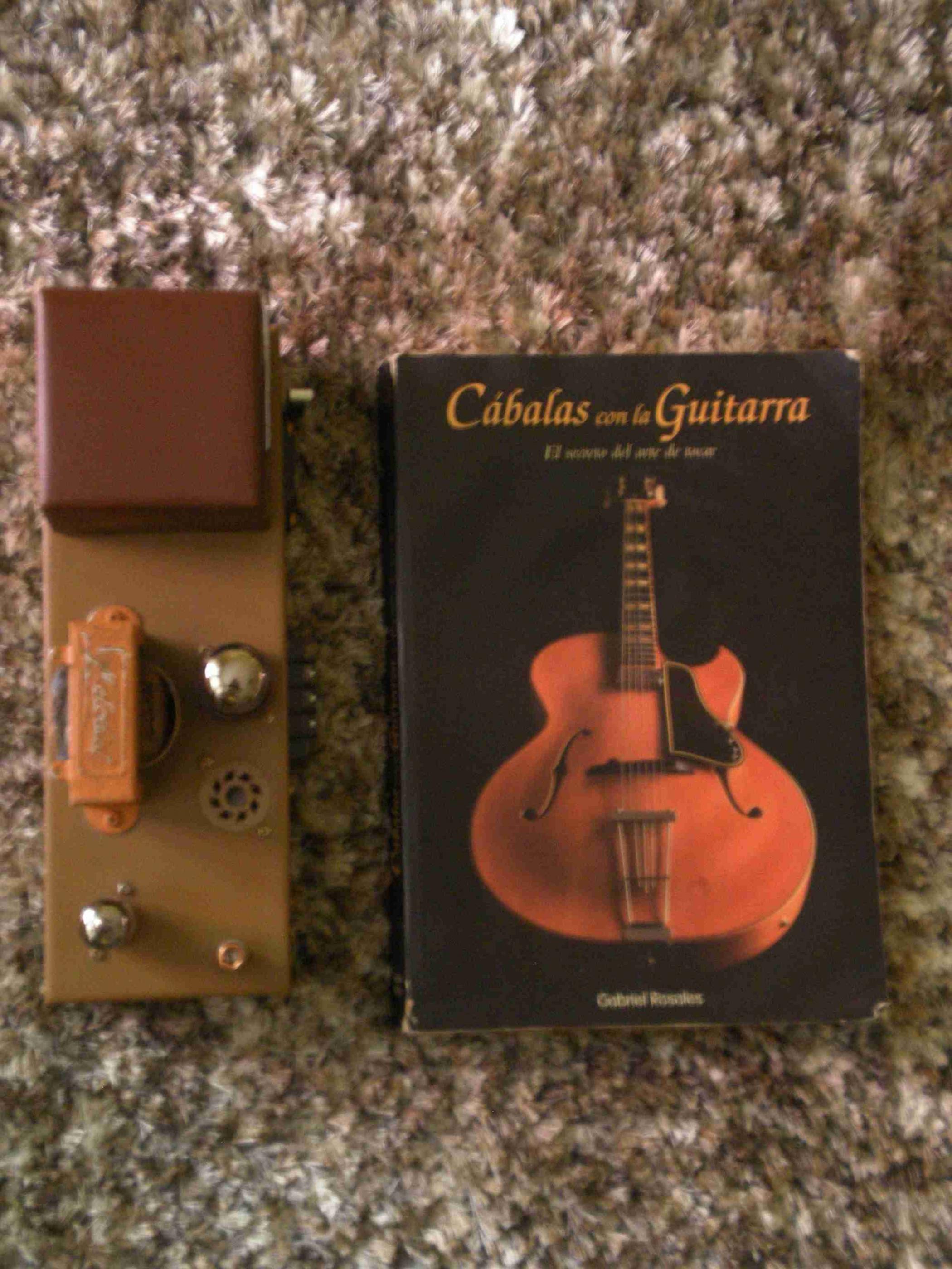

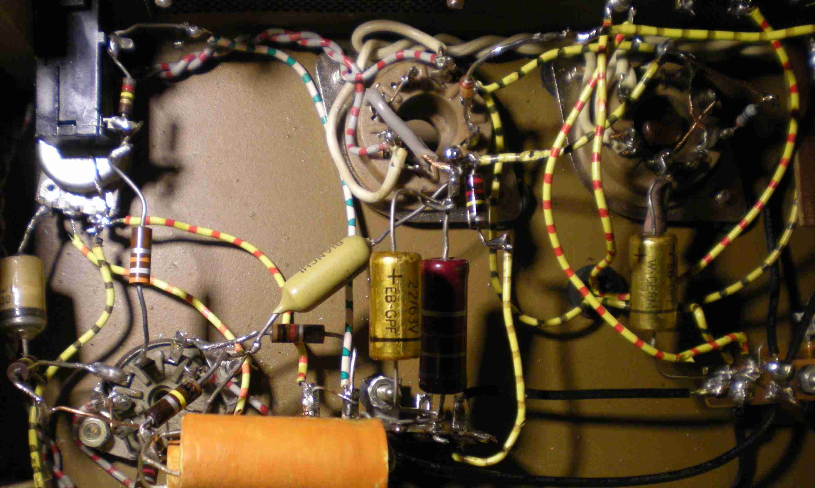

Here it is, my Champ. Best Champ of all. For some reason this one sounds better than the others.
OK, let's crunch some numbers, chassis free because it was from a SE EL34 amp that was being part of the decoration - not being played.
OT from Philips record player (also free). Power transformer 50 euros (ouch).
Resistors free - a Fisher amp donation.
Caps free, man that Ero-something coupling cap is over 40 years old and no leaks. Wish I could say the same.
Power supply caps, 6 euros.
Boy, I'm bored. Not much money, let's leave it at that.
