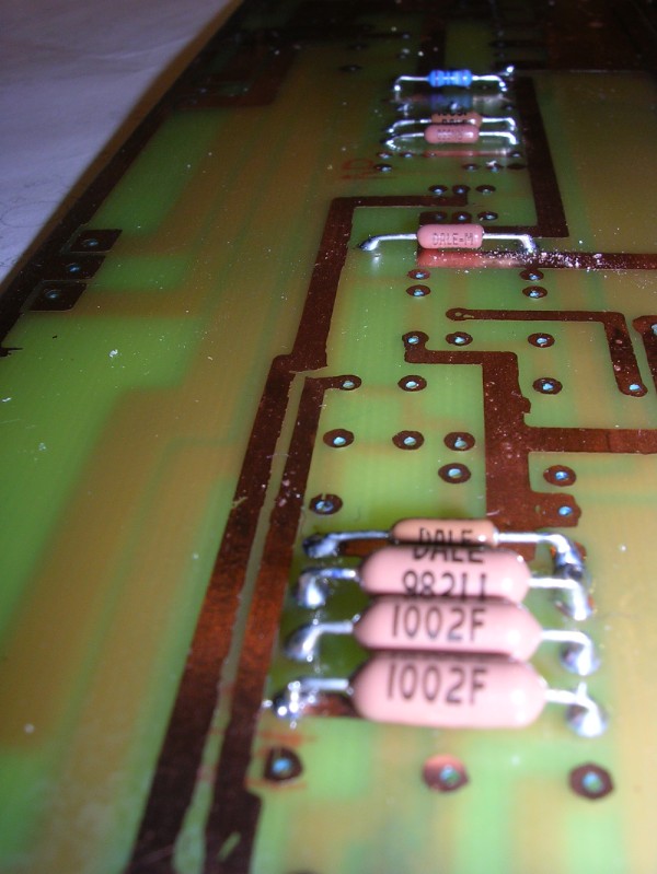

Hello all,
This is taking a lot longer than I thought...the new layout is a whole new learning curve but its starting to come along.
I should start on the other board later this week.
Ian

Ian, you're getting there my friend.
For the bigger is better crowd...0.5W resistors can fit on all 0.25W R positions.
Cant wait for the outcome, Macka.
Now show us some nice ladies again, mate.

Been using 0.6 watts for years, friend.
