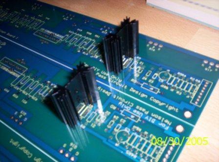

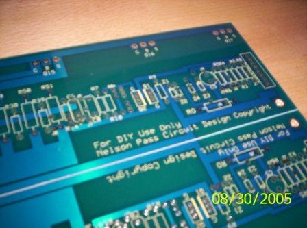

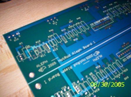

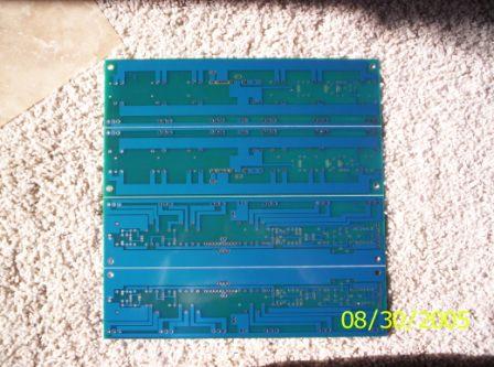

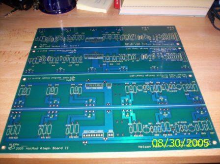

For everyone's information the HotRod Aleph boards are for Nelson Pass's Aleph series circuit design (2 stage only). The added benefits are:
1) It accomodates any of the following Aleph 2, 3, 4, 5, 30, 60, 1.2 and the X (up to 6 pairs of output devices per side of the balanced circuit) without having dangling wires to the output devices,
2) It can be configured for a regular Aleph with a 30/60 input circuit,
3) It accomodates all possible trimmer pots for adjustment of bias (front and output), DC offset, etc. Trimmer pots can be replaced with resistors once circuit is tuned.
4) Front end diff pair are oriented to use one heatsink for thermal coupling, plus more...
Here are some pictures of the boards...yeyy!! Finally did it. The horizontal lines are where the boards will be separated for 4 3"x12" boards for a complete mirror imaged stereo set.
I don't have time to organize a group buy but anyone interested can start one. Meanwhile I need to fill it up and test it somehow before ordering big...if you guys are interested.
