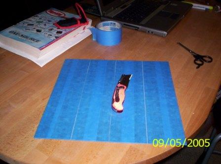

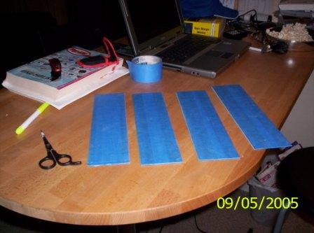

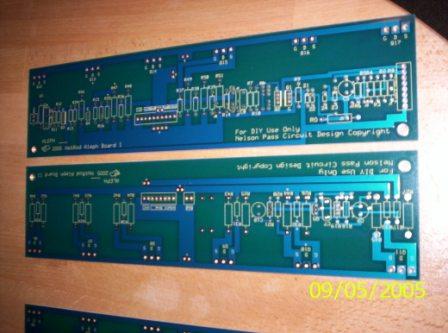

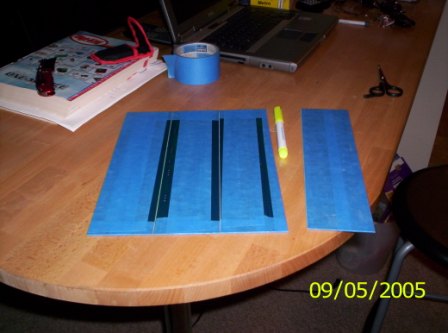

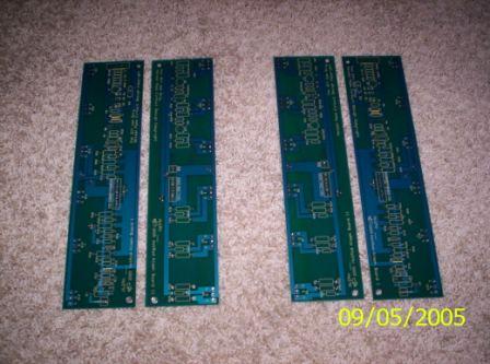

The 12"x12" board is now separated into 4 pieces of 3"x12" boards consisting of a pair for each Aleph channel. A pair consists of Boards I and II. Board I contains the Input circuit and the lower output FETs. Board II contains the Aleph CCS FETs and the string of output resistors. Here are some pics. I used a pocket blade to deepen the v-scoring which makes separation easier.
For an Aleph 3/30/4/5/small X you can mount the pair of boards of one channel in one heatsink (sized accordingly of course). You can always build monoblocks if so you choose.
For Aleph 60/2 monoblocks each board gets its own heatsink.
For Aleph 1.2/large X monoblocks the picture represents one channel😎 :hot:
