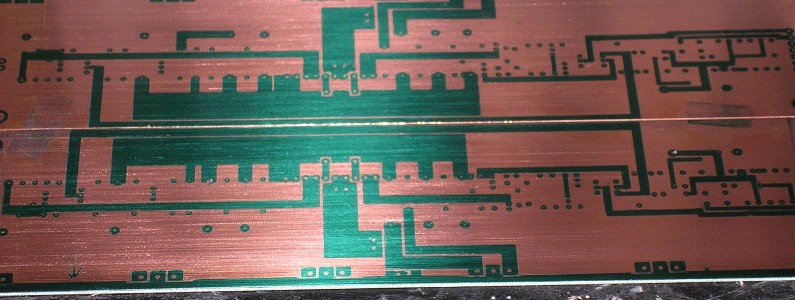

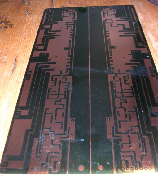

Here's the green etch of the HR1 pcbs.
macka

Ian,
That's is cool and nice! Although you seem to have run out of board space on the long edges...or is it just my eyes? That proves again the kitchen table's versatility...🙂 Ian, I salute your efforts and patience.
Allan
No Ian, that's really baaad...wickedly sick!....if you know what I mean. Filling-in every trace must have been the greatest effort in the project. I have found how to fill-it up with cross-hatch after converting the drawing to 2D in AutoCAD so if you need another run I'll send you a printout.
BTW your board does not include the traces and positions for the R's from output to S of diff pair for the Aleph X config as Grey described in his post above.
allan
Yeah,
I did it while watching season 1 of Tv series 24 Hours on DVD. I don't know how I did it b/n agent Bower and the bad guys.
Okay Allan,
If you could sent the filled layout for the HR2 pcb it would save the eyes....LOL.
cheers
Ian
