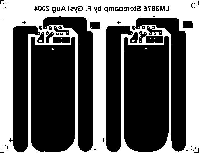

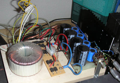

About one year ago, I experimented with brute force: a breadboard LM3875 amp with big caps (some experiments with more than 40mF overall). In the beginning, it was a noninverting, in the meantime a t-net inverting circuit without input poti, just powerstage.
This configuration was still available (working at my PC). Very simple setup (stereo):
- 4 x 10000uF Jamicon
- 4 x 2200uf Philips
- 4 x 1uF MKT*
- 4 x 0.1uF MKT*
and nearby the chips no electrolytics, just 4 x 0.1uF MKT.
I just replaced the caps marked with an asteriks by four snubbers, 1R/0.1uF.
As you can imagine: the result is really great, a really big difference, despite of the missing caps nearby the chips.
Of course, I will insert some.
Carlos: do you "snubberize" the 0.1uF caps nearby the pins of the chip?
Franz

If I understand correctly from your pic, you have the big caps near the chips.
You should snubberize the last big caps, and they should be as near as possible to the chips (which is not so clear), even if it means removing the 1uf MKT caps.
Oh, you may want to try the values of the latest PSU.
0.47R + 1.5nf.
0.47R + 1.5nf.

You understood the situation correctly:
The big caps are nearby the chips, but the 1uF MKT is already removed.
Followed by the snubbers and directly at the pins 0.1uF MKT's.
Yesterday evening, I attached some Silmic cap's 220uF just 2mm before the pins, what messed up the sound completely.
I will try your latest snubber values soon.
While experimenting, I realized that this experimental pcb I made a year before is very usefull for a very simple and small snubberized stereoamp. Just add 8 diodes in front of the circuit, the caps are all sitting very nearby the chip.
Regards
Franz

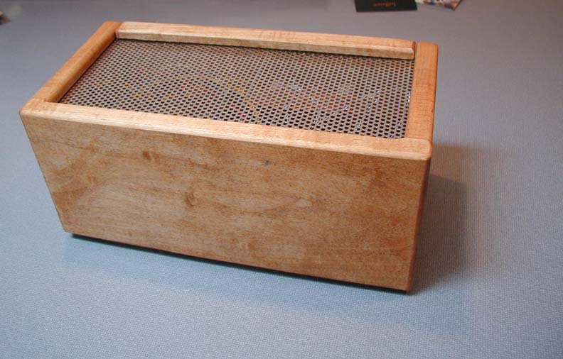

I finally got around to building my gainclone and followed a lot of the suggestions from this thread on power supply design. Nothing too original here but I thought I'd share another example.
Power transformer was a 225VA Plitron 18V + 18v that I picked up relatively cheap on the surplus market a few years back. I built the standard NIGC based on the BrianGT kit and then added the snubber power supply. A lot of this was based on what parts I had available in my work room so it does take off from the original suggestions. After the rectifiers I use 4700uf - 2ohm resistor - 20000uf (2 10Kuf caps).
Across the 20Kuf caps I placed 0.22uf polypro caps (wima) and a 0.5ohm/1.5nf snubber. Across the pins of the LM3875 chip I placed a 0.47uf cap. The BrianGT boards had 1500uf caps and I placed 0.1uf caps across these and 0.5ohm/47nf snubbers.
I added all the bypass caps in stages and can report that the sound kept getting better as I added every component and only the full complement gave what I consider excellent sound. I experimented with output resistors (0.22ohms) or output inductors and preferred the sound without either. Right now I'd say that this is a truly excellent amp and compares very favorably to some very good amps. I took it over to a friends house and listened to some Fertin full range drivers and we felt it stood up very well to some nice single ended tube amps.
I built the amp in a homebrew box out of solid 3/4" maple and used a block of copper as the heat sink and a small piece of copper clad PC board as a shield between the transformer and the amp components. Dimensions of the amp are 12.5" (wide) x 6.5" (deep) x 6" (tall).
---Gary
