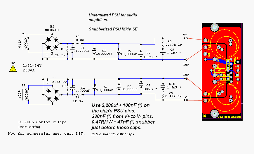

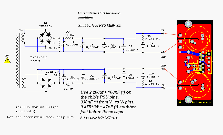

hello Nuuk thanks for your reply
i understand a lot better now about the voltage on the cap in regards to the psu dc output. since i only know the very basics of electrics. but this forum will help a lot more to understand it all
my speakers are Castle Howard s3 here`s the link
http://www.castle.uk.com/pages/classic_howard.htm
my current amp is a Cyrus 7 with a PSX-R witch is a about 70w RMS
so if i can make any GC sound as good Cyrus 7 with all the help on the forum . I`am listening to my GC now and getting better each day goes by plus it`s ony a few days old and fully burn in yet
I`ve looked at carlosfm design and thought this mite be better.
since the GC amp PCB has two grounds - & +
Plus the first time i put a transformer with only 3 wires for the out put on the rectifier pcb the transformer buzzzzzz very loud .
So i did open heart surgery on the transformer and separated the two output coils. And added a four wire so i go two output coils and all works wel without a very loud buzz from the tranformer.
I hope carlosfm don`t mind me changing his design a bit without his permission on this pic than i`ve added .
If you do carlosfm i will not do it again sorry
many thanks Scooby300
NEW!!!! pic becuse one of the rectifiers was the wrong way around plus i`ve only got one transformer with two outputs
