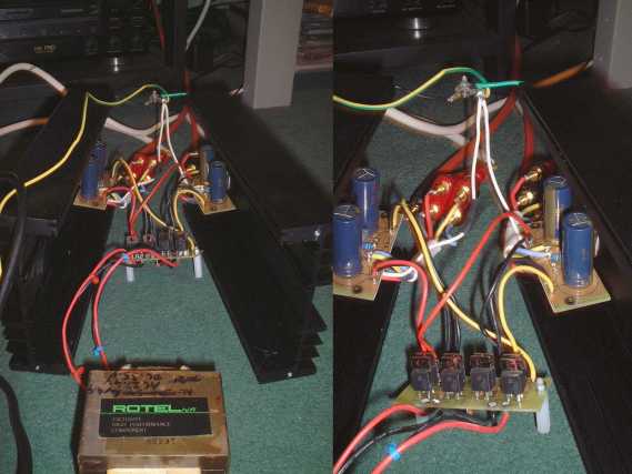

hi carlosfm
i am new to this forum and just built my first GC from a LM3875 Amplifier Kit that i bought of the net it sounds ok. Will this psu design make sound any better than the one that came with the kit. And is the LM4780 Amplifier Kit any better than the LM3875 kit.
The transfromer is a old rotel one out of a dead amp. ac out is 27.4v @4 amps dc out is 35.9v @? amps it goes to high for my multimetre to read it . i`ve added a pic of my GC amp
it mite be bit a silly question but what are voltages are the caps on your design or does depend on the psu from the transformer voltage output

hi carlosfm
