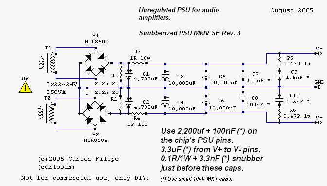

SheldonD said:
....If you consider these 30 volt rails are feeding a 60 watt
amplifier then 1 Amp is on both rails.
This would require 1 watt= 1 ampx1ampx 1R...
You are wrong, sorry.
If P=60W
and Z=8ohms
then
I= 2,74A
P(R3)=R3*I*I=7,5W!!!!!
With 3W resistors, the PS is limited to 1.7A continous
which translates into 23W at 8 ohms and 12W at 4 ohms from amp(s), under ideal conditions.

moamps said:
CarlosFM,
The number and overall capacitance of elcos in your PS doesn't change power consumption from the mains. Otherwise, you would have perpetuum mobile.
Milan
I know, I didn't say that. 😀
Although it works fine and runs cool, is it really necessary to change the schematic for 10W resistors?😱
Ok, I'll do it, just for peace of mind, and this way one PSU can feed more chips.
I'll also put 1W resistors for the snubbers, as it's what I've been using lately.
Hold on...
Here it is.
I hope everyone is happy now. 😀

Carlos,
Just curious, pertaining to my post on the LM338 regulated thread about a multi-amped system, you reccomended a unregged PSU. Having read this thread (and feeling the wrath of 50 pages of information overload), I was wondering how component values would scale as the traffo's VA was increased. I think I have a few ideas, but I'm very very new to the scene and would really like to hear your opinions about it. As far as I can see, you would only need to increase the supply caps (and possibly power dissipation in resistors), but I don't feel I have a solid grasp on what would be their actual values.
Sorry for the Qs, but I don't really have spare parts to work with, so I'd like to get a design well-laid out before I start ordering and demolish my next paycheck. Thanks.
MikeLewis said:
Carlos,
This PSU can cope with 3 chips, as I suggested you.
30,000~40,000uf capacitance after the series resistors is what I would use.
For the trafos, 400VA is fine.
peranders said:
Carlos, if your design goal is continuous output power at max, you should also use appropiate resistor values and if those are chosen for music then lower values are OK.
That's what I did.
But I'm open to suggestions and ok, 10W series resistors it is.
It should handle 4 chips without any problem.
This is for a class B amp, and music has peaks, it's not a continuous tone.
Anyway, it's important to point out that the MUR860 diodes are fine for a couple of chips, but more than that one should use bigger diodes.
