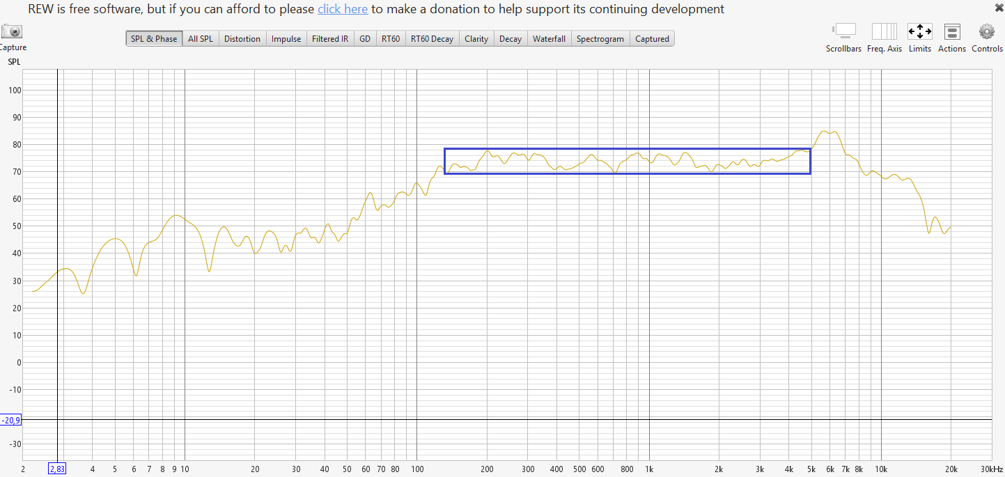

Hi!
OK, I'll check that as well as the impulse response sugested. I need to purchase a full range for comparison.
You mean most consumer loudspeakers have phase shifts between 200Hz and 5kHz.
Most consumer speakers are 2-way.
But In our 3-way DIY loudspeakers, 200Hz to 5kHz can be covered by a single speaker, the mid bass, mid range or even a 5" full range.
The mid bass I use (5") covers from 150Hz to 5kHz. See actual raw measurements below before the crossover.
And if isn't enough, I can select another speaker to cover with more margin (a bit lower than 150Hz and a bit higher than 5kHz)
In this case, there wouldn't be relevant electrical phase shift in this range.
I'm not trying to be picky here, but I just want to understand exactly what people like in full range single speaker that my 3-way cannot deliver.
I'm really not trying to say one is better than the other as it might look. I'm just showing data to be criticized and know what is wrong in my system that is correct in a single speaker.

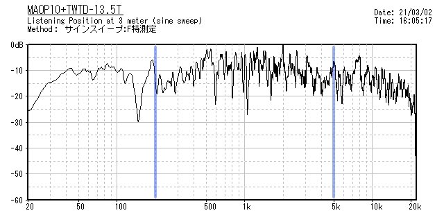

Hi Freedom666.
It sounds good if 200Hz-5kHz is flat.
But it is impossible to make 200Hz-5kHz flat at my listening point, so I don't care.

@nandappe
Only the loudspeaker should be linear (at least in this region) not the room. Fullrange loudspeakers can be measured as a point source in the nearfield (20cm), multi ways are much more difficult to measure.
Classically for the room there is acoustic room treatment.
There is theory on that. Measuring in the far field means doing a lot of (unnecessary) correction work often worsening the sound. Filters to the loudspeaker should be only applied where necessary.
After setting dsp filters I listen to each filter with recorded instruments playing these instruments live simultaneously. Like this you can be sure you get a 100% identical tonality between recording and live event.
Every filter is checked if its bandwidth and amplitude is correct and makes the sound better.

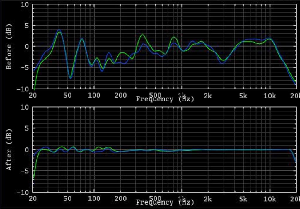

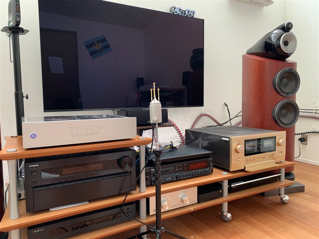

Hi Freedom666.
My audio friend used B&W 802 D3 with TRINNOV AUDIO ST2-HIFI to flatten it, but now he is adjusting it to his liking.
He said, "Just because it's flat doesn't mean it sounds good."
I guess it all comes down to personal preference.

Wow, that is quite a difference! I guess if you flatten the frequency response you release the demons of phase and distortion. Compression and power response can be affected too. Obviously flat frequency response is only one of the goals of a loudspeaker designer. I've known for a while that adding gobs of power to the bass will only create equal amounts of distortion. The DSP fans don't seem to understand.
Every time you pull up (or down) an amplitude with a filter, you lead and lag the phase about that filter's frequency. So, let's say you work the filters to get that flat response above - what's the phase doing as a result? Unsure if it's possible to have one without giving up the other - classical trade-off situation.
One time I bought a fancy Yamaha pre-amp, with a broken tone control. "Easy fix" I thought. Turns out the resistor film was deposited on a glass substrate, which was cracked. On further analysis they really went out of their way to ensure the signal passed through directly on the "flat" detent. I assume they wanted phase shift only when boost or cut was dialed in. The cheaper way is to use a switch, take the whole circuit out of the signal path.
The ubiquitous "graphic eq" - in everyone's RCA signal path, right? I wonder what that does to phase with all the controls set flat, assuming an ordinary op-amp based design and not the particular Yamaha circuit on every slider.
That:s why I prefer to "flatten" the fullrange speaker acoustically, as much as possible. For example, I prefer to get more bass via better enclosure and not EQ.
Then some peaks higher up can sometimes be remedied by coating the driver, phase plugs etc. Lastly, a bit of toe-in can help.
Also, a transconductance amp can improve the response of a "normally peaky" fullrange.
If all of that doesn't suffice, the loudspeaker is not good enough. As a last resort, I could apply a bit of a passive notch (but I'd rather avoid it).

Maybe Trinnov has some sophisticated approach like multiple farfield measurements averaged. However they have target curves and its not easy to find out what sounds good in your room depending on room and loudspeaker (and its dispersion properties).
In theory only the loudspeaker should be perfect and the room treated seperately with classical room tuning.
Bass and highs can be adjusted to taste due to room damping properties.
But the important 200hz to 5khz region should really be linear.
And here I trust most near field measurements of ideally point source fullrange drivers.
