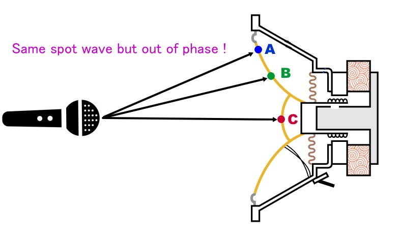

What method do you use to measure phase?
It is not possible to measure the phase of any source other than a point source.
Do not worry about the details of phase.
In addition, when moving fast, cone, spider and border don't keep their format.
See illustration on this YT video.
And speakers are made of coils, which have inductance.
Speakers installed on boxes (sealed or ported) and coupled to the air may have equivalent capacitance behavior.
All these things shift phase and different phase for each frequency - I included them as "acoustic" phase shift.

It's worse than that because full range speakers aren't purely pistonic. For example point B can be out of phase with points C and A.
Hi Arthur Jackson,
You're absolutely right.
Considering the shape and size of the diaphragm, it is impossible to adjust the physical phase.
It is meaningless to adjust the electrical phase.
I have stopped thinking about phase!

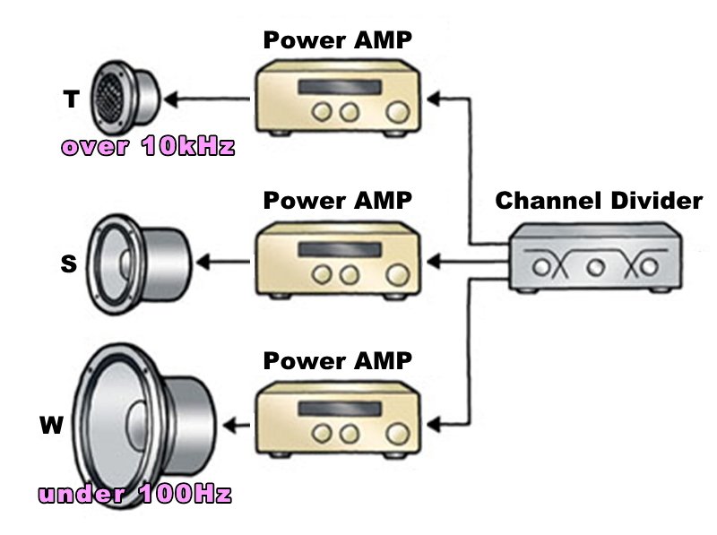

Hi picowallspeaker,
It would be good to use a full range as a midrange, a woofer below 100 Hz, and a tweeter above 10 kHz.
Reactions: Horneydude
