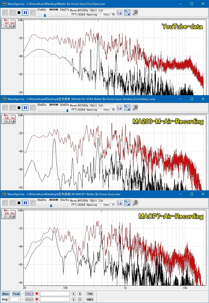

For a cappella songs, a 1.25" speaker can deliver a sufficient performance. However, for typical vocal tracks that include both low and high frequencies, it would be inadequate.
In particular, the ability to reproduce low frequencies is crucial, as it can completely change the impression of a song. For example, "Better Be Home Soon" by Andrea Zonn contains frequencies as low as 30Hz, making it difficult to play properly with a single full-range speaker.
Air-Recording
1.5"(E-Sound DXYD40N-22P-4A)
4"(MarkAudio MAOP7)
8"(MarkAudio MA200-M)
  • Thank You
Reactions: GM and Horneydude

For female vocals, a full range of 1.25” may be sufficient.
1.25" Full-Range : Dayton Audio CE32A-4 - Both Sides Now / Jeanette Lindström (recorded at 2.5 meter away)
