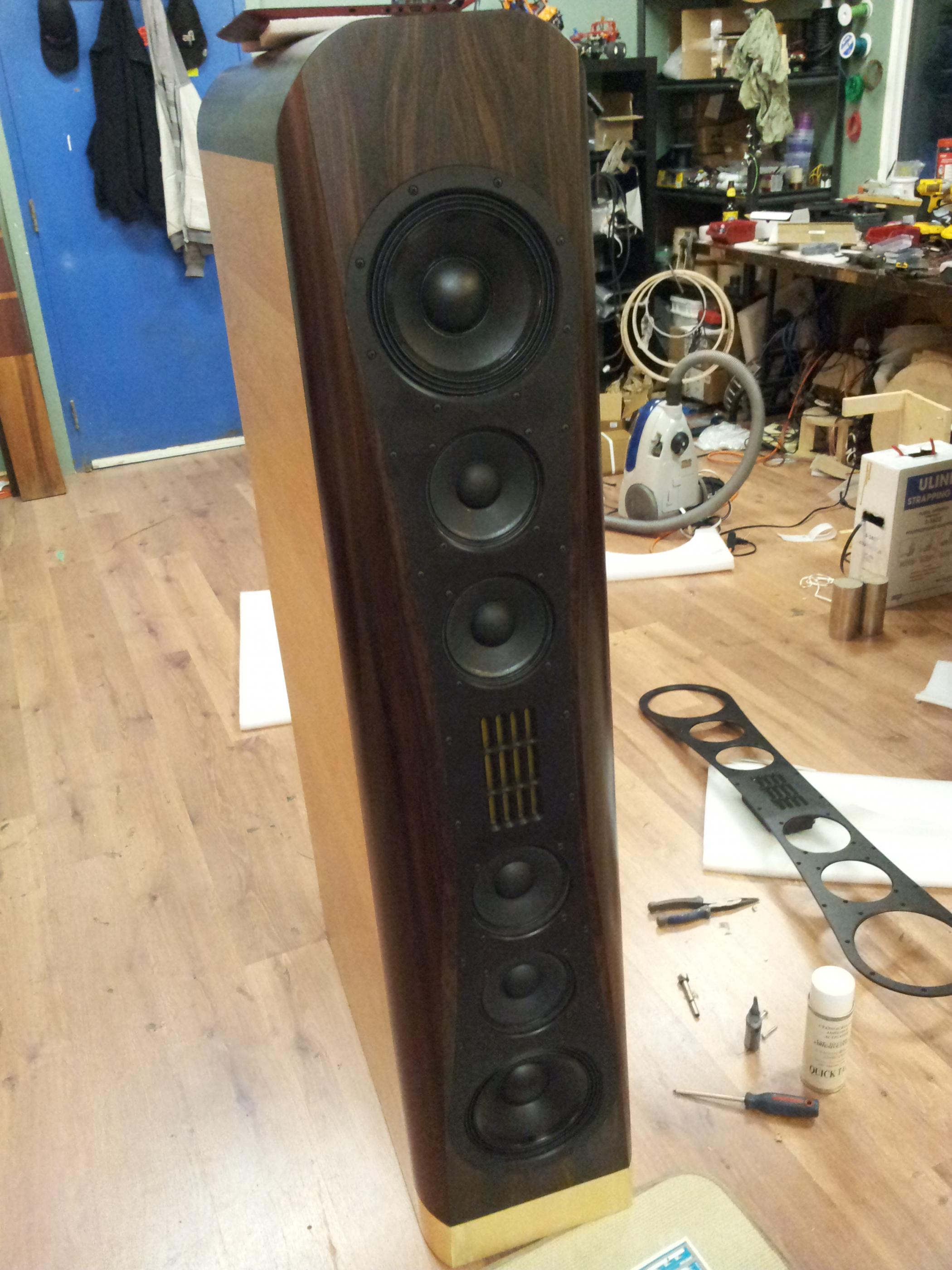

Mark, hmmm modern 4x 75mm membranes in non-traditional quarter wave loading down to 20-30Hz - impossible ... - x-o with help of DSP, very interesting
It's called a back loaded horn. I didn't take the time to actually do a lot of explaining.
And yes the F3 of this horn is indeed 30 hertz.
And the DSP is used to do a little lift of 3db.
Not to much.
Because the rear of the drivers are producing the low bass, and they are horn loaded you can actually get some pretty serious bass out if them. I have demonstrated this in other meets.
They are very capable of shaking the rafters in the community center all on their own.
As we had them set up the sub was only filling from 40 hertz on down.
The two way cabinet is very solid down to 40 hertz. A region where many speakers are already pooping out.
